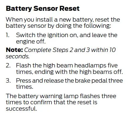

My wife's 2022 bronco sport just had this problem. The battery tested bad. Her VIN didn't pop up as one effected by the recall.
It did the auto stop and wouldn't restart without her pushing the button. A few days later it barely started pushing the button so we got it to the dealer.
And it was at 37K so no longer in the bumper to bumper warranty. It cost $300 and change for a new battery. A battery which comes with a 3 year warranty; but, the battery in it that wasn't 3 years old was out of warranty because of the mileage.
The local auto parts stores had cheaper batteries; but, said the car woudln't start if they put it in because it needs a special machine to calibrate the battery.
You'd think if they want to sell batteries they would know the reset procedure:
