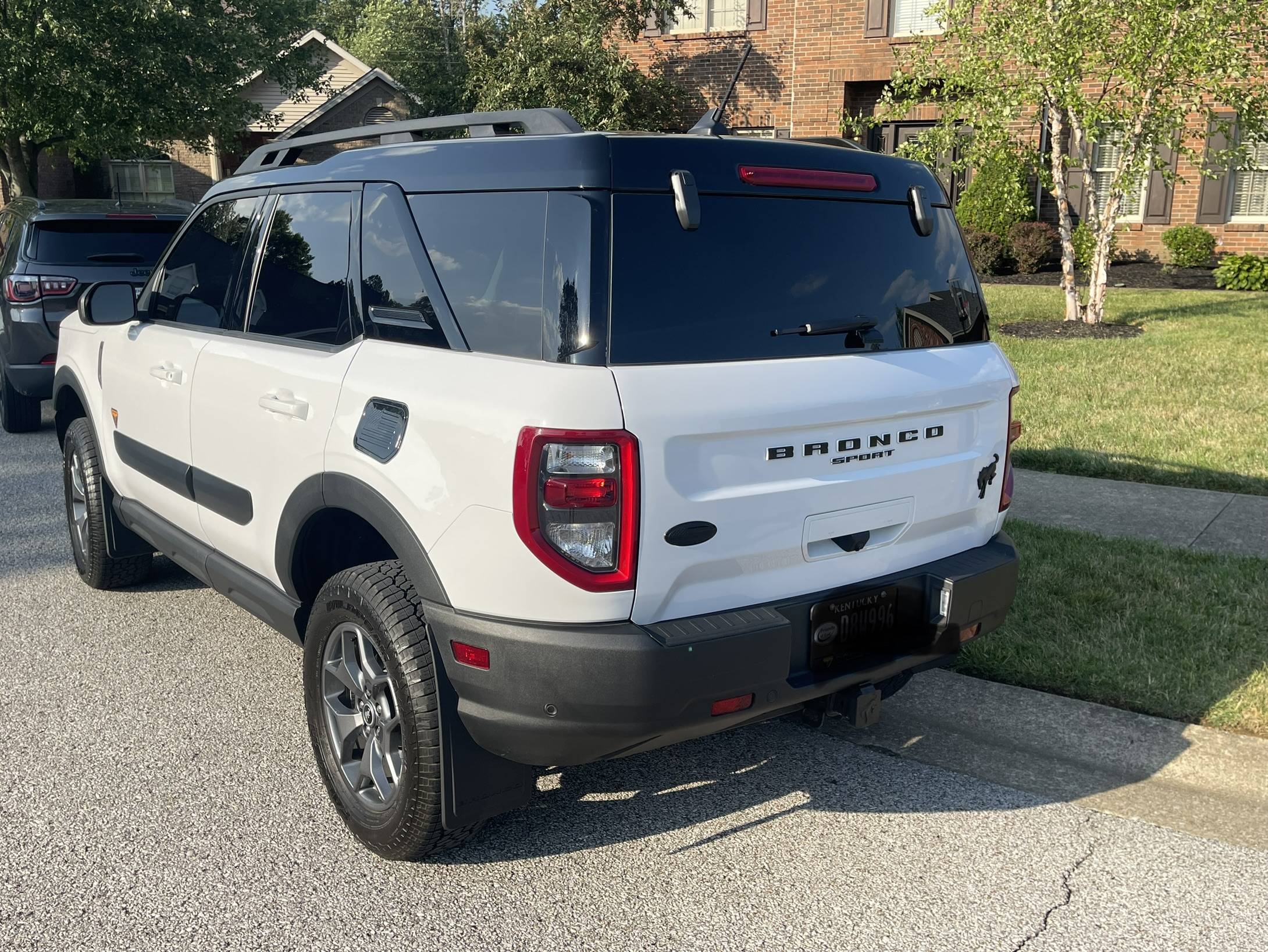

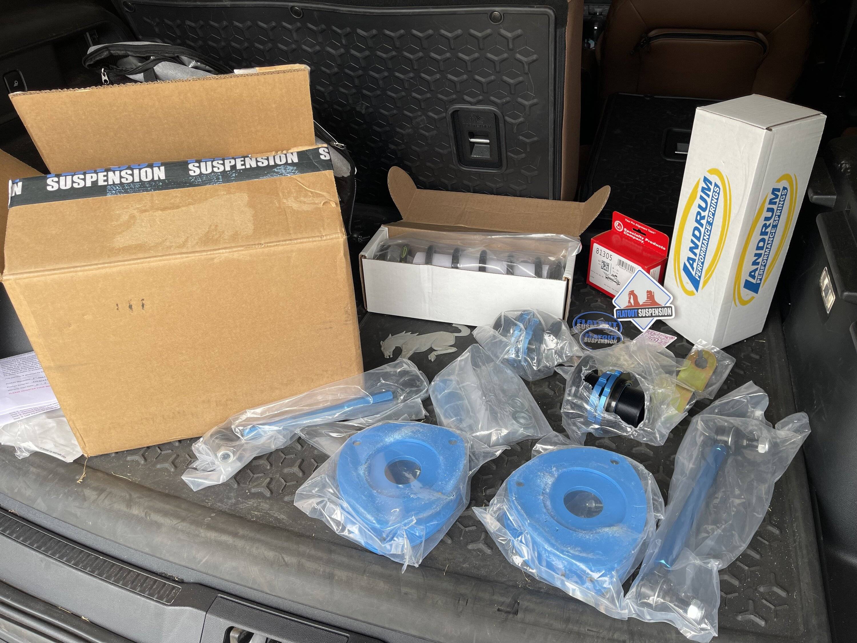

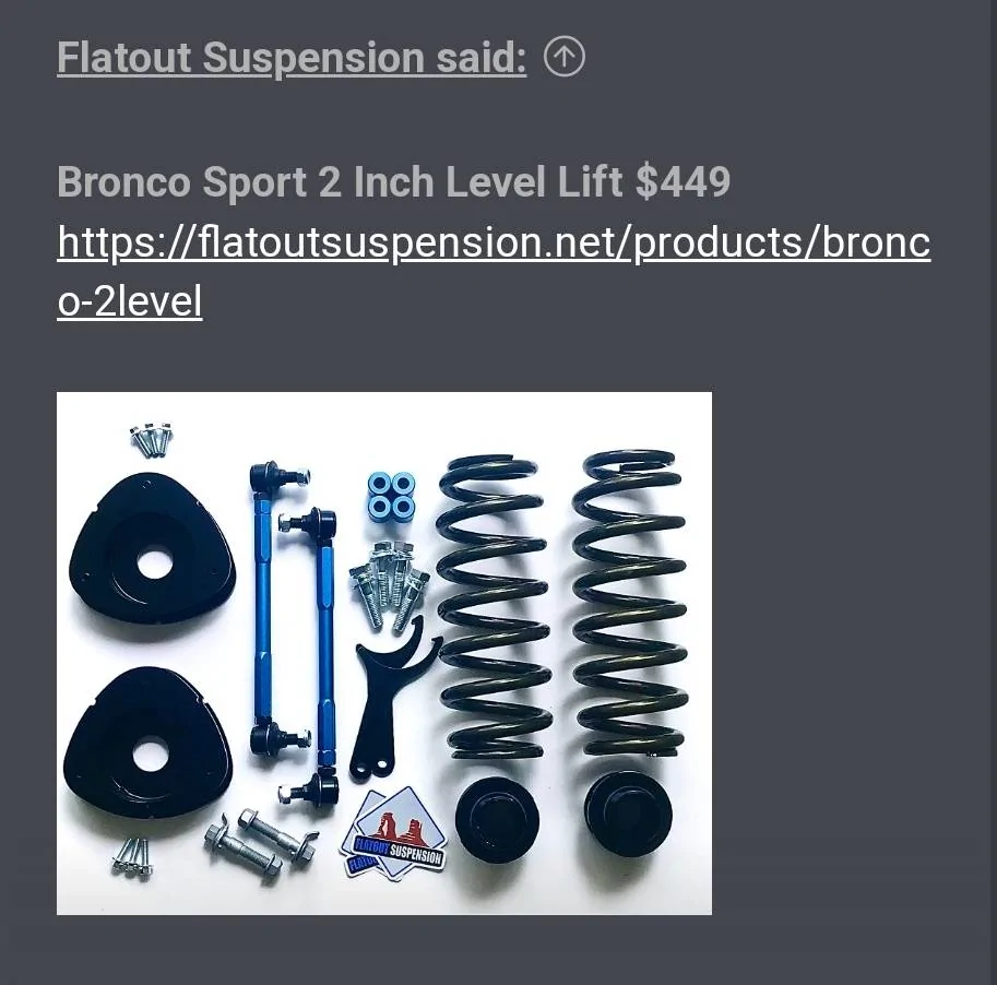

So I finally got this installed. I love it. I promised I would give the guys at Flatout a full review so here goes. First of all, they are super available by chat on their website. They answered tons of questions for me before purchase, during, and after install. Once I purchased the kit, it arrived in 2 days. This stuff is quality. They guys at my shop mentioned a few times how it just looks better and is heavier than what they normally install. Hereā€™s what you getā€¦ā€¦
Ford Bronco Sport Flatout Suspension Level Lift Full Review! IMG_2288

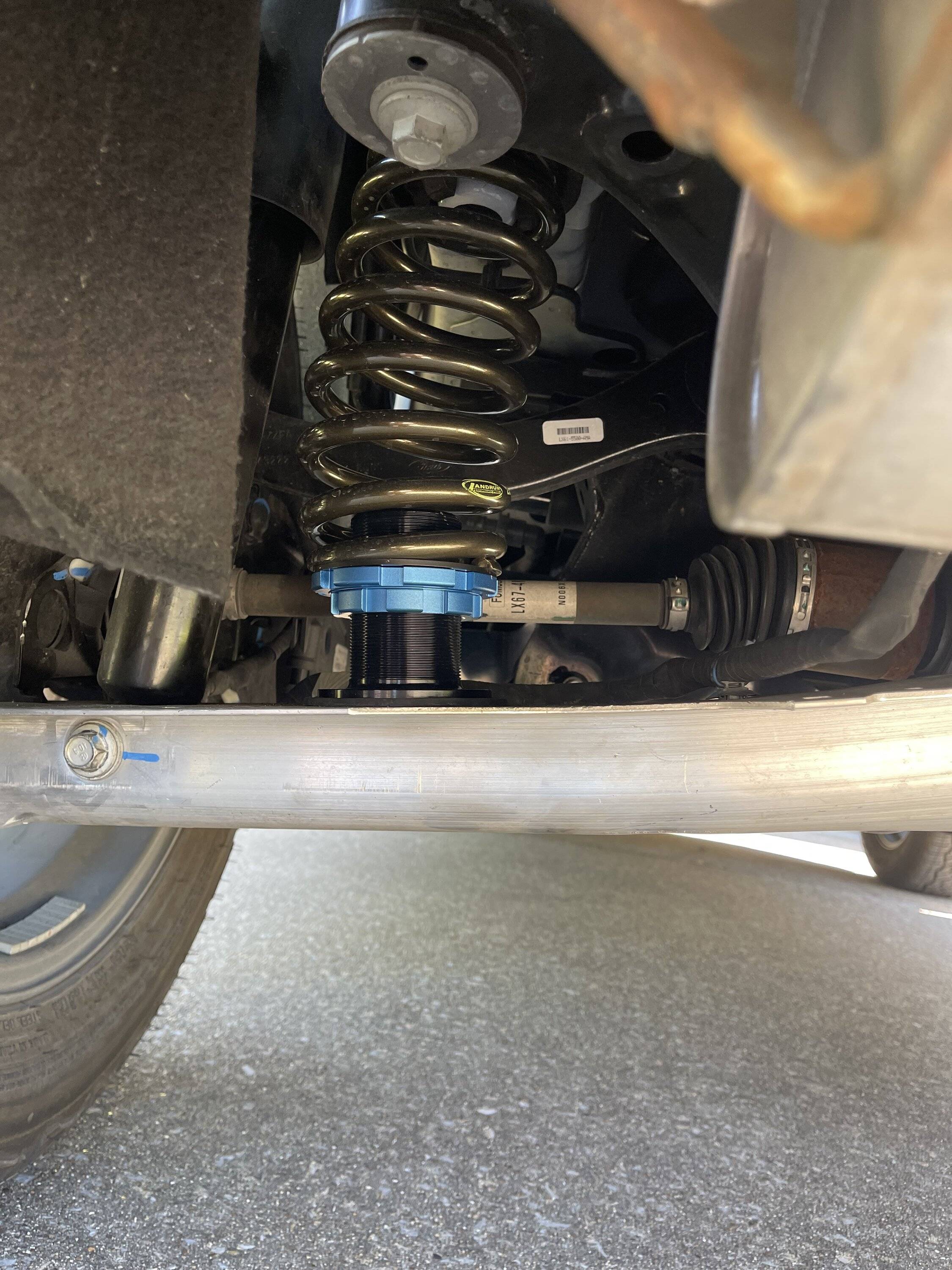

The install was super straightforward. Directions were included in the kit. My shop charged me for 3 hrs labor plus the alignment. The adjustable rear perches made it super easy to adjust. I had mine set to a half inch higher than the front to keep factory geometry. Hereā€™s what they look like installedā€¦
Ford Bronco Sport Flatout Suspension Level Lift Full Review! IMG_2494

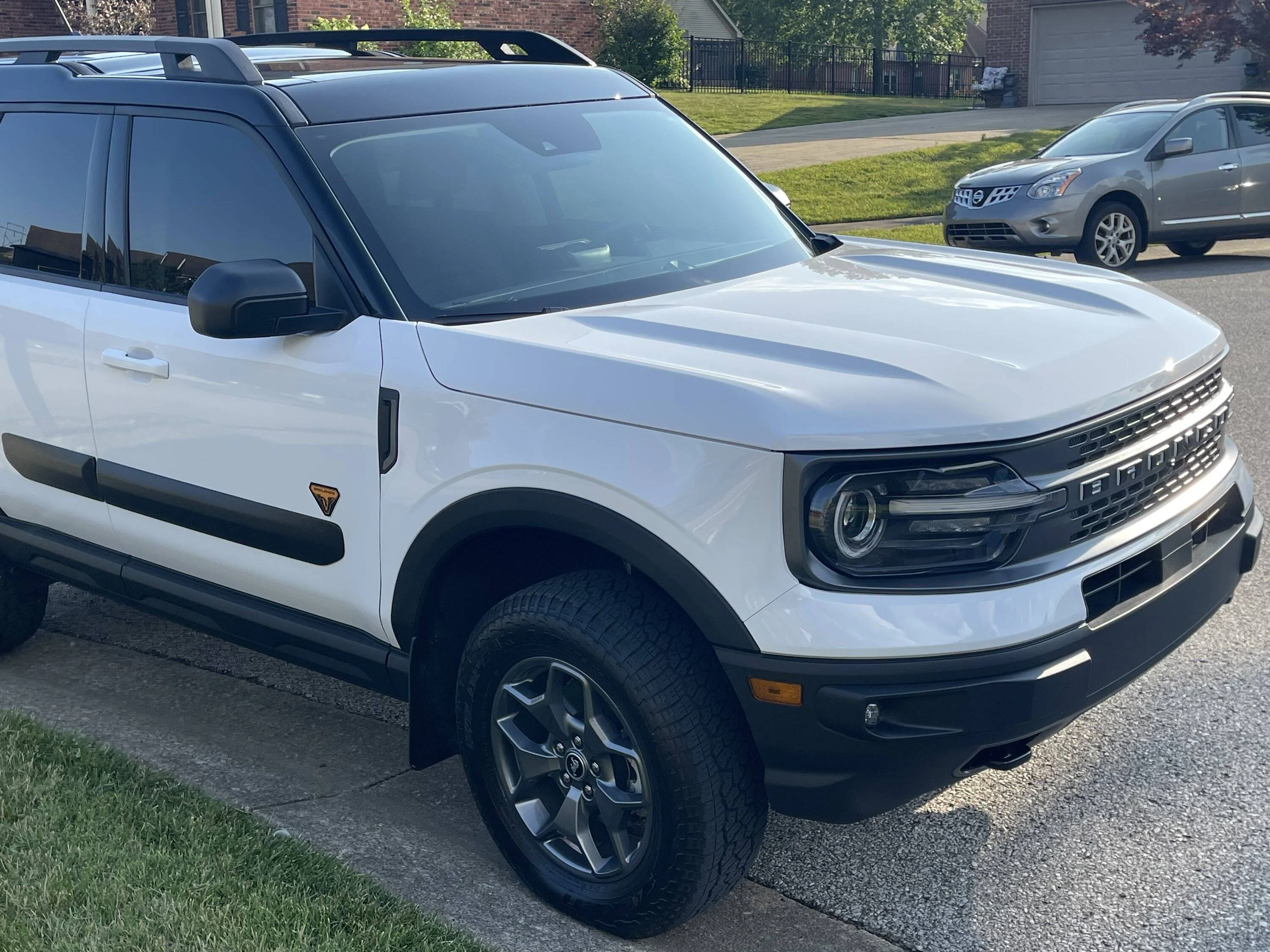

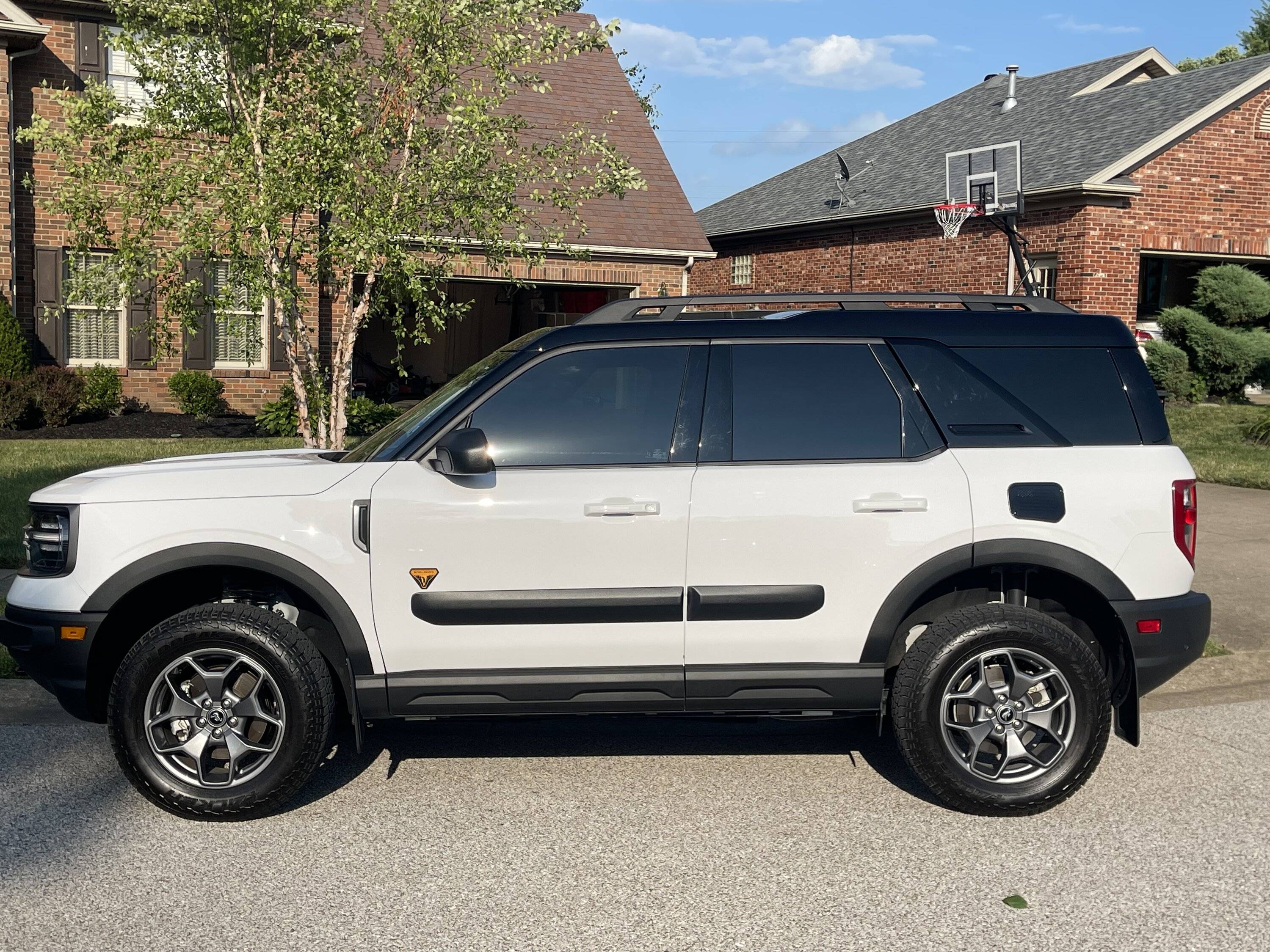

Itā€™s just a couple inches higher, but I couldnā€™t believe how different it looks. These are the Falken upgrades from Ford. Will probably eventually get bigger tires but these are fine for now. And the ride is super smooooth! Thanks to Flatout for a great experience! Hereā€™s a few pics of the finished productā€¦ā€¦
Ford Bronco Sport Flatout Suspension Level Lift Full Review! IMG_2499
Ford Bronco Sport Flatout Suspension Level Lift Full Review! IMG_2500
Ford Bronco Sport Flatout Suspension Level Lift Full Review! IMG_2498
Ford Bronco Sport Flatout Suspension Level Lift Full Review! IMG_2501

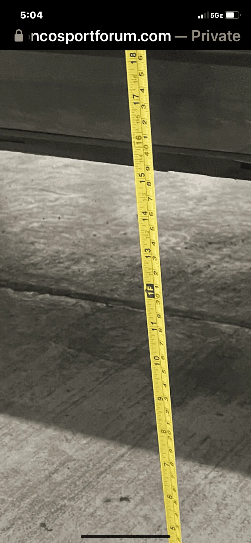

Can you do a measurement at the door joint weā€™re they meet, from the ground up to the bottom of the molding. Thanks
Ford Bronco Sport Flatout Suspension Level Lift Full Review! IMG_1048
I would be happy to but you are going to have to explain to me exactly what that means. Sorry. šŸ˜
1,325
1,288
Just looking for a ground clearance, and was interested in that point of reference for the measurements. Thanks
