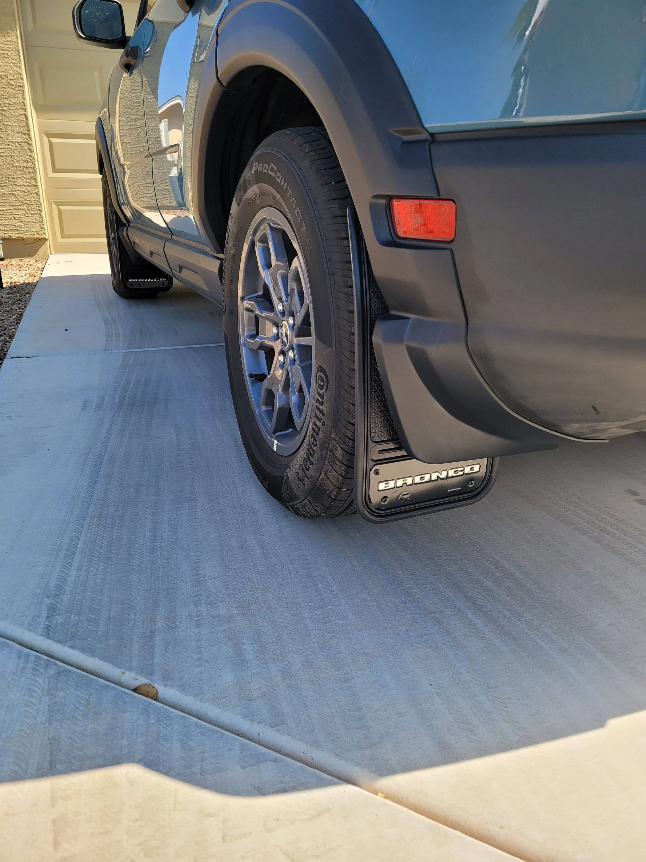

They won't interfere with any of your sensors at all. I don't believe any exist yet that aren't just glued on. Additionally, no OEM flares exist. They're all dealer installed options once your built BS arrives and none are installed at the factory. Not sure which of your options prevented you from adding flares, but the system is nitpicky about certain options going together even though they work just fine in reality. My dealer warned me I couldn't do flares and mud flaps together, but with a bit of hidden creative trimming, voila. Hope this helps.

Those mudflaps looks great! I might get a pair of these if they are still available by the time I take delivery of my BS someday.
They are so expensive!!! Glad I got my dealer to throw them into my sale for free, because I was not paying $500 for mud flaps, even if they do look fantastic. Just gonna pull them off my Big Bend and slap them onto the new Badlands.

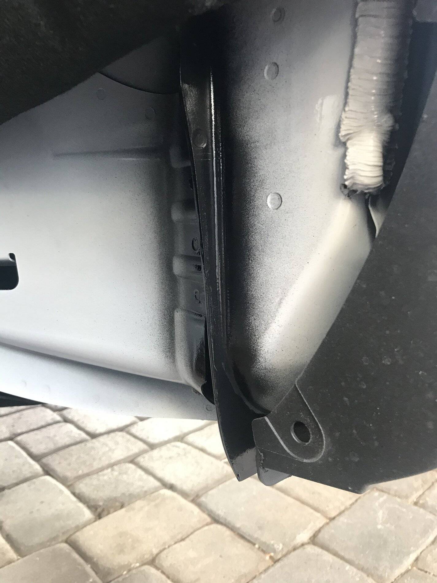

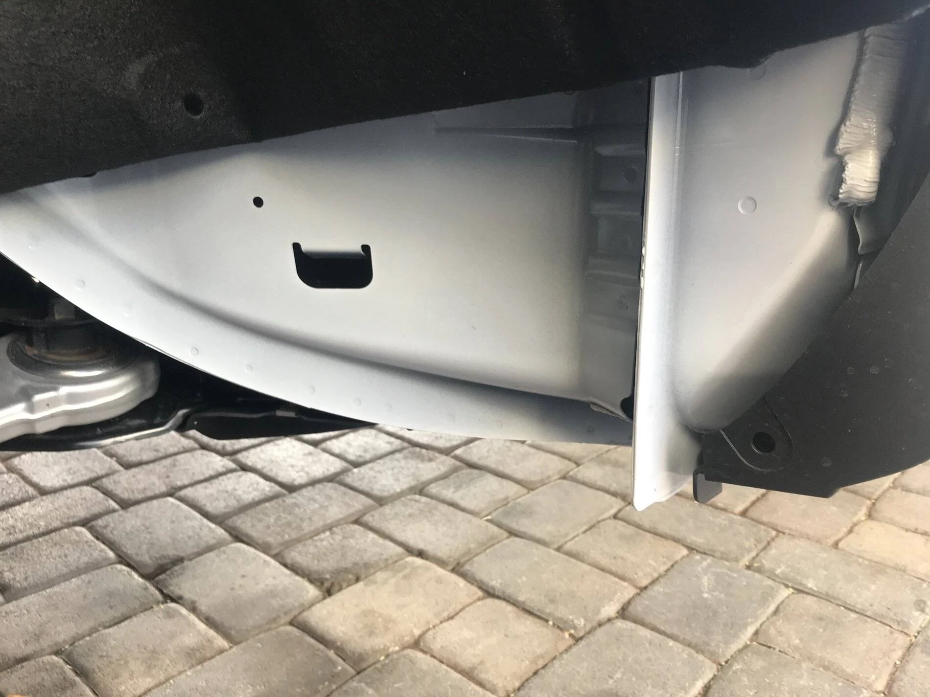

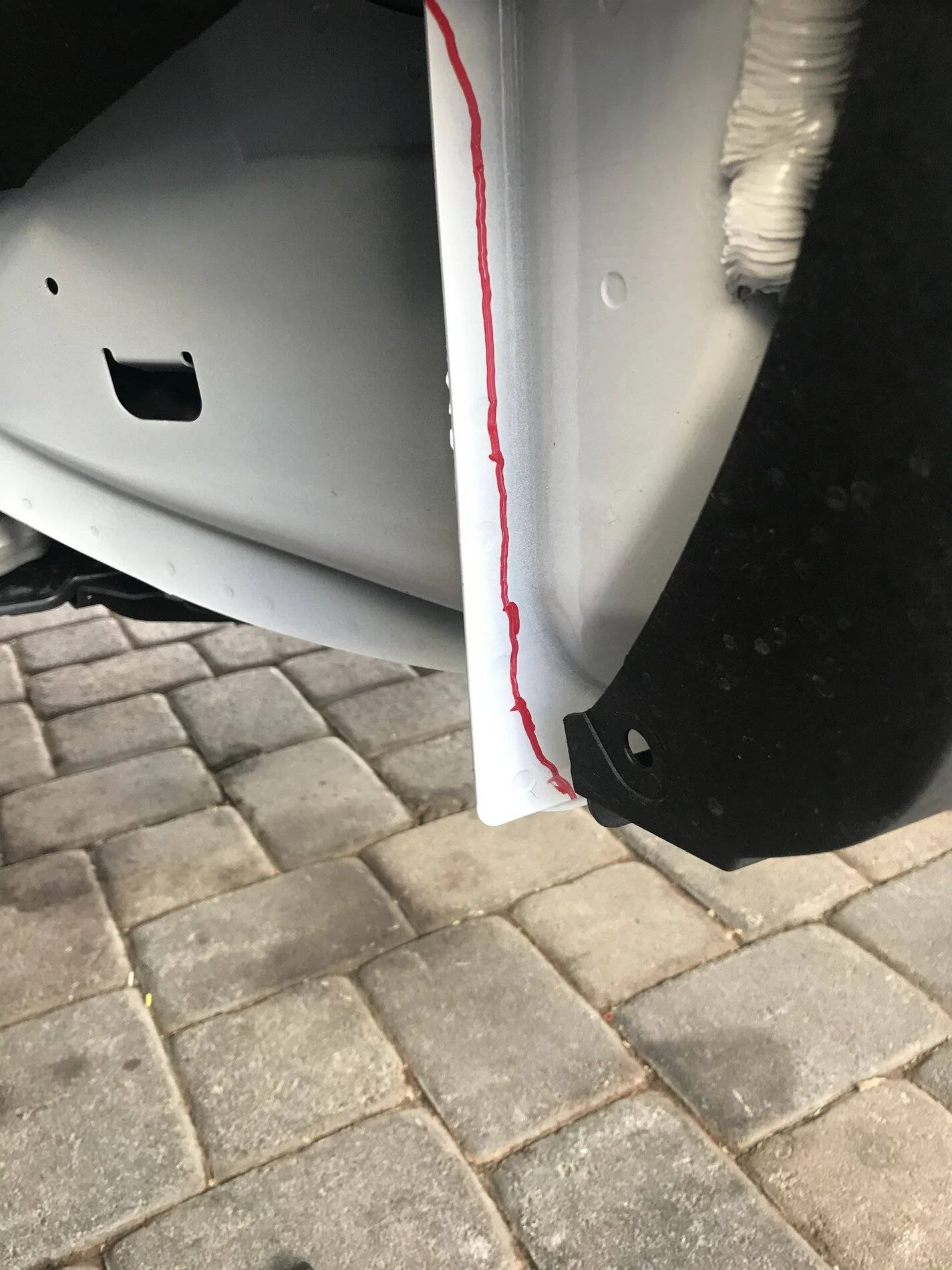

Local Ford dealer did the install and they had to grind a bit at the rear side of the front wheel wells only. Here's some pictures that Robbie Woolworth (who makes the kits) posted here showing the recommended trimming. I've had it installed for about 3 months now and so far am very happy. Wheeled it pretty hard a few times and nothings broken and no weird noises.
Ford Bronco Sport Fender Flares Bronco Sport Front Wheelwell Trim(4)
Ford Bronco Sport Fender Flares Bronco Sport Front Wheelwell Trim(3)
Ford Bronco Sport Fender Flares Bronco Sport Front Wheelwell Trim(2)
Ford Bronco Sport Fender Flares Bronco Sport Front Wheelwell Trim(1)
