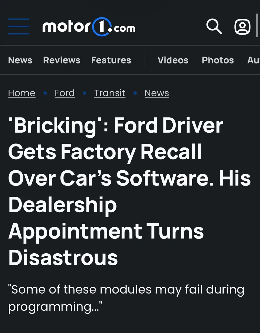

Not specific to Bronco Sports but an interesting article
it’s another reason I only have the vehicles modules updated when absolutely necessary… except for Sync updates which I will do, updating modules to latest versions is not typically a wise practice for various reasons
“The video shows what happens when Ford's proprietary programming software fails mid-update, potentially "bricking" expensive modules and leaving customers without their vehicles for extended periods”
“FDRS (Ford Diagnostic and Repair System) is Ford's proprietary cloud-based diagnostic software that technicians must use for all programming work. The system was designed as Ford's next-generation diagnostic tool for newer models, providing dealership-level diagnostic coverage.”
Article: https://www.motor1.com/news/777665/ford-software-recall-problem/

Lmao!!!!! Talk about drowning in a cup of water. Yea, FDRS is not a very good program. What FDRS says in this scenario means abosultely nothing. The APIM update is installed via a USB drive that FDRS creates......FDRS itself has nothing to do with the flashing of the actual files. They are done via USB on ethernet because writing a 6GB APIM update via FDRS with CAN would literally take 2 days or longer.
If the message on the screen says the update was successful and it is safe to remove the USB, then the update is complete and it is safe to remove the USB. If FDRS gets hung up, you force close it, reboot the laptop and when you scan the truck again, the APIM update will clear and the next one will release.
This guy waited an hour and half with FDRS stuck in a loop for nothing and made a moutain out of a mole hill.
Also, a bricked module is not the end of the world and does NOT mean it has to be replaced. 99% of the time, it can be recovered with FDRS and even FORScan (if you are able to source the files). I've done some highly unconventional things with these vehicles and have bricked IPMAs, HVACs, CMRs and more and have been able to recover them every time. Hell, I am running the CCM software from a 2024 Lightning in my 2021 F150 with no issues. All due respect to techs out there......as a dealer employee, I will not bad mouth another dealer employee and expecially not a tech as I know the hardships they go through first hand. However, this video is laughable at best, and the problem is with Ford's training (or lack thereof) and not the techs themselves. FDRS is garabge, but there are ways to work around its shortcomings.

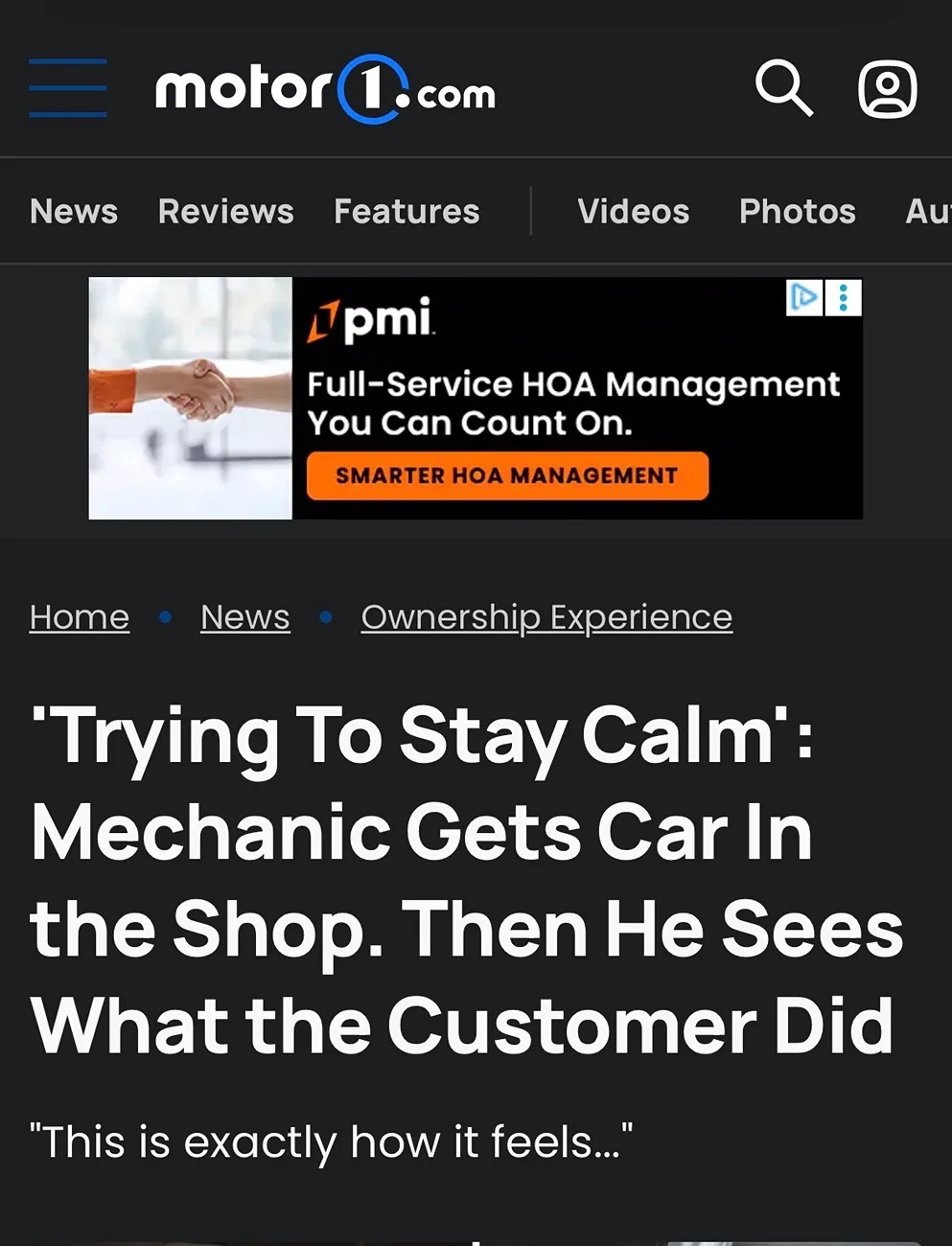

I read another motor 1 article this morning about warranty work and reduction in pay to mechanics
Do you think some of the non-needed module replacements are due to how warranty work is paid? (Easier and quicker to just order a new module so less time wasted) link to article:
https://www.motor1.com/news/777503/warranty-work-upsets-mechanic/
