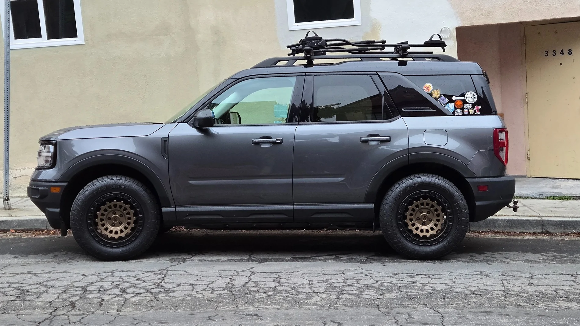

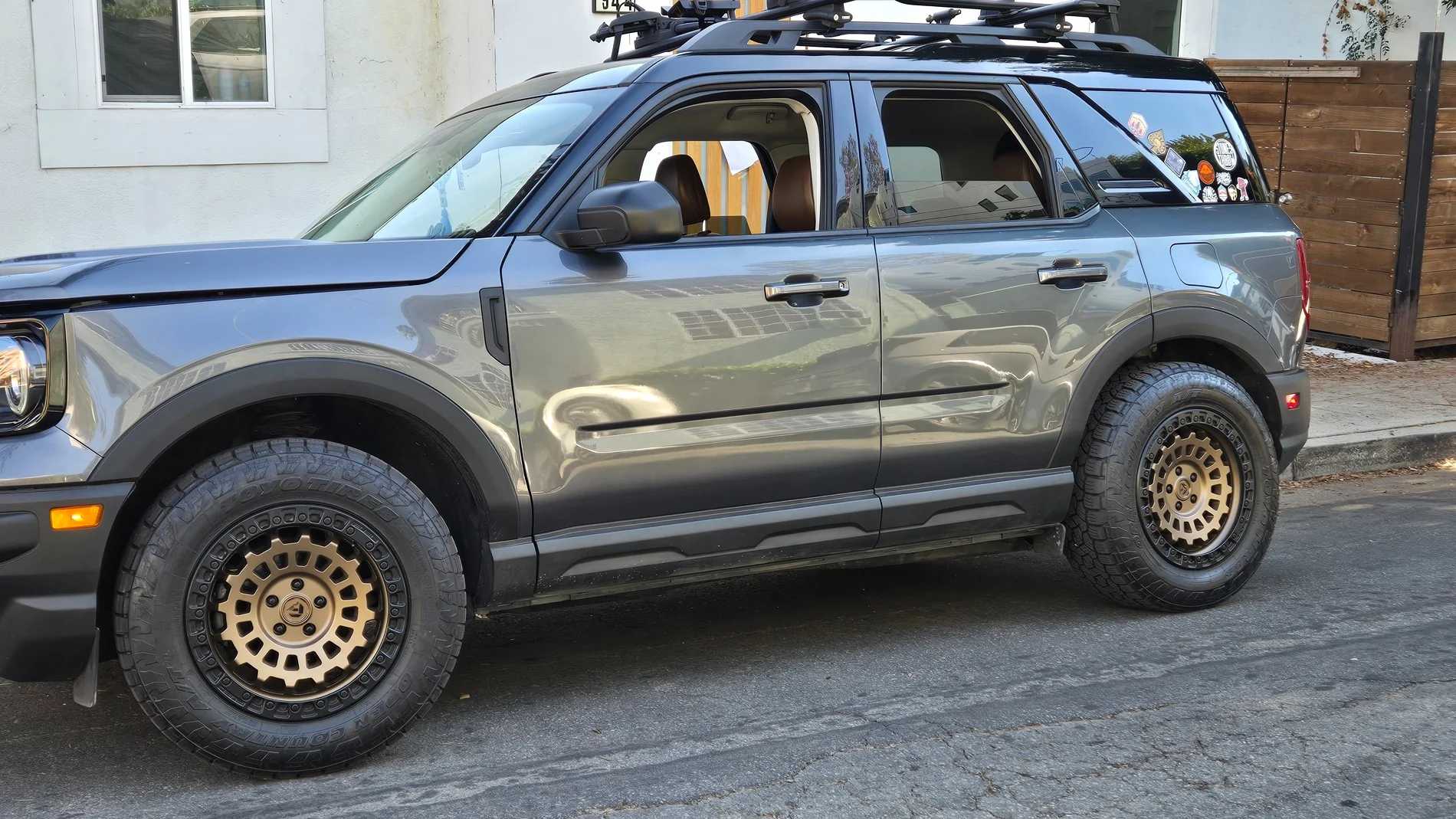

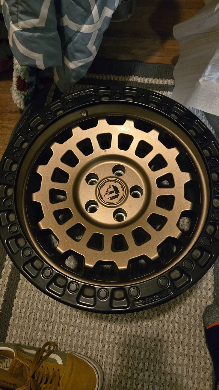

Fuel Zephyr with Toyo Open Country AT3s 245/65/17. Slight rub, but haven't heard it since new to be honest. I did install the RTR 1.30" lift kit for added clearance. Had a really hard time buying theses but I was persistent and got a set!

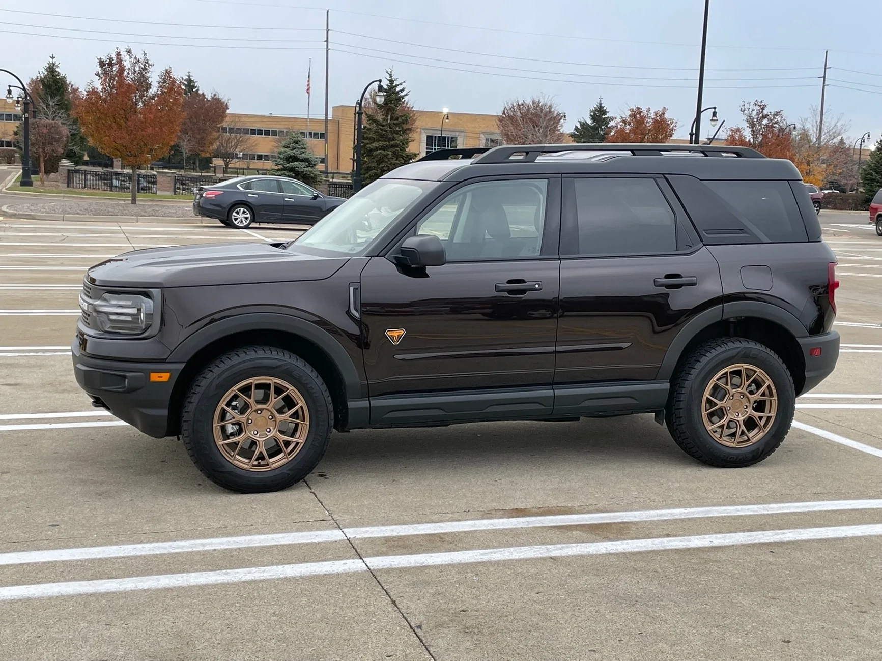

incavulator
Aug 5, 2025
266
Anyone try 17x8 wheels with 30 offset?
I have these Motegi MR147's in what I think is a 17x8" with a 38 offset. I believe the factory wheels are 17x7" with a 37.5 offset. My understanding is this will essentially split the extra 1" of width both inward and outward 1/2" in each direction (ignoring the 0.5mm difference in offset since it's so small). NOTE: Pic below of them is when they were installed on another member's BS, but you get the idea.
