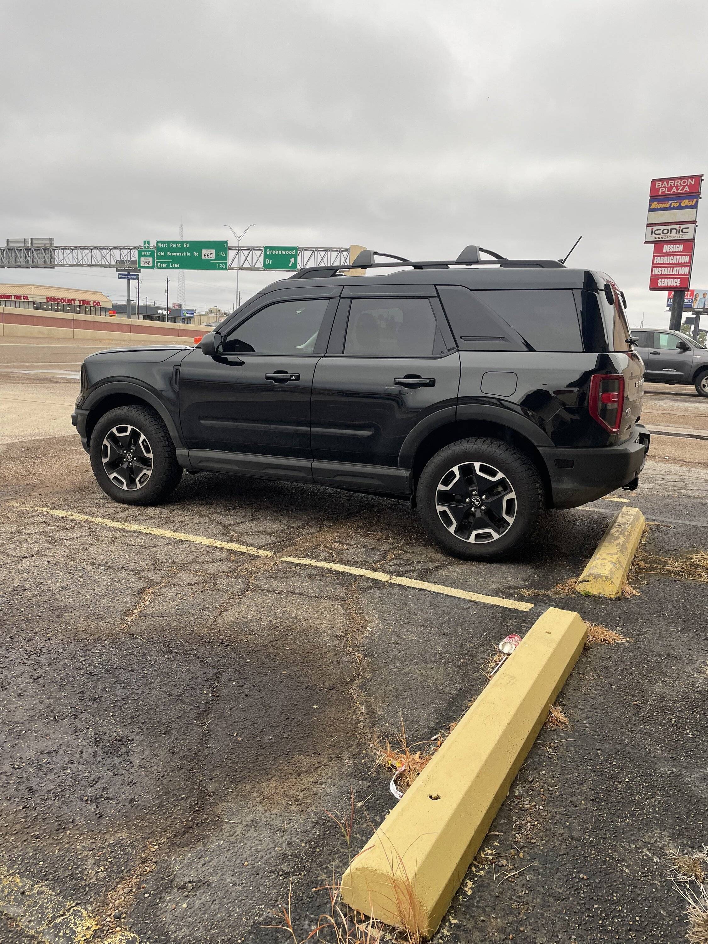

Yes as one or more stated the back glass and cargo area windows are not a true tiny but a factory haze which is in the glass. I’m also in Texas and did ceramic tint, legal on front windows and step darker on rear. 20% on rear and back if I recall. Looks darker due to haze, but still able too see through at night.

I’ve got 20% on the front to match, but I think I’m going to take them all darker so you can’t see in at all.
