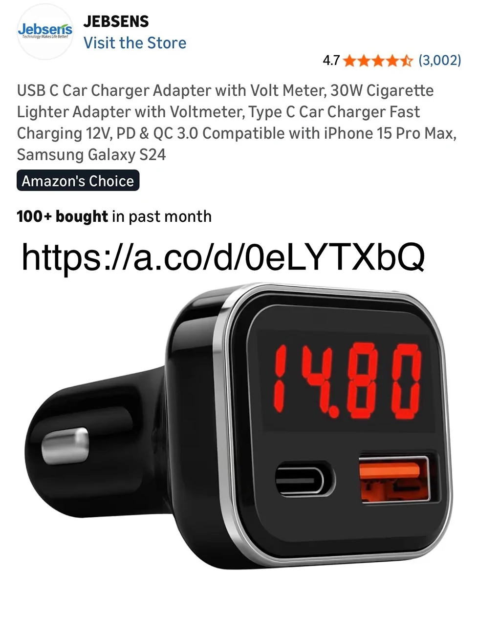

These Bronco Sports have to be driven sufficiently enough or kept on a battery maintainer weekly - needed to keep the battery sufficiently charged
EDITED: you have a 2025 which I believe displays battery voltage in the instrument cluster when configured to do so, you may not need to buy one of the devices shown below
Get yourself either of these and see what the battery voltage is when it’s being driven - let us know the typical voltage you see while driving and check the voltage drop when you shut it off after about 30 seconds to a minute

I don’t mean the battery was bad (although there are defective batteries even right out of the factory)
Mine does the same as yours in warm temps like that, no heat on, etc. I can tell the battery has a low state of charge when the ASS stops working.
