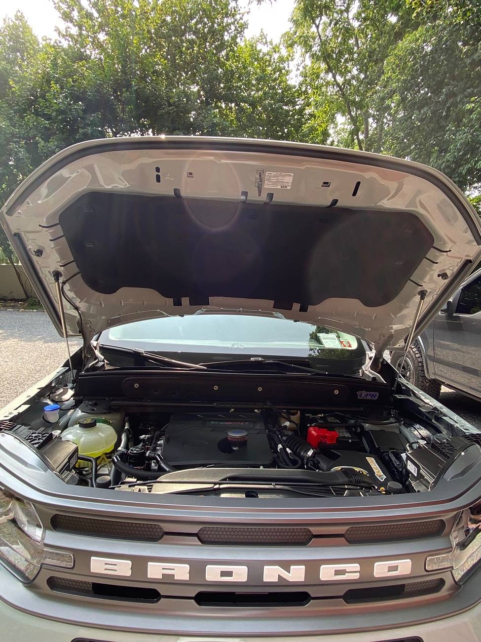

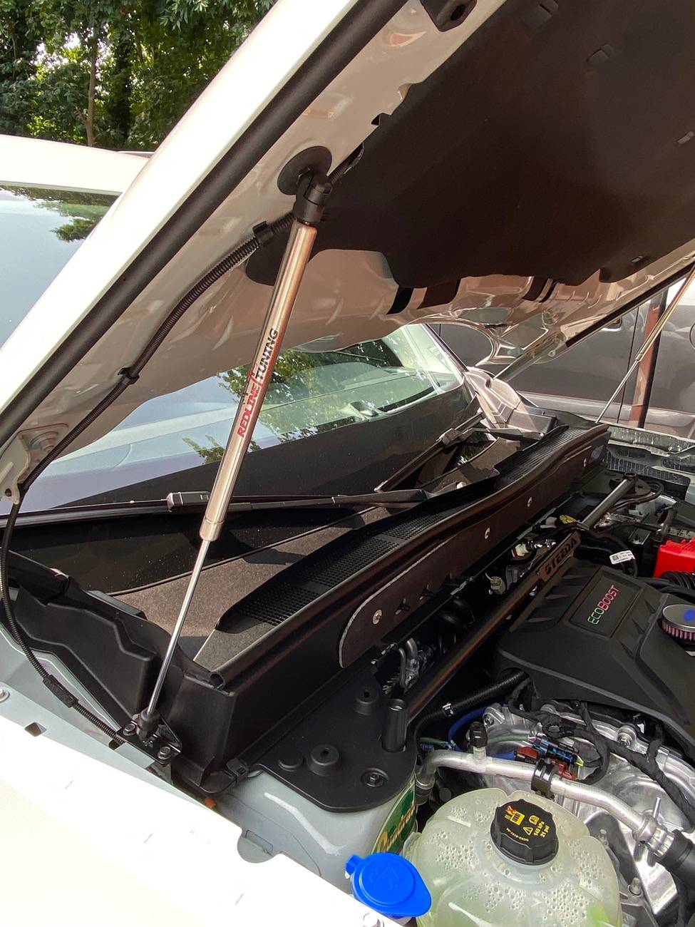

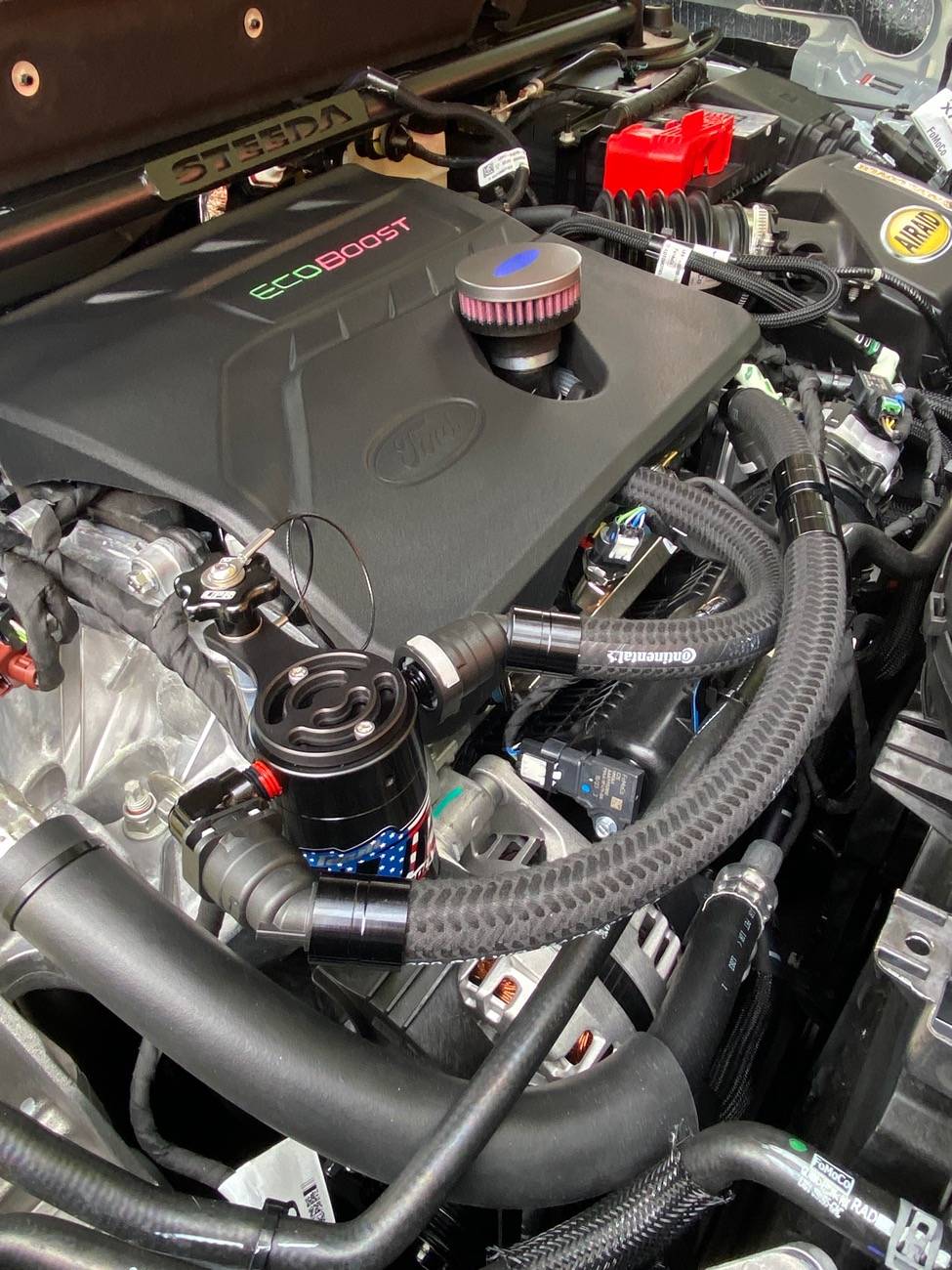

Do you have the rubber weatherstripping at the edges underneath the hood too?
I had to add the blanket and weatherstripping, firewall insulation, catch can and hood struts,
Ford Bronco Sport Engine tapping Bronco sport 1.5L ecoboost IMG_2115
Ford Bronco Sport Engine tapping Bronco sport 1.5L ecoboost IMG_2113
Ford Bronco Sport Engine tapping Bronco sport 1.5L ecoboost IMG_2114
and also for my entertainment managed to get an engine cover too.
