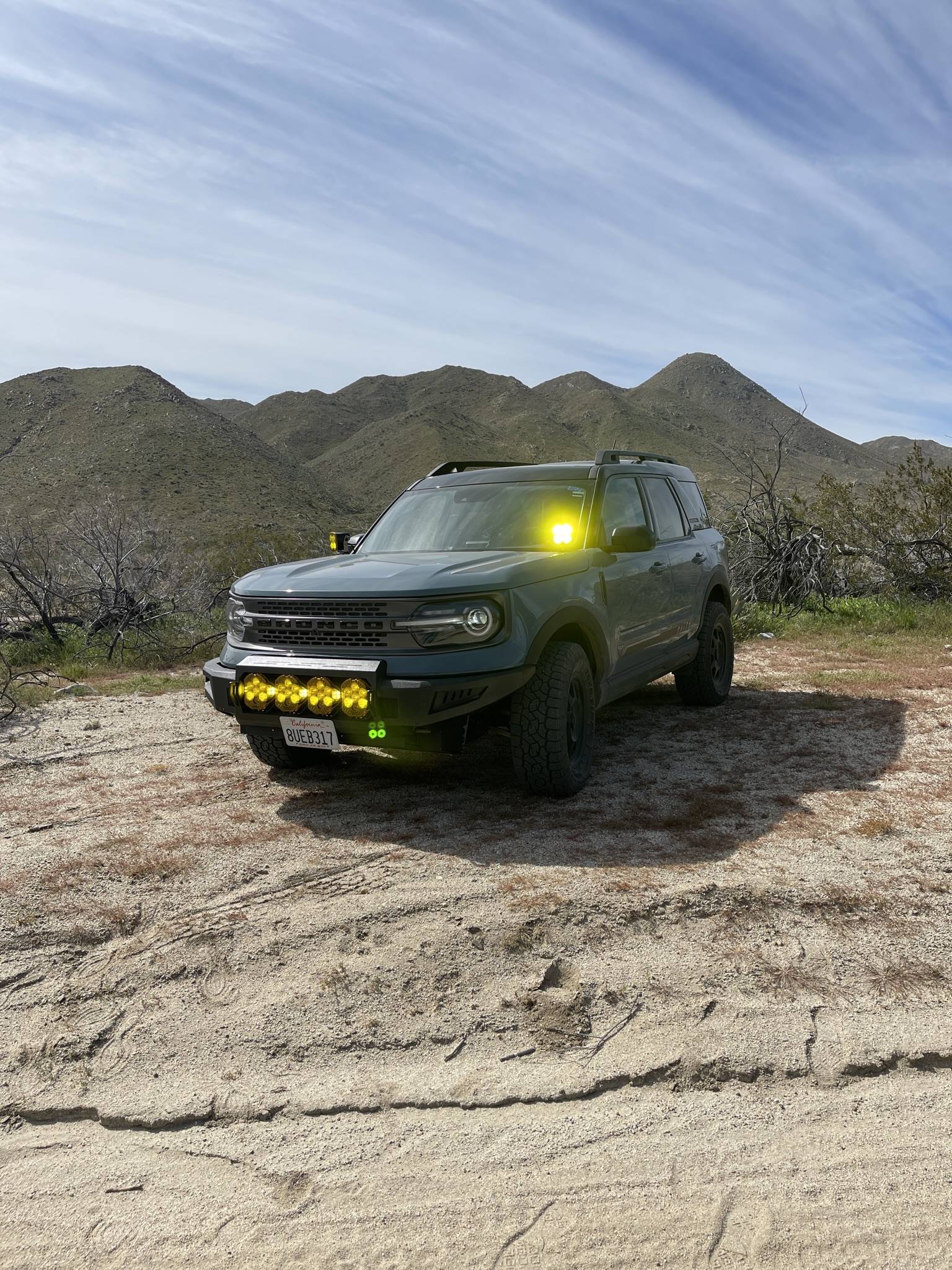

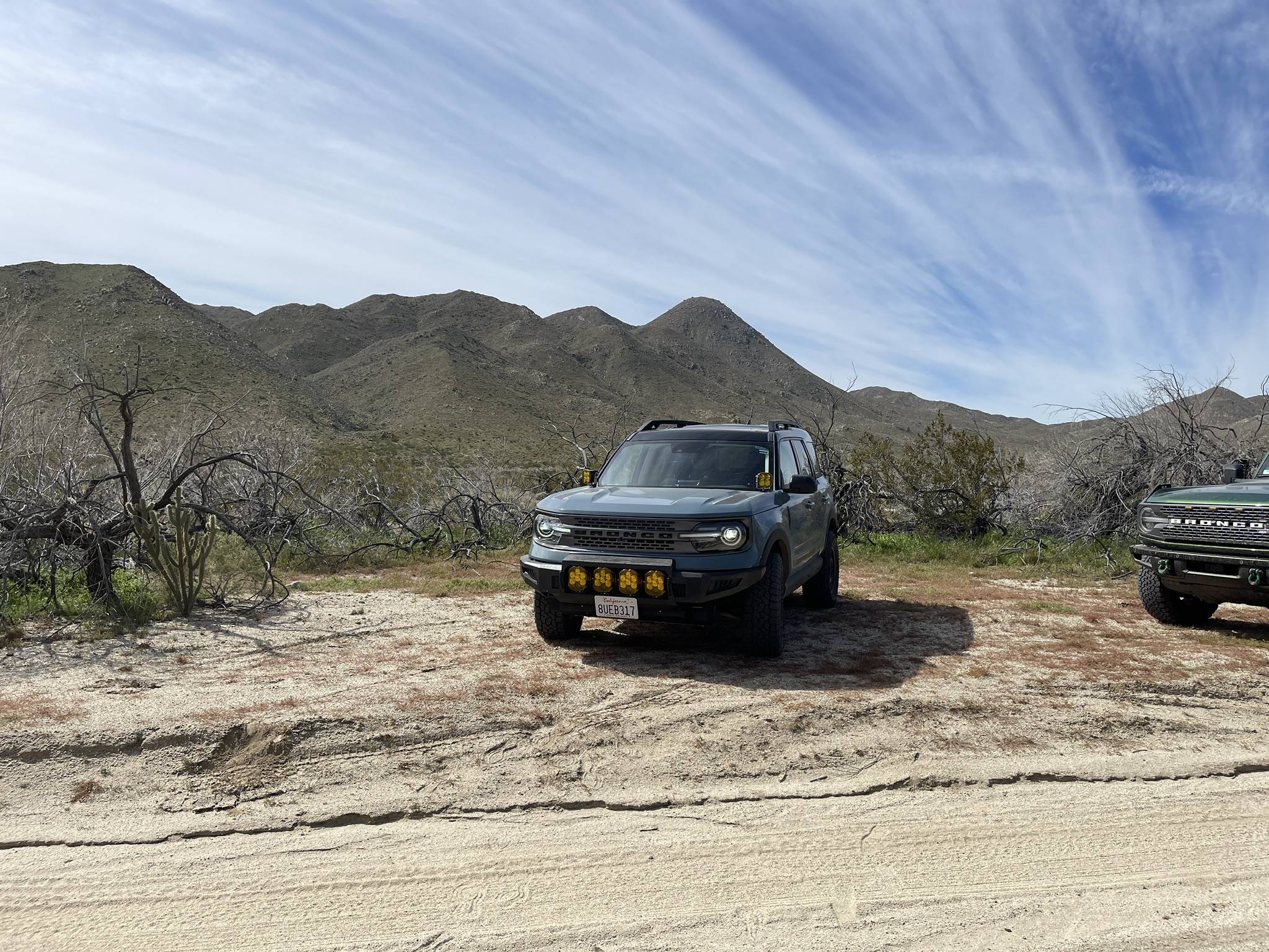

I recently modified my First Edition Bronco Sport and put a full metal front bumper and some lights. After about 2 weeks I started encountering electrical problems but I do not think it’s due to the new lights as I can cut power to them easily, so they aren’t drawing any extra power from the battery. The car would not charge the battery while the engine was running and car was moving. I god notification from my Ford app saying charging system fault, drivetrain malfunction, and other battery related notifications. I took it to a ford dealership and after a week they contacted me saying they were unable to pinpoint the problem, and their only suggestion is to return the car back to stock. Has anyone experienced any electrical issues regarding the alternator? Or does anyone have any recommendations for automotive electrical specialists in the San Diego area? Any help would be greatly appreciated. New bumper pics attached too.

Hi, I recommend you install a switch panel like the one with RC or Auxbeam, they already have a kill switch integrated and they go directly to the battery. Your bumper is great and looks great, what brand is it? Have you had heating problems because of covering the front air intake?
Thank you for the recommendations, I do have the Auxbeam light switches, and wired the lights into headlights instead of directly to the battery. The bumper is custom made and currently there’s only 2 out there. I’ve also had zero problems with overheating.

No wonder that bumper was familiar to me, I saw it in Mexico. Maybe that's the problem. All the lights must be connected to the fuse box that comes with the switch panel. none should go directly into any light on the truck. maybe that is causing an issue.
Yes it was made by a shop in Mexico. The reason I connected the lights into the headlight of the car was a recommendation from some mechanic friends with lots of experience installing these types of lights. Although their specialty is not newer cars, so that could possibly cause an issue. The strange part is that my alternator is not charging the battery even while I am driving. The Ford service center also claims that both the alternator and battery are in good condition and they do not believe that to be the cause of the problem.
