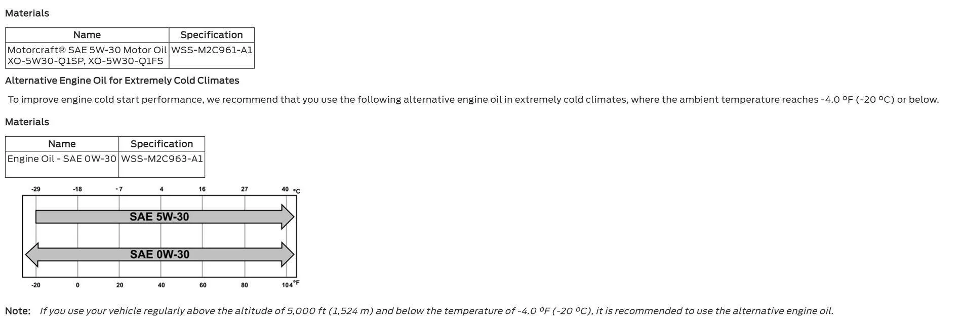

The recommended oil is 5W30. I don't believe the manual recommends 0W20 for the 2.0L. There is a recommendation for 0W30 oil for "extremely cold climates." Here's the link to the engine oil page for the online Owner's Manual for the 2025 Bronco Sport. Excerpt:
Ford Bronco Sport Ecoboost 2.0 MPC (2025+) Oil Specification Change 1749592247270-o3
It's a mistake in the manual for the Badlands 2025. Maybe it's been fixed. Anyway I knew from the beginning it was wrong. But new owner could put the wrong oil if they read the online manual.
Too lazy to check if they fixed it now .?
In any case, using what the oil cap says is never a bad idea.

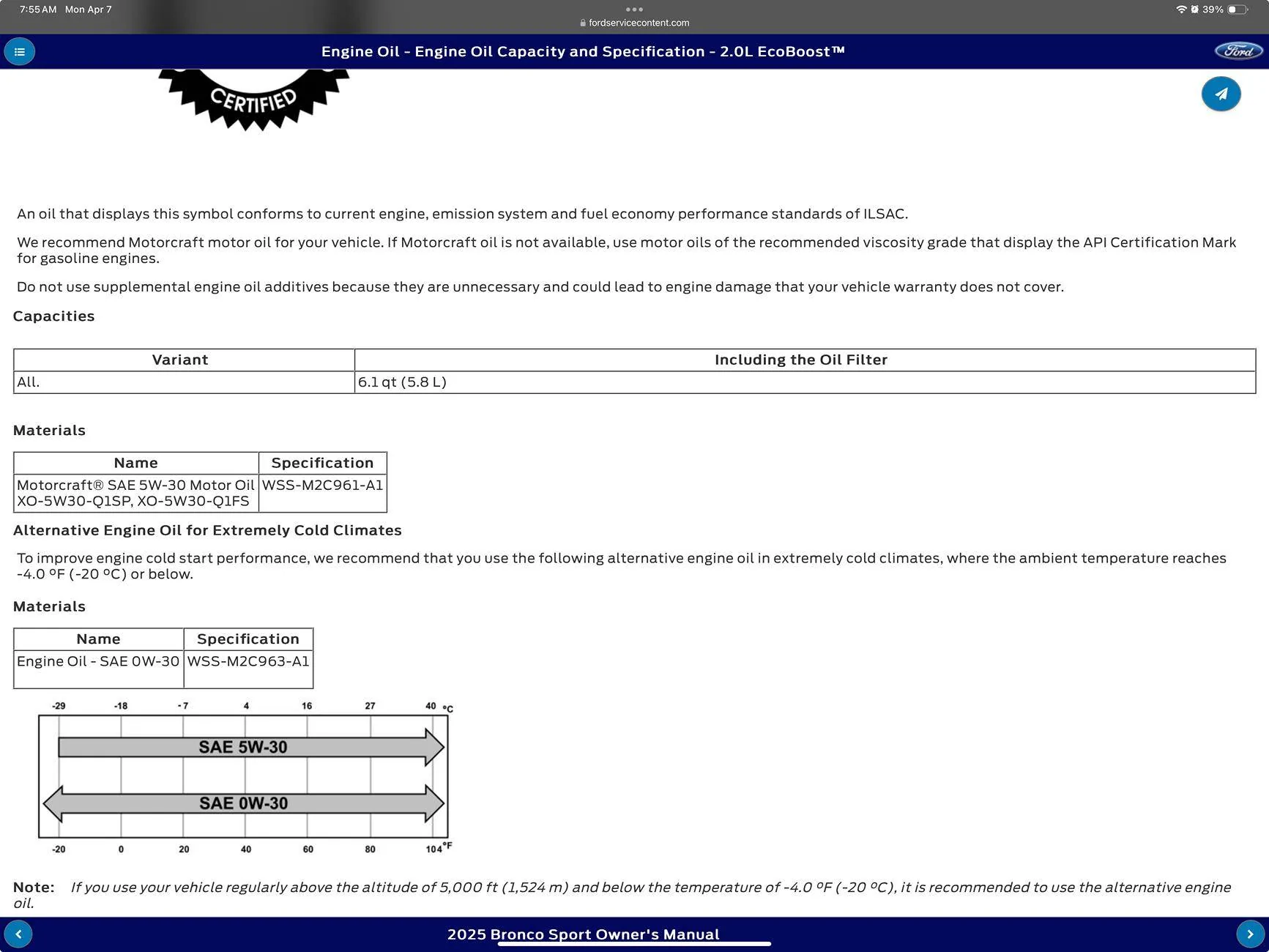

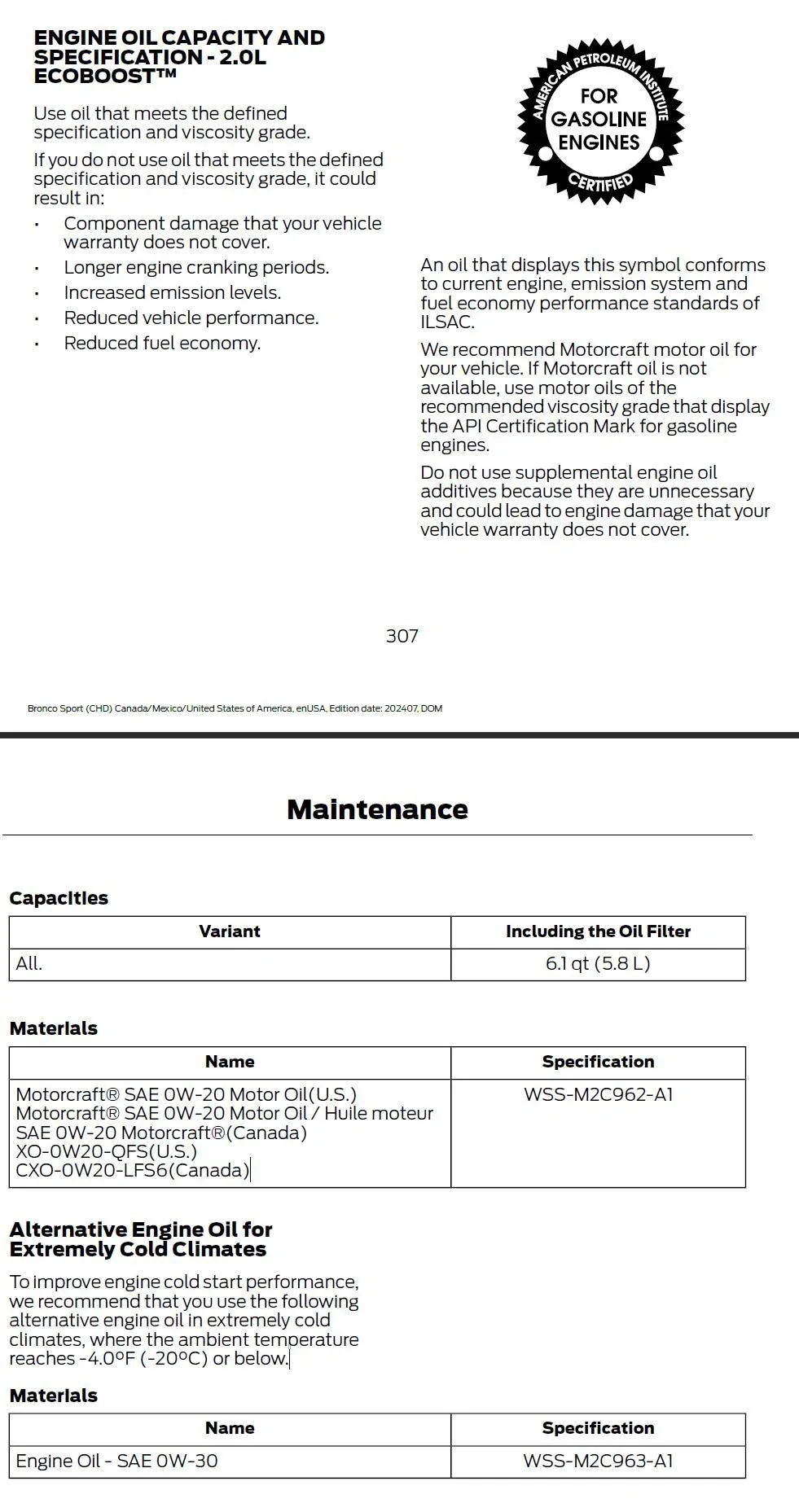

Wouldn't it stand to reason that the online version is arguably more current, and likely correct? After all, the publishing date for the PDF is now a year ago (July 2024) when the '25's were still pre-production.
