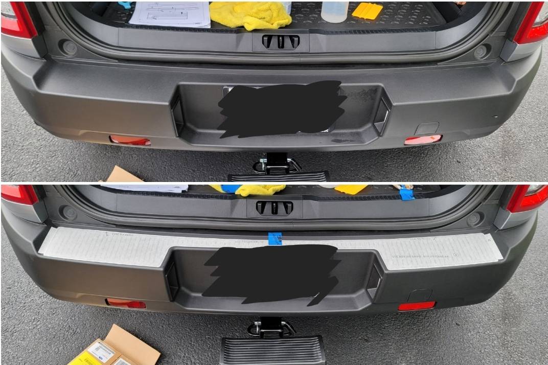

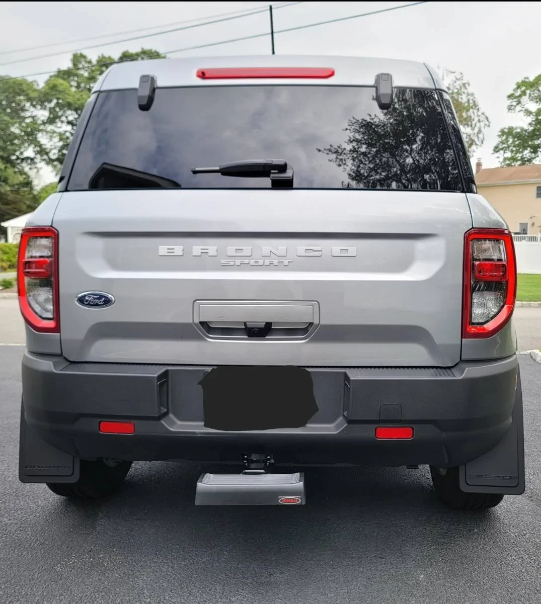

This was one of the easiest peel and stick project. I bought a bumper guard sticker, cleaned the surface, peel, and stick.

Your post just reminded me that I still haven't installed my bumper protector yet. After cleaning the bumper, did you have to wet it first prior to applying the protector? Or, did you just stick the protector onto a dry bumper? Thank in advance for your help and advice.

I did not wet the surface. After you position it and marl the center point, peel the center and stick in outward position (ex: center to right and center to left) to stick on.
