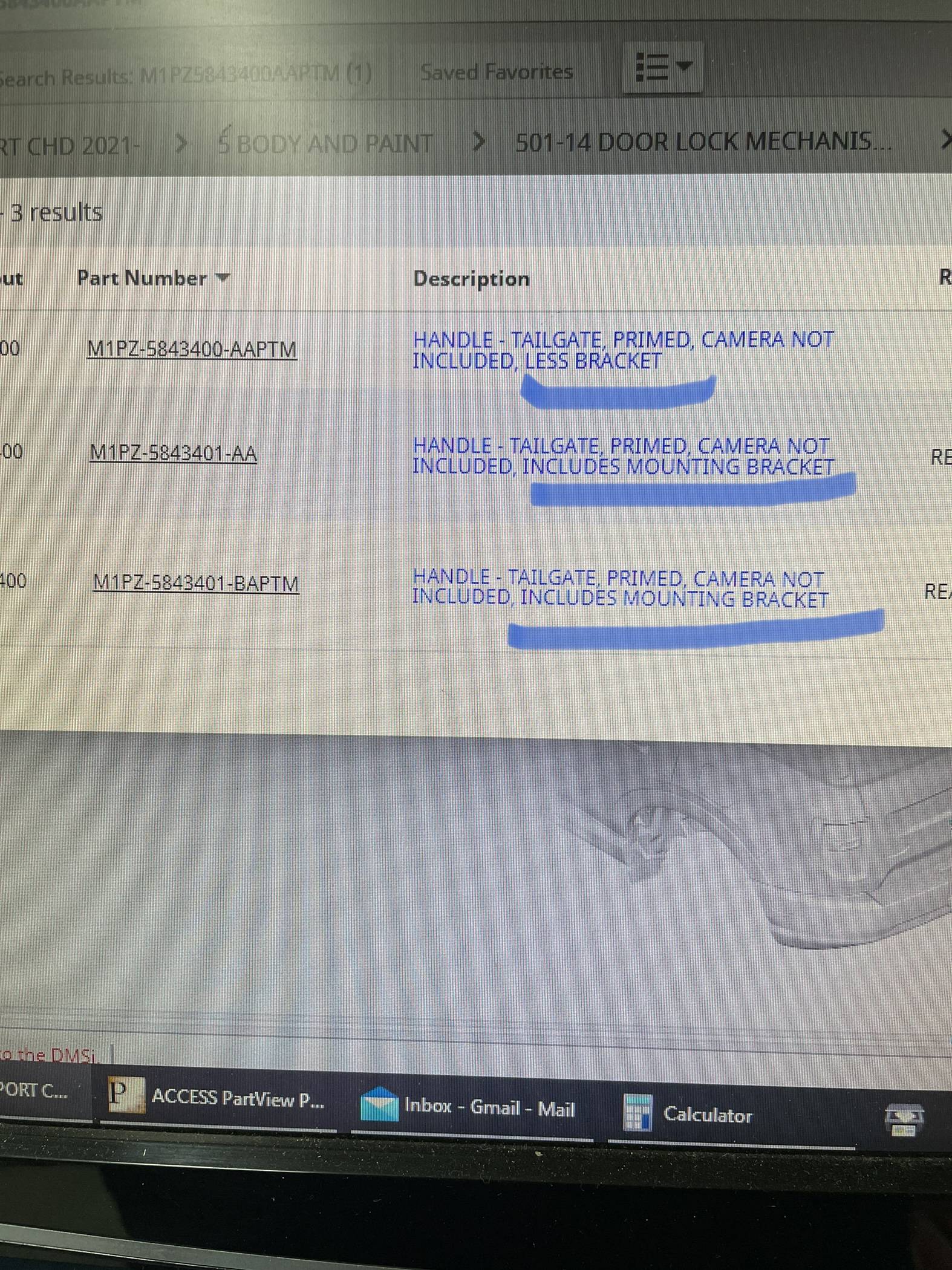

I work in parts at a Ford dealership and from everything I can see the camera shroud is included with the liftgate handle there are 3 options two include mounting bracket and one doesn't I'm assuming that mounting bracket is the camera shroud it's hard to tell though since ford hasn't provided any pictures for any of the part numbers other than the crappy illustration

So, I actually bought the handle and had it painted black to offset colors on my tailgate and it didn't come with the shroud at all even though it's on the illustration.

Do you happen to know the part number you ordered? It's been fairly slow here at work and I'm going to try to dig into this and get it figured out

Part#:M1PZ5843400AAPTM
The part number you ordered says less mounting bracket the other two options show with mounting bracket I’m still guessing the other two options would have the shroud I'm not 100% sure though so I'm going to order the M1PZ-5843401-BAPTM it's about a week out so I'll know more when it comes in, I'll keep you guys posted

Thanks for doing the leg work. When I ordered mine they didn't even have the other 2 options.
Just looked them up, holy cow, huge price jump too.

Ordered the M1PZ5843401BAPTM, it finally came in this morning, and it does come with the shroud unfortunately for me it was destroyed in transit, so I'll have to reorder it if I end up wanting to use it.
