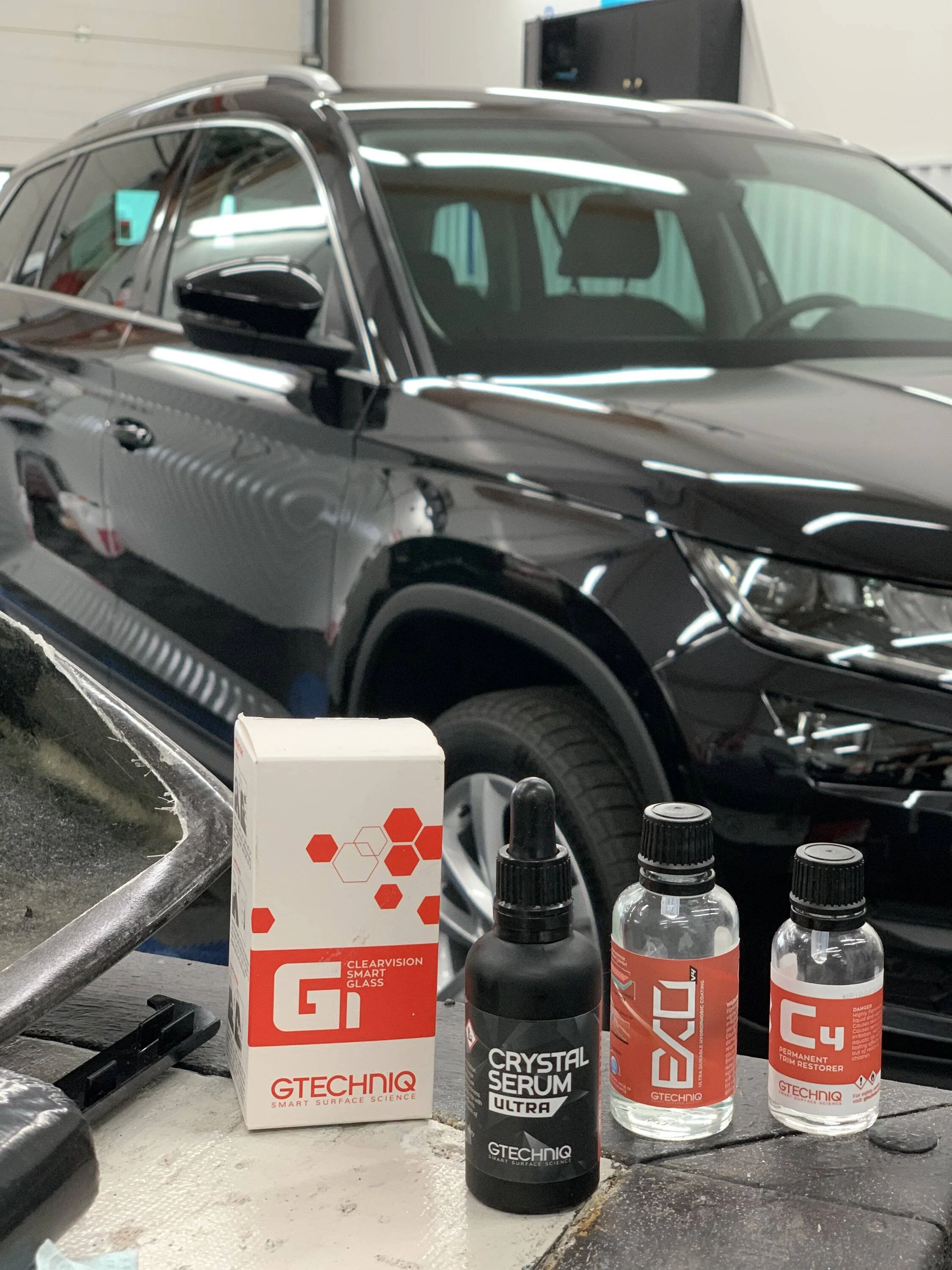

It’s very good idea I have been ceramic coating cars for years now and using most from Gtechniq gtechniq ultra 8 year coat and EXO over coat ultra is only from pro users . If you’re gonna do it yourself then I recommend 5 years lasting coat and exo over coat from Gtechniq
It’s three days work and not for all to do it you can also use infinity Lite one year coat its very good and dirt will just run off your car and its very good to use
