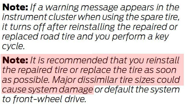

Just bought a '25 Bronco Sport for the wife, so I'm new here. I was surprised that the stock tire diameter is nearly 29 inches, but the donut-spare (155/70-17) is 3 inches smaller (under 26)! I have no experience with 'new car' RDU / PTU function (I'm used to Traction-Lok units from the past that wear out when you mess with dis-similar diameters) - so I wonder why Ford didn't have the donut-spare at a 155/90-17 instead. It would put the diameter much, much closer. Or a 165/90-17 to really nail the diameter, but I don't want to get into a tire-width discussion and full-size spares.
So it would seem that Ford feels the 10% difference in tire diameters is "bad enough you should repair it right away"... yet they could have just reduced this difference to 1% or 2% by upsizing the donut-spare sidewall height slightly - (in fact, the 90 series sidewall tire is cheaper at Discount than the 70 series!).
Text from the owners manual is attached. Being okay with a donut-spare width, I'm inclined to spring for a 90-series sidewall tire on the donut-rim on a '35,000-dollar-loaded-with-4WD-electronics' car. Just wondered if others have any proof that the 3" tire diameter doesn't cause damage, even though Ford thinks it's a big enough deal to put it in the manual. This seems to be conflicting advice, I think I'll rest easier with a 155/90 or 165/90.
Thanks in advance.
Ford Bronco Sport Difference between daily tires and spare? Spare in Manual.JPG
