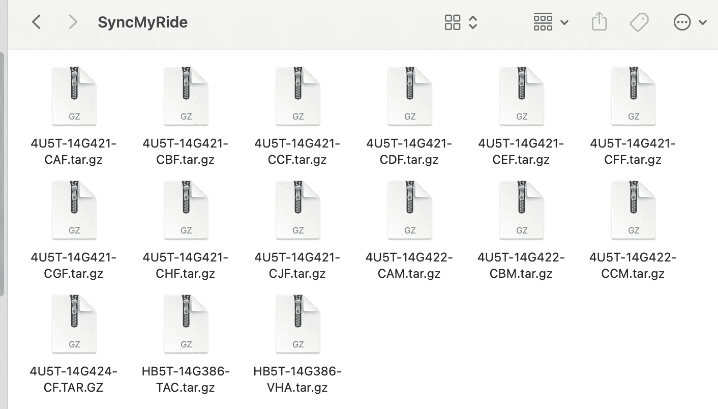

You’ll need to also move the downloaded license key file into the Sync My Ride folder

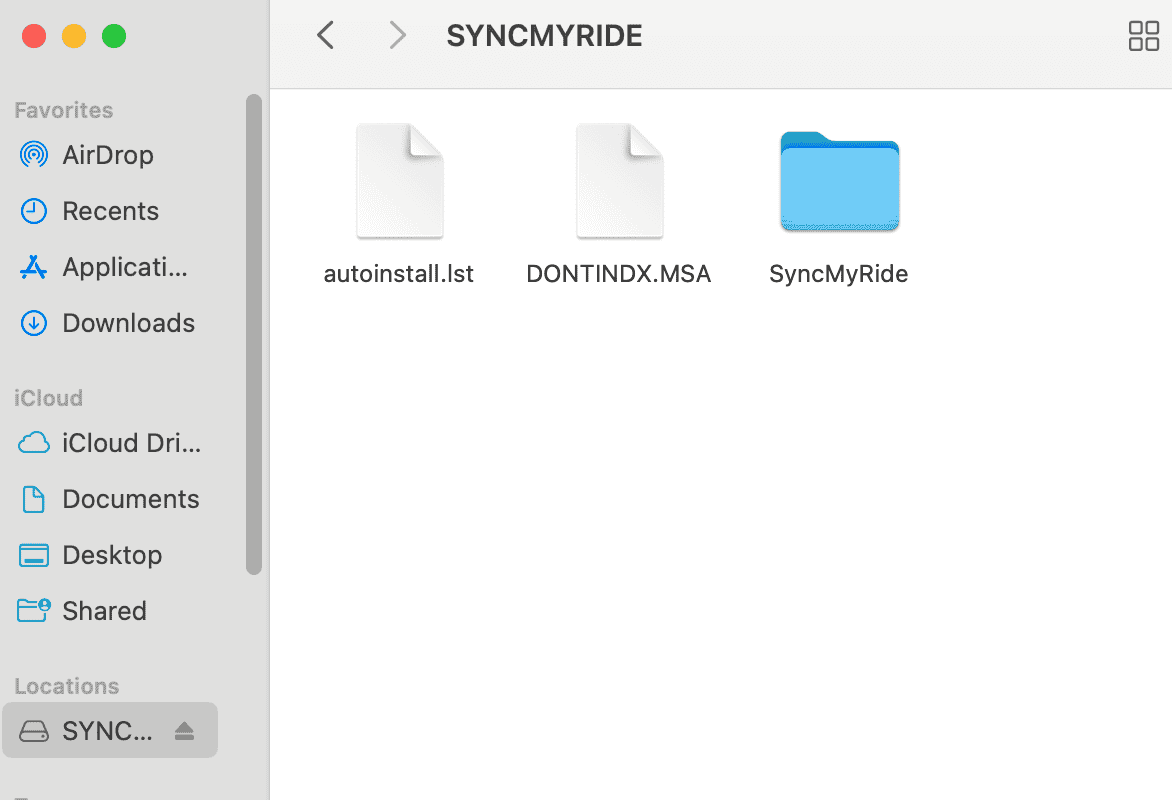

I have my USB loaded with the following.
Syn 32 (decompressed)
4UST-14G424-CF.TAR.GZ
Is this what I need for the download?

Yes. But within the Sync 32 decompressed file you should have the 3 files you listed in your first post. You want those on the drive but not within the master Sync 32 file. And then you want to move the 4UST-14G424-CF.TAR.GZ zipped file into the SyncMyRide folder.
This is what your drive should look like, and the SyncMyRide folder
Ford Bronco Sport Correct file? Screenshot 2023-09-08 at 9.57.11 AM
Ford Bronco Sport Correct file? Screenshot 2023-09-08 at 9.57.19 AM

Excellent! I think I got it. We're vacationing to central Ohio next week. I will try to upload the new maps when we're on the way home just in case there is a problem. Thank you everyone for your help and expertise with this problem.
