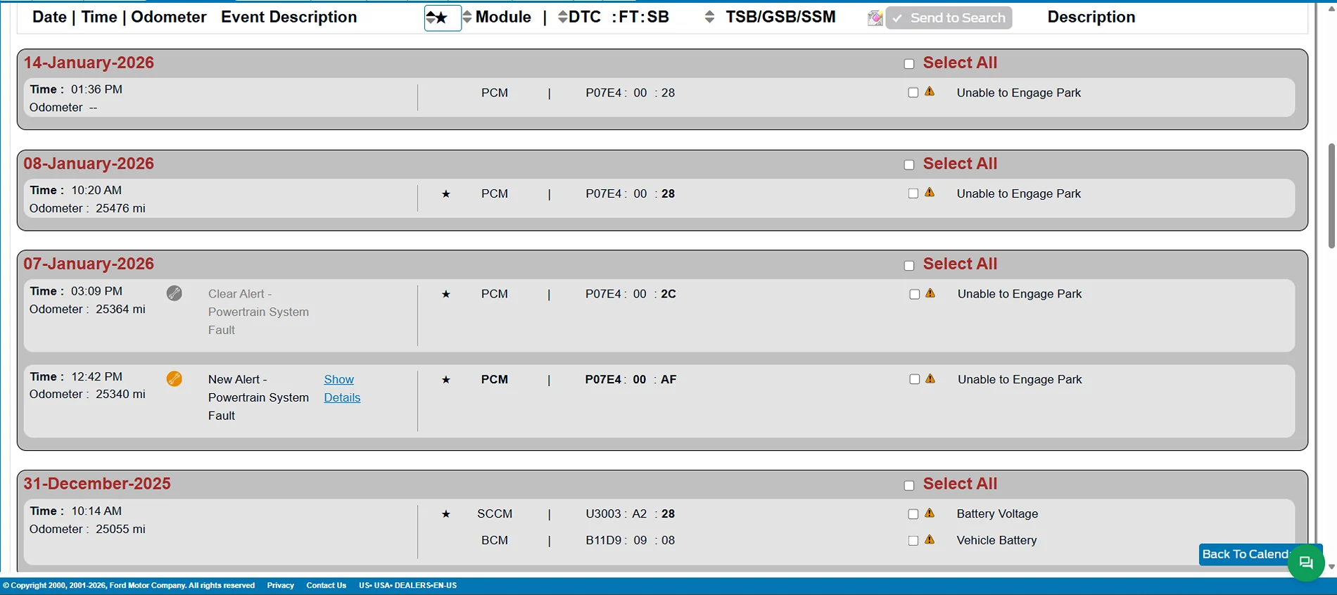

Got your message, but responding here for the sake of the info being out there.
Code history is below. Warranty history shows a dealer replaced the battery on 12/31. Notice the battery voltage code that was there on 12/31 (and every day prior) went away once they replaced the battery. However, the "unable to engage into park" code (which was also being recorded prior to 12/31) is still there.
It apears that the technician assumed the bad battery was causing the issue. However, obviously, something else is still causing it. Unfortunately, the fault type being reported to the cloud is 00, so it is not providing any info as to what is causing it other than the issue is in the PCM itself and not the gear shift module or AWD module.
It sounds to me like they ordered a new PCM and they plan on replacing it. Seeing as the only code your truck has reported in the past two weeks is in the PCM, it's a safe assumption that module went bad and that is the part they are waiting for.
