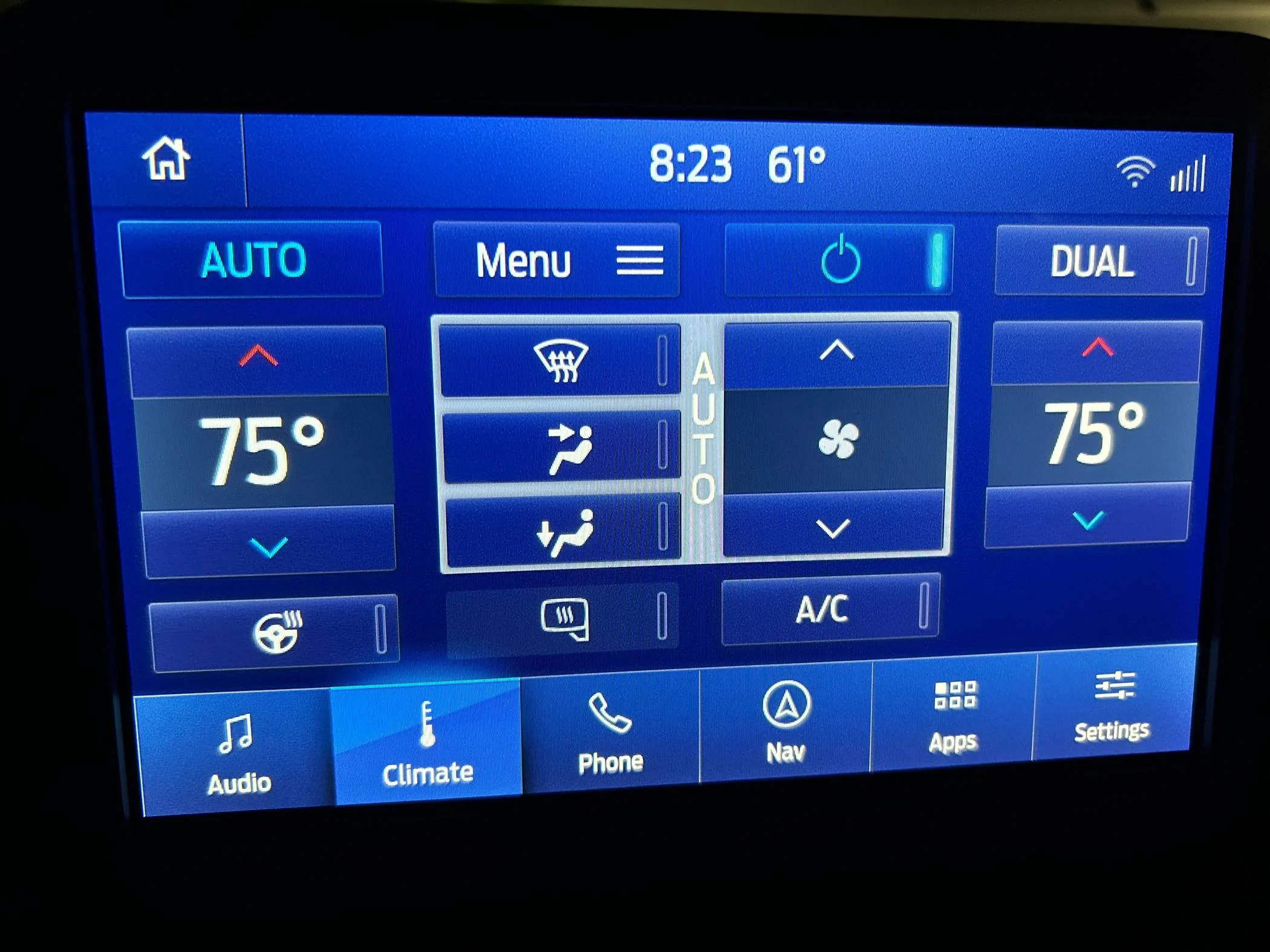

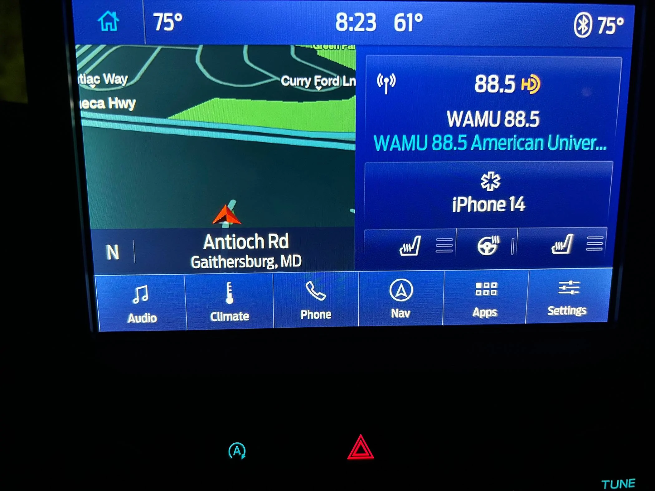

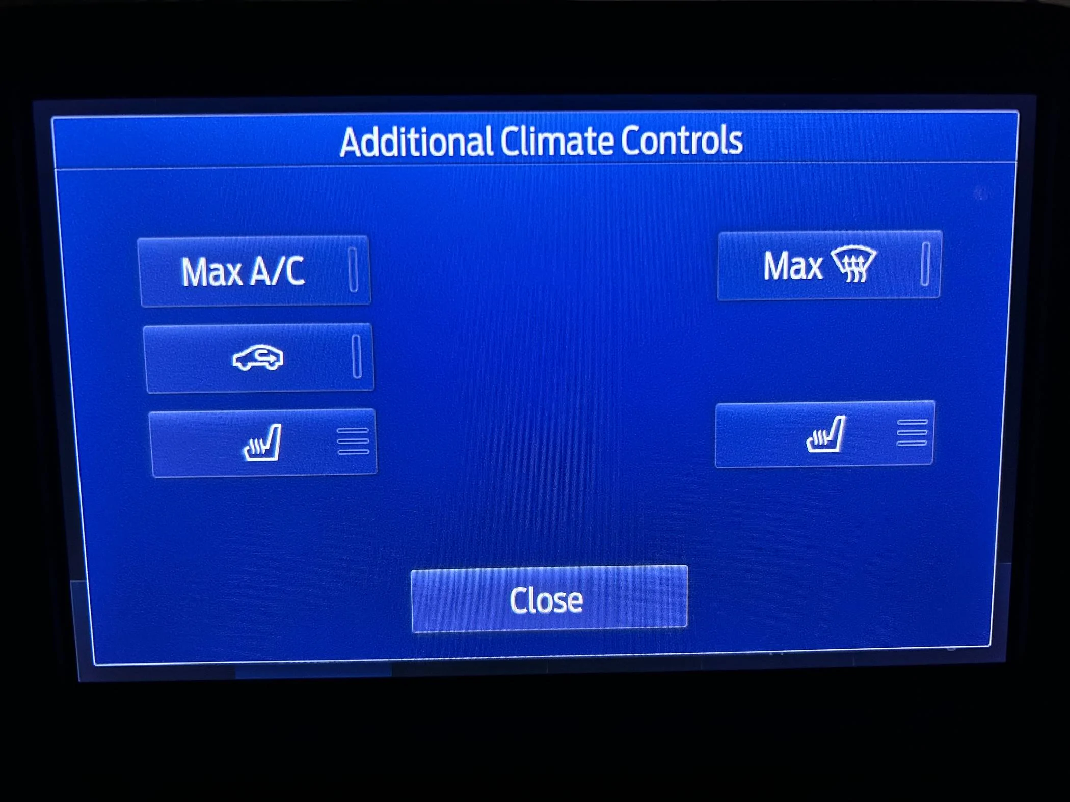

I set up the climate tab a few weeks ago and added the heated seats today. Everything worked great. The update adds the climate tab at the bottom of the screen. Press the menu button while in the climate tab and you can turn seat heaters on and off.

Does the dual zone climate control work if you enable this on a newer model that removed the dual zones?
Mine had the dual zones and it seems to work. Heated steering wheel and heated seats seem to work as well and will show up as red when they are turned on. Ford should have included this feature in the Bronco Sport; my 2013 Escape came with it. If yours does not have dual zones, you will just have to try if. I doubt that it work though because you need a different control for passenger side.
