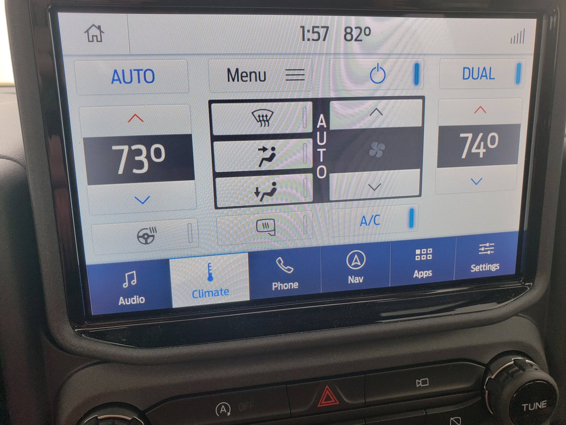

Took a bit of fiddling. Used the plain language version in Forscan on APIM module. It wouldn't take before, so "restarted " with engine on. Added Climate Domain first, then added each control in order.
Heated seats and steering wheel now on main screen, all other Climate controls available on screen.

It was a bit fussy - just powering up didn't work - had to do it with the engine running for each step... good luck!

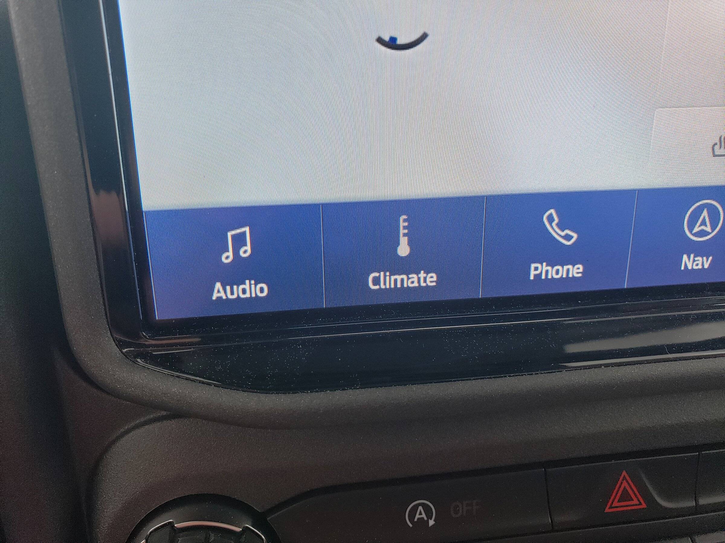

One more thing - at first on/ off cycle after adding climate, the center screen animation is a fade on/off Ford logo. The Bronco animation comes back after the 2nd restart...

Just tried this today and it works. Spot on man!

OP already said he did it via Forscan on the APIM module. "Used the plain language version in Forscan on APIM module. It wouldn't take before, so "restarted " with engine on. Added Climate Domain first, then added each control in order. "
