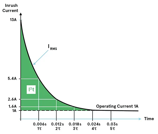

Most fuses (and circuit breakers) have a continuous rating of 80% of nominal. So a 20A fuse should be able to carry 16A indefinitely. Ford may say 15A just to try and avoid fuses blowing.
When a fuse blows (or a breaker trips) is a matter of both current and time. They can typically handle a very brief surge over their rated amperage -- but even if current is (say) just 90% of the rating they will eventually blow. The shorter the duration, the greater the amount of current the fuse can handle. This isn't the best chart, but this is the idea -- a "!A" fuse can take over 5A, but only for an extremely short period of time:
