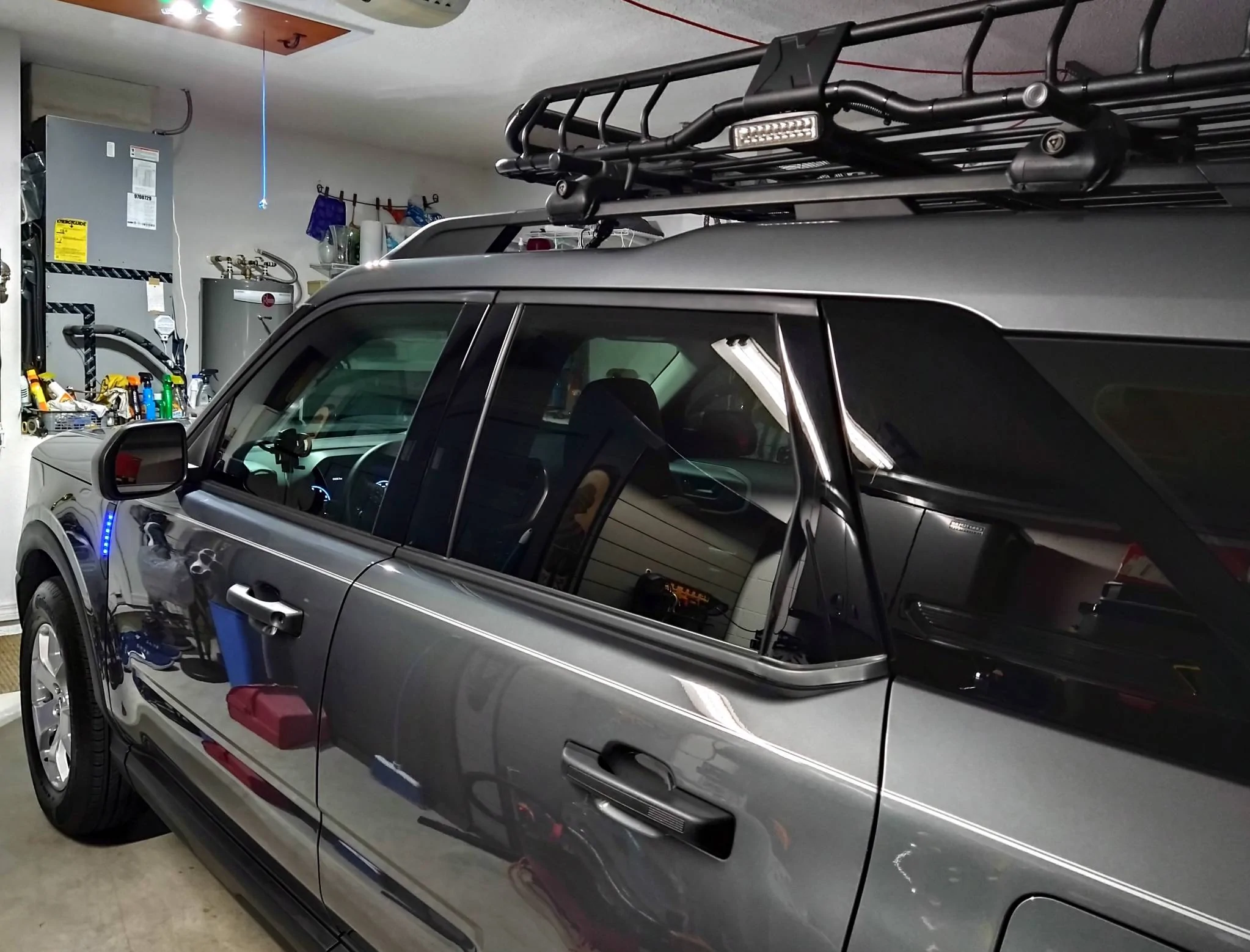

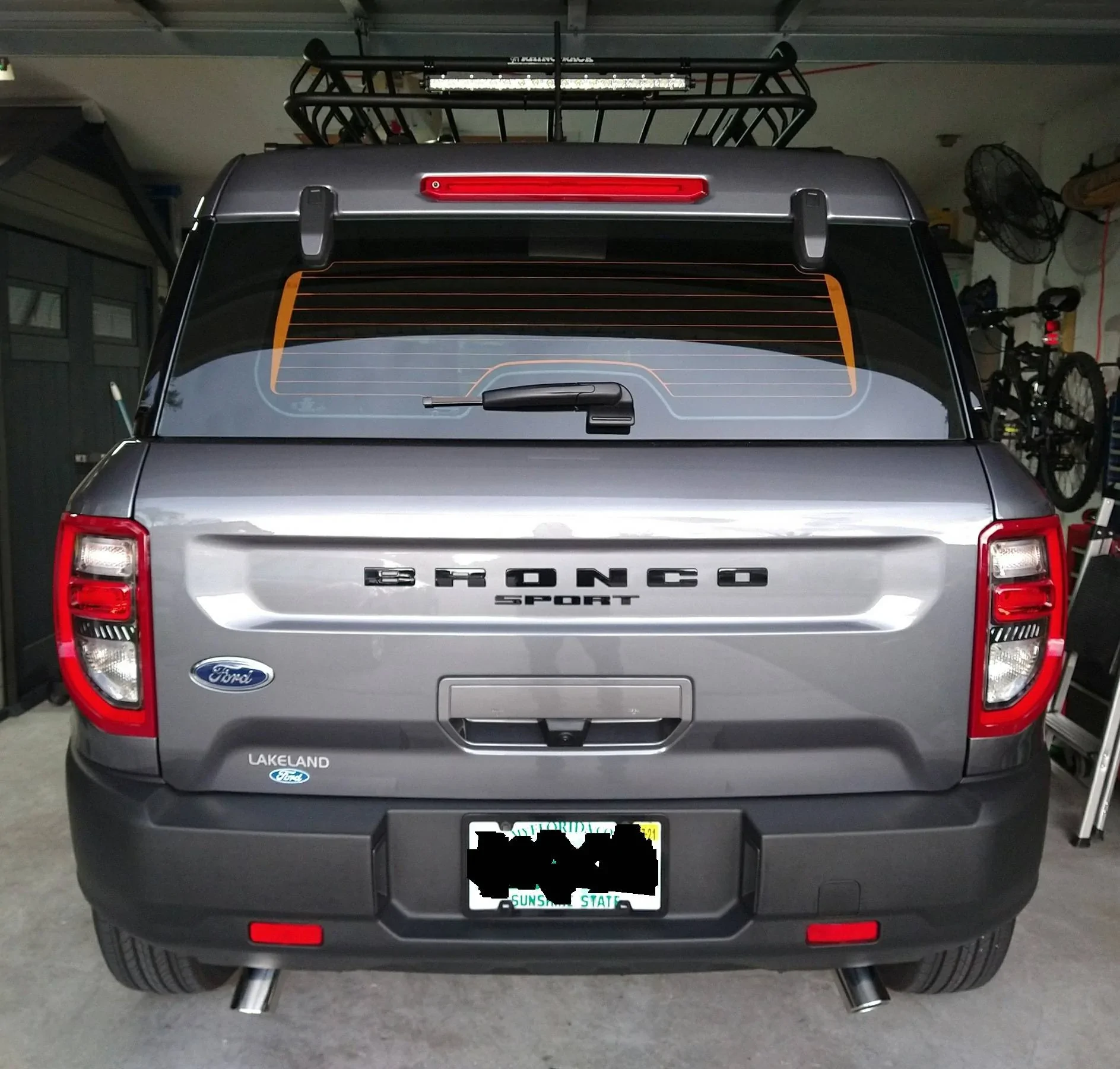

Is hard to say just testing in the driveway, but with the headlights and fog lights on, when the roof rack lights come on, you can tell the difference, I have lights all around the basket. The Idea is to illuminate a camping ground area 360 degrees while setting up and tearing down. I wouldn't advise driving with the roof rack lights on; you'll probably blind every driver around you and get stopped by Police...

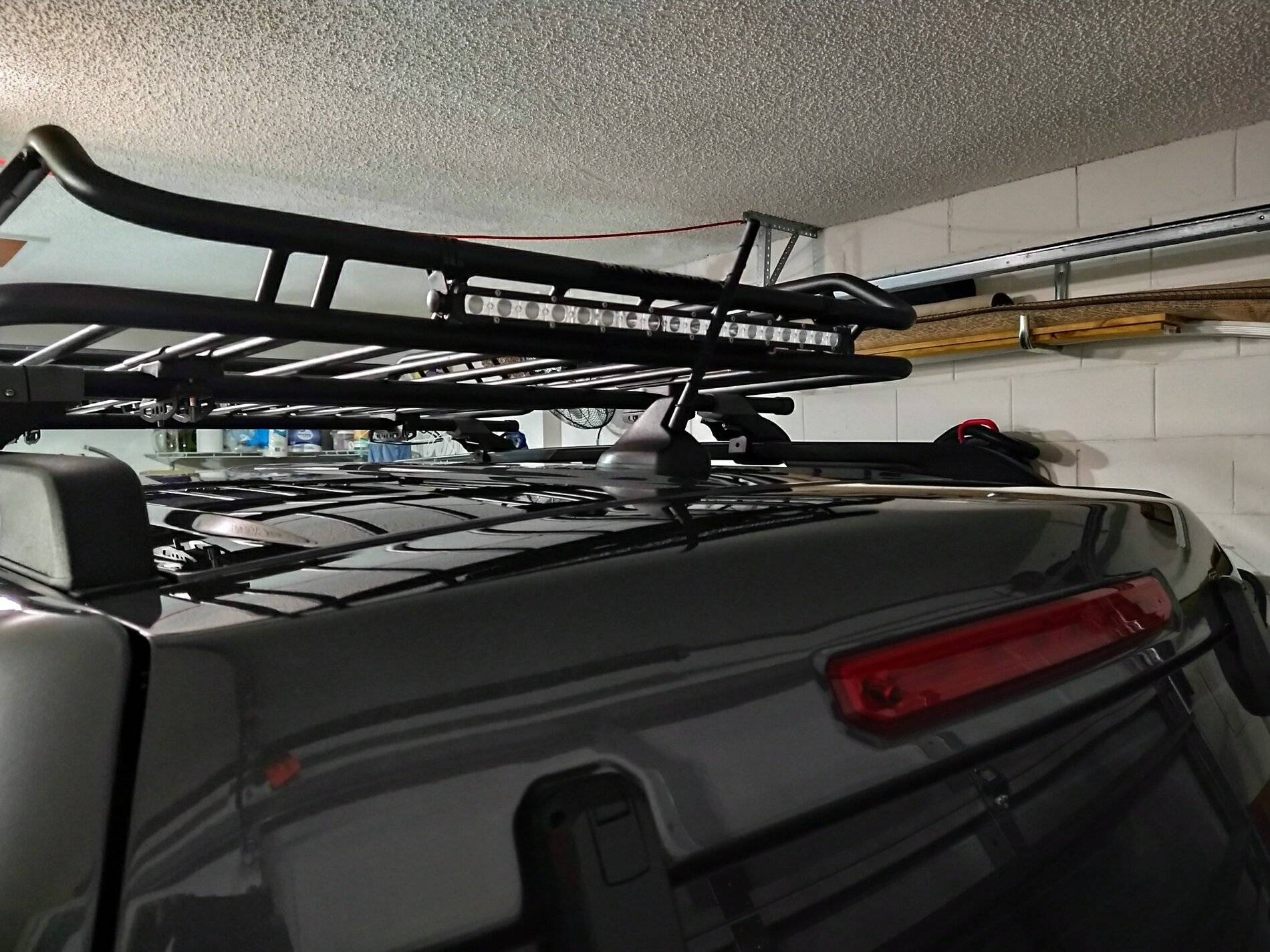

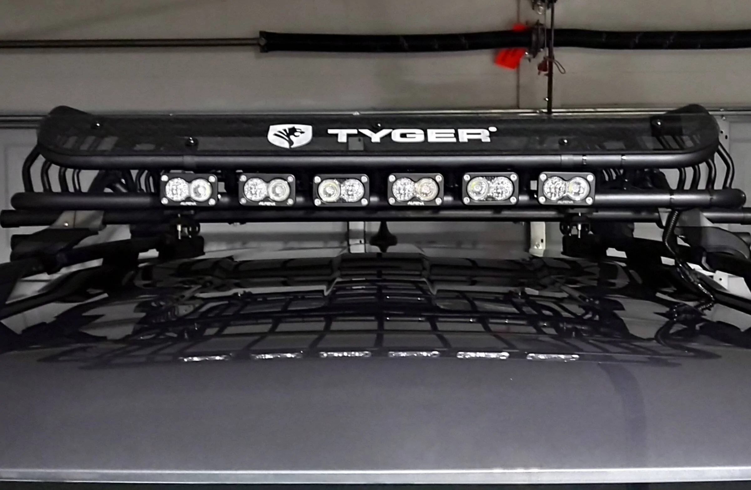

When I just had the cross bars only, it howled noticeably at around 60 mph. Once the roof rack was installed, surprisingly, the noise level dropped to an acceptable low hum easily overcome by the radio. The fog lights and rack lights are Alpena, you can find them at Walmart.

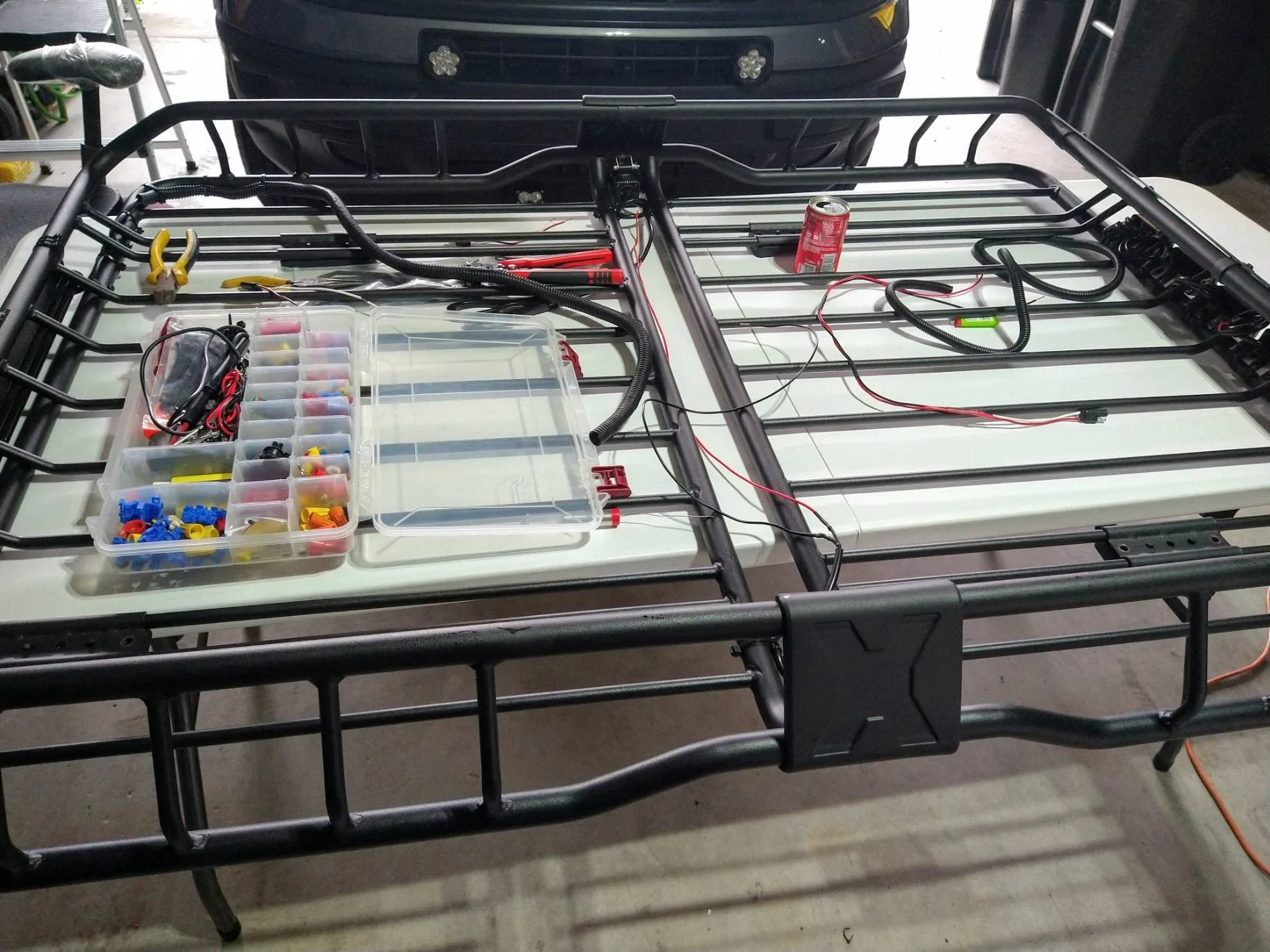

You have to remove the black trimming on the A pillar I believe they call it. carefully rout the wire harness up the pillar, there is plenty of space under the roof rail trimming to hide the wire under.
