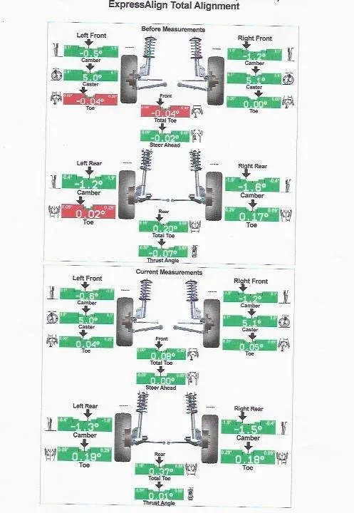

fourthgear
Jan 31, 2021
536
602
florida
I had some issues with the Wife's 2021 BS when I drove it & had it pulling to the right & the steering return to straight was pretty aggressive . 4 Wheel alignment made it like new .
This photo is the results & know nothing about these numbers , how bad was it ? Anyone know how bad these numbers were ?
Ford Bronco Sport Bronco sways, pulls upon deceleration 4wheel alin
6,727
13,167
It seems like you have a better understanding of that than others who have not had alignment issues. Clearly, the angles don't have to be off that much to result in undesirable handling. You had one front wheel pointed outward of where it should be, and one rear wheel pointed inward of where it should be. That seems like a bad combination, and your experience seems to confirm that.
