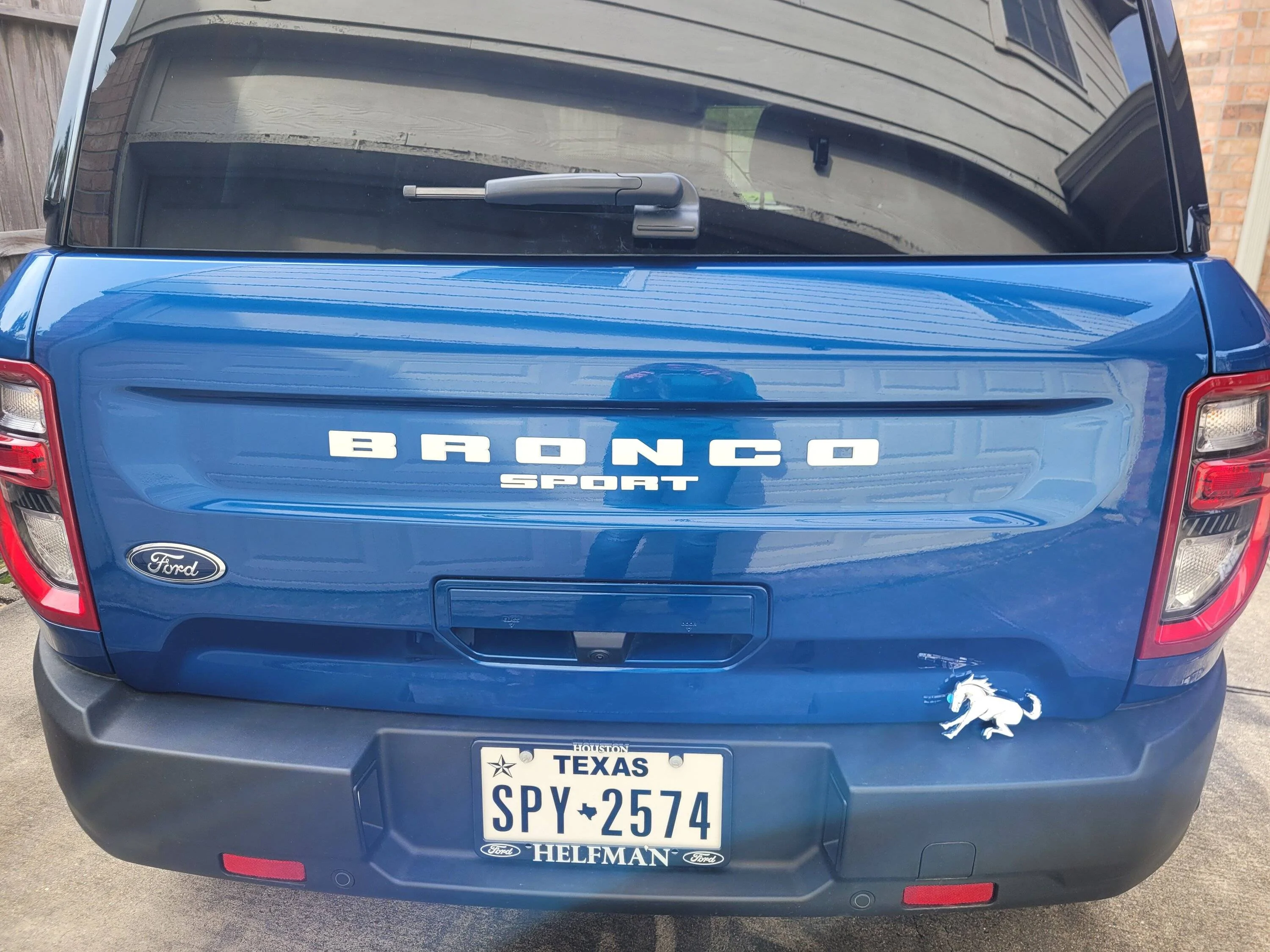

Installed!! New bumper guard, bucking bronco, and script.
The blue tape worked wonderfully.
Of course, after I finished and walked away from a further distance, I worried the driver's side is at an angle.
What do you guys think? Does the script and the horse look good enough?

Perfect looks amazing. Black on that blue looks correct.

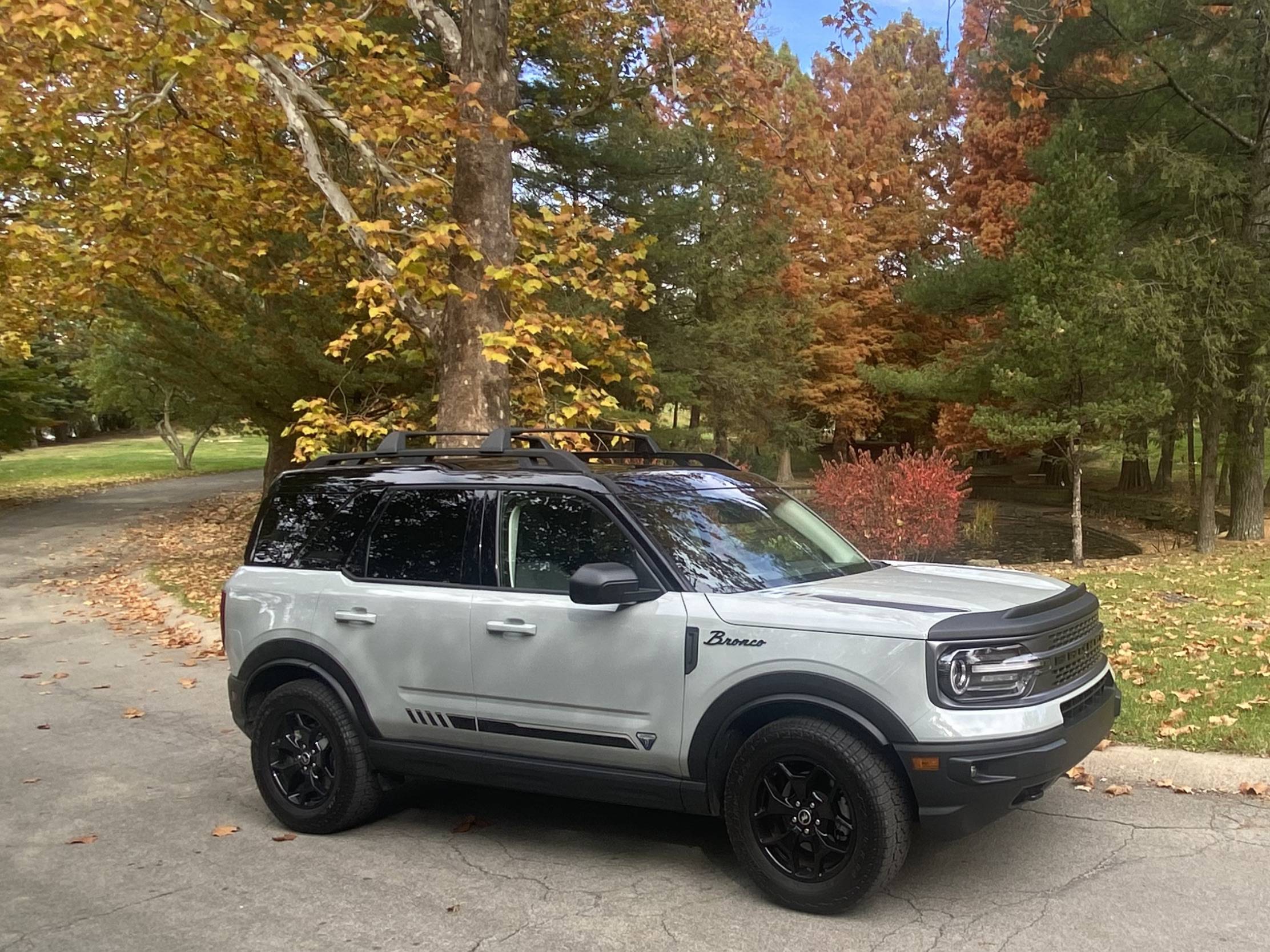

Look. Back at pg one JLR's post with pictures of his white bronco. He told me "Take a look , this might help .Buy 1 inch blue tape and match it to the hood joint and then 1 inch from the vent . That’s what I did if you like that look . Good luck ."
I followed his advice. I did one inch blue painter's tape next to the vent vertically, one inch blue painter's tape by the hood joint/ edge. Then i find the wider blue painter's tape was the same width as the script. So i put that down next, then another strip of painter's tape below that. Removed the wider space holding tape, and cleaned the area really well and with alcohol wipe. Then i doubled checked that the script fit in the space..removed the 3m adhesive covering, and applied.

Actually jrl bronco is cactus gray first edition. Yes sometimes it looks white .

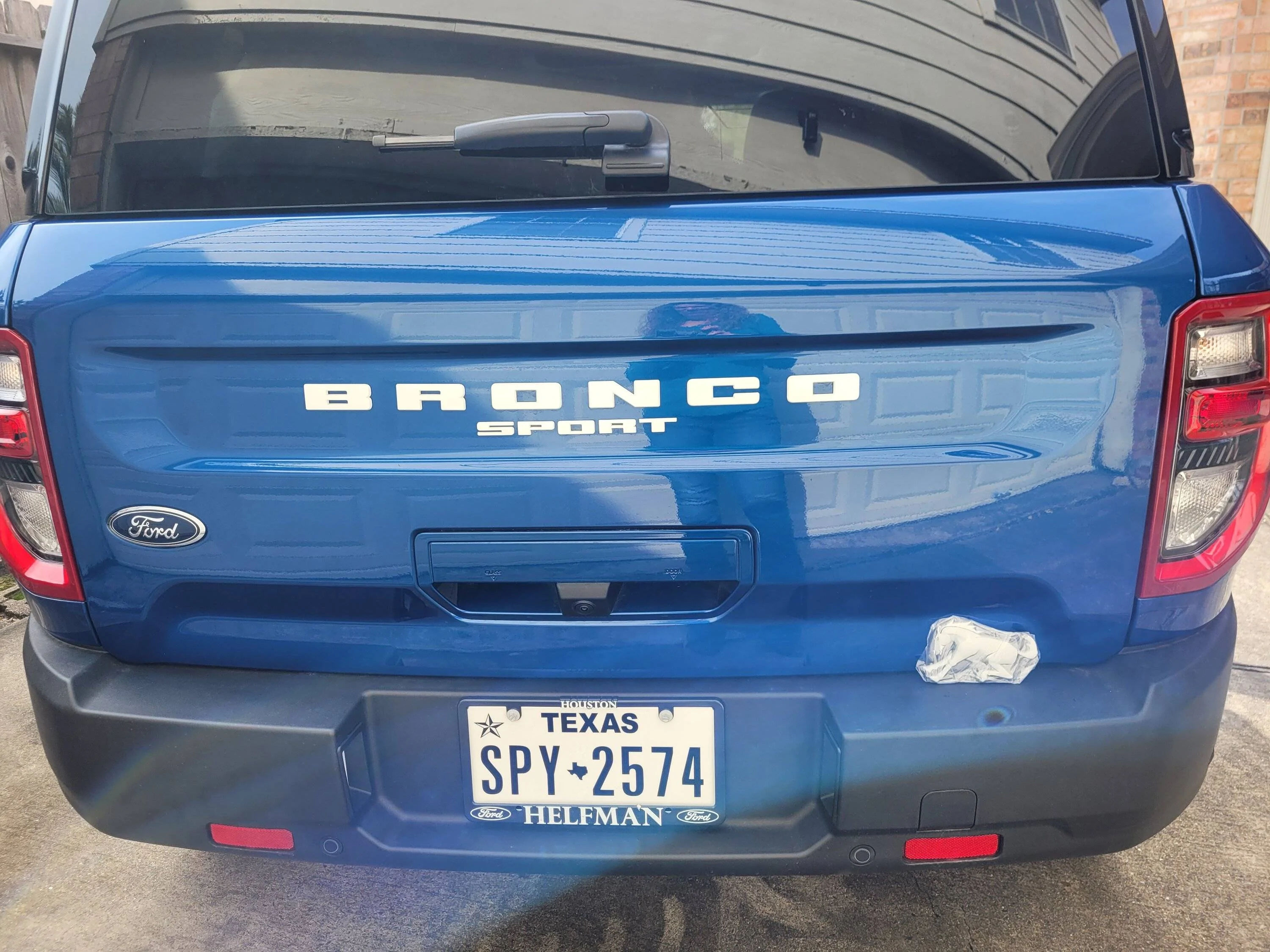

Sorry I didn't think of taking pictures during the process. You got this though. It wasn't difficult. I just took my time and double checked. When i put the bronco on the back, i taped it on with blue tape just so i could step back and look at the placement in relation to everything else

Oops, thanks for correcting me. It's really sharp looking
