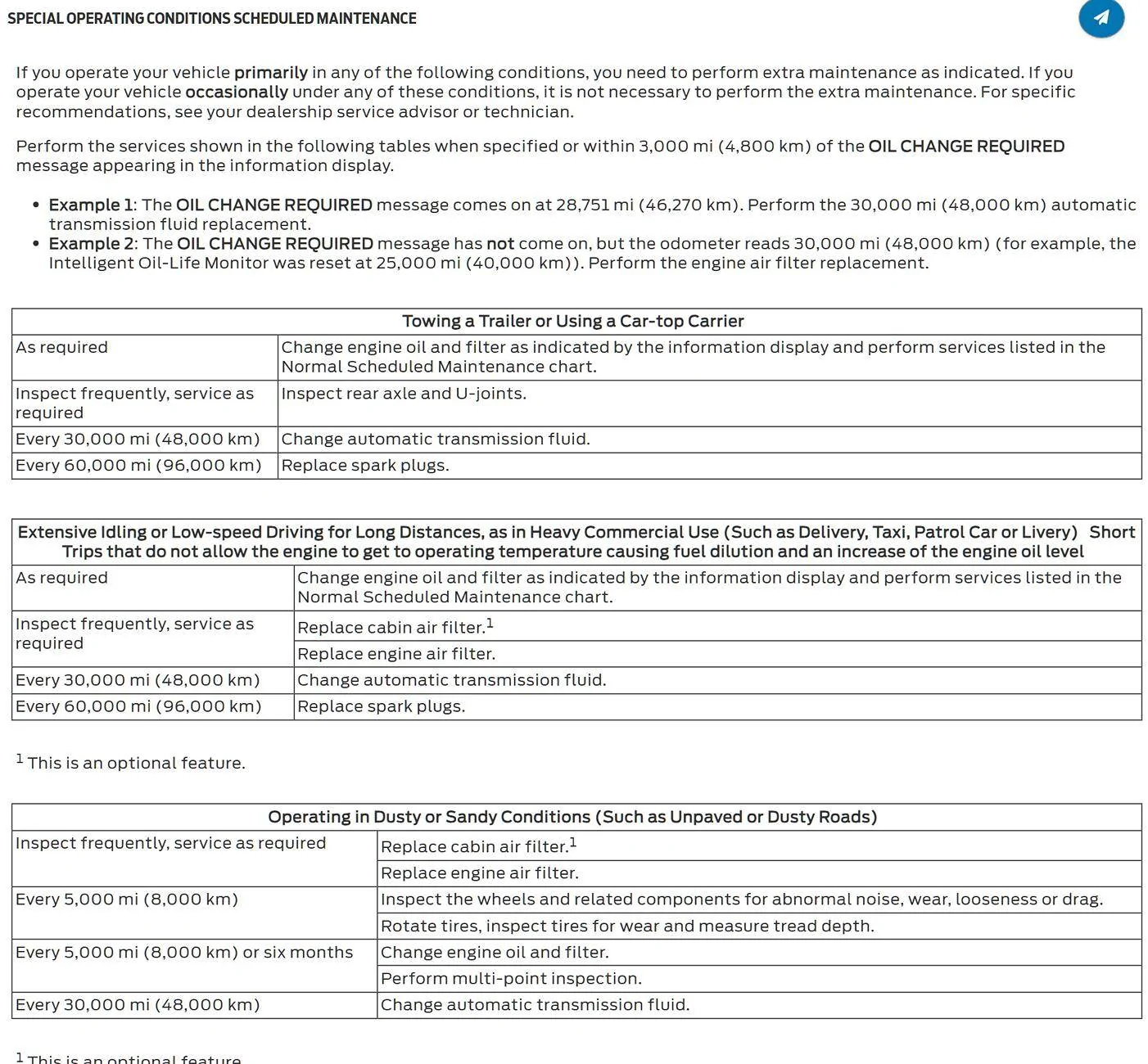

I'm not sure where the author came up with that. She spends the first part of the article explaining how the IOLM works, then suggests you ignore it in favor of 7,500 mile intervals. Confusing.
it's important to note that driving conditions can vary, and certain circumstances might require more frequent oil changes. For example, if you frequently drive in extreme weather conditions, take your Sport off-road, or tow near your capacity, you may need to change the oil more frequently.
This is covered in the Owner's Manual:
Ford Bronco Sport Blackstone Oil Analysis 1738761422422-p7
I've opined on Brian Makuloco's recommendations in the past. While he may not do it consciously, his opinion is that of a maintenance person who makes his living performing maintenance. Of course he will err on the side of the equation that brings him the most business. If I were to give him the benefit of the doubt I'd suggest that Brian is perhaps attempting to find a middle ground between the normal and special operating conditions maintenance schedules on the assumption that owners will not read the manual and understand when they should NOT follow the IOLM.
My recommendation has always been to simply follow the recommendations in your Owner's Manual--including those covering special operating conditions. This, of course, requires that owners read and understand the manual, which is not something many owners seem willing to do. If you tow, spend a lot of time idling in hot weather, or frequently operate in dusty or sandy conditions you should change your oil more frequently.
