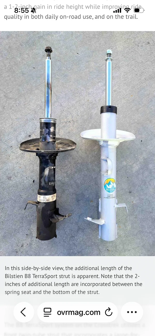

I saw possibly a reddit post where a person tried that on a compass with a b8 terrasport kit and it didnt work properly. Somehow I am under the impression the b8 dont have as much travel as regular bronco shocks and struts, most of the posts on that series are from people lowering their suspension. But Im just guessing.
I just found this for a crosstrek
