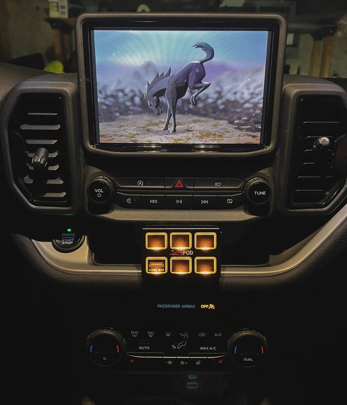

What I’d like from the Sasquatch package right now is to retrofit the auxiliary switches into my 2024 Badlands.
Probably pretty easy to run; similar to what Im running now (old pic more toggled now) just installed where sunglass holder is. Someone skilled at retrofit can make anywhere seem custom.

Probably pretty easy to run; similar to what Im running now just installed where sunglass holder is. Someone skilled at retrofit can make anywhere seem custom.
Ford Bronco Sport Bilstein Shocks IMG_4862
Yeah I want the ford switches. They just need to replace that panel and run the wire harness. I retrofitted my jeep wrangler auxiliary switches two years after I had it built. It will just depend on if Ford will make it available.
