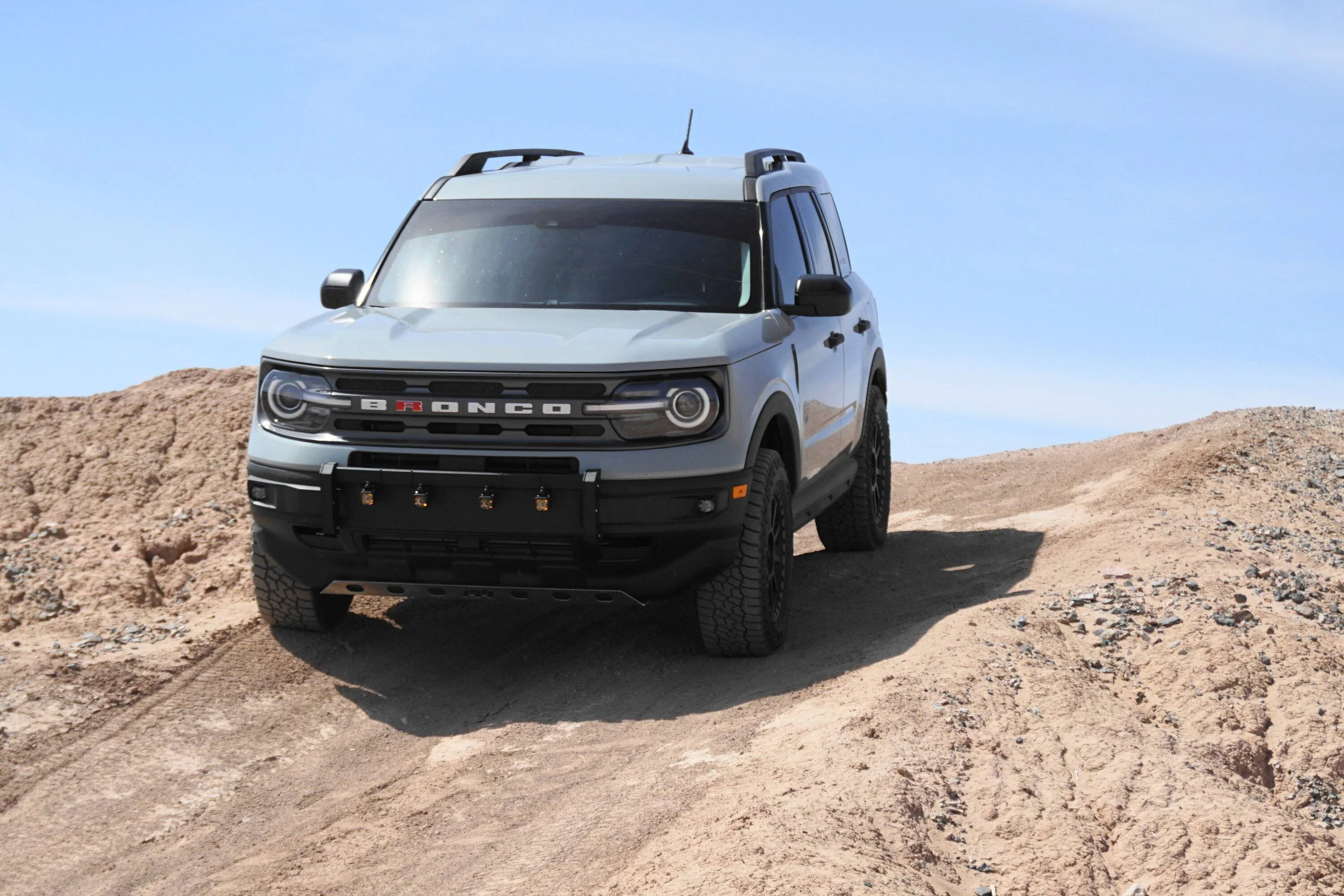

I live in the middle of the desert and a 1.5 lift did wonders for me. It's a simple lift and looks good. Add tires to which ever kit you go with. Mine drives fine on highways. I have about 10k miles on a HRG kit with no issues.
