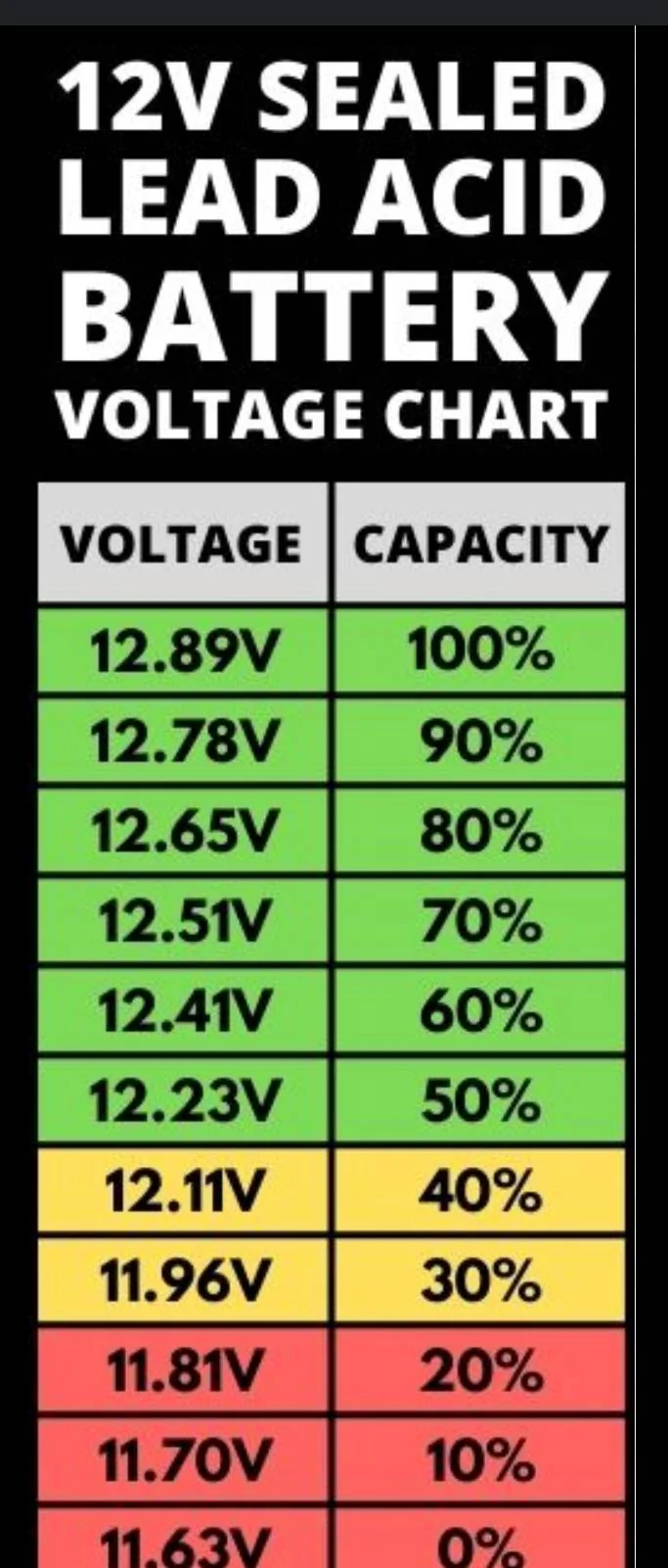

I only asked because the voltage in your pic showed 11.94V and also showed 42% SOC. I’ve wondered if battery testers like in your pic just use voltage to look up the SOC (many of the battery testers ask you to input your battery type) .. see this AGM chart. Was curious if you have an AGM battery that’s all.
Ford Bronco Sport Battery Charging Voltage IMG_1959
Also included the chart for the sealed lead acid battery.
Ford Bronco Sport Battery Charging Voltage IMG_1960
I am sure that it is voltage related and your table seems to correspond with my tester readings. I have installed some solar off-grid systems and that is the way that their battery controllers work. They generally use different charging algorithms based on type of battery used, battery level and mine does some variations depending on battery temperature. I noticed that FORScan indicates an AGM battery charging setting and has a 80 percent battery level. That may be the level where it stops doing the start-stop or where it shuts down the accessories when the engine is not running.
The 80% battery level might also be a point where the battery charge algorithm changes. I’ll take a look at FORScan and see what other battery data is provided.
The relation of battery voltage to SOC for different battery types is well characterized but there are different charts published by different manufacturers (and others) so the 2 posted charts are just one set of many variations.

The BMS has nothing to do with the voltage you're reading when the vehicle is turned off and the battery is rested. At less than 50%, you've shortened your battery life. If it is reading that low, you either have a bad alternator, a bad BMS, or most likelly, you don't drive on the highway long enough to fully charge your battery.
