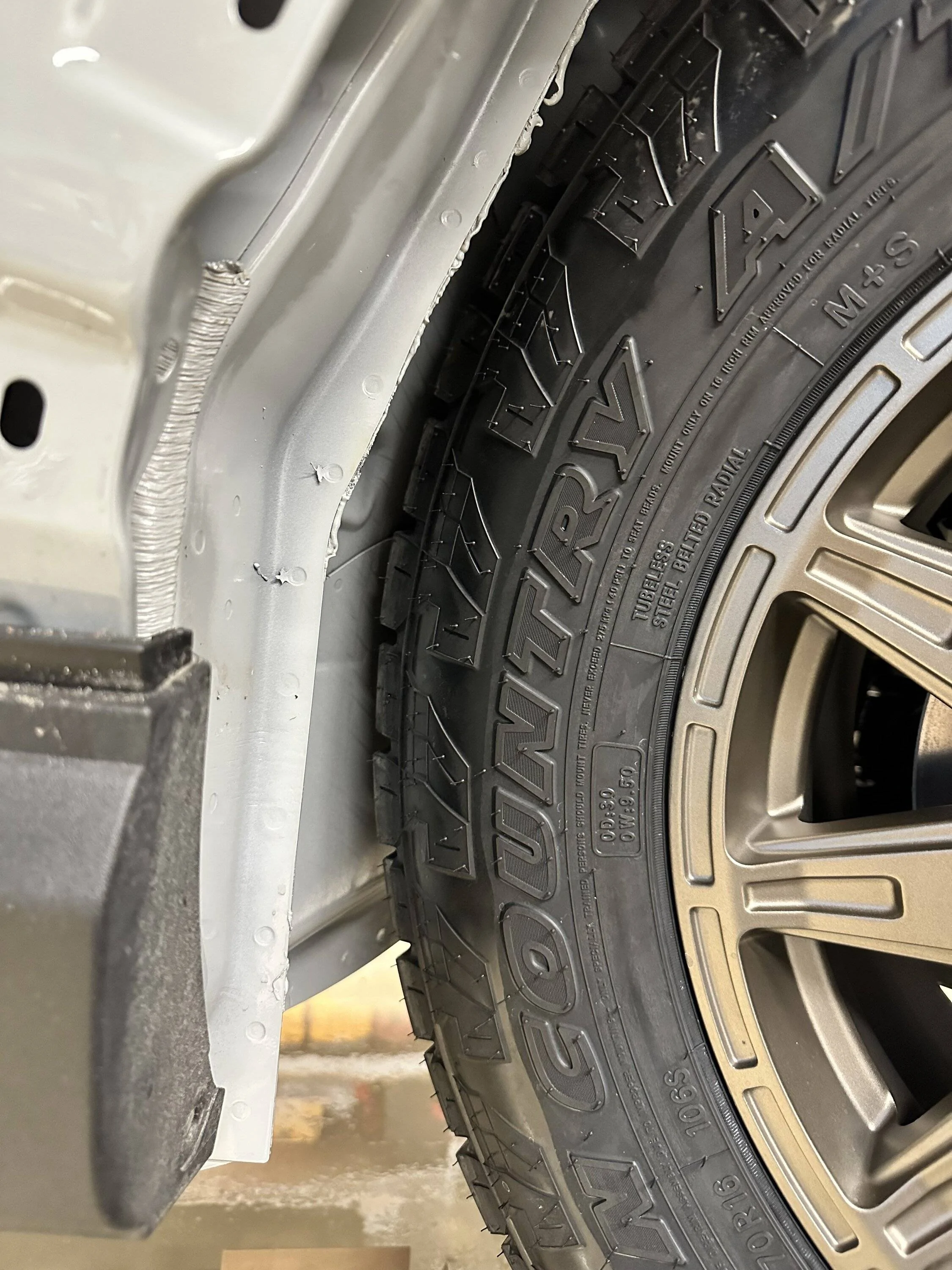

This is part of the thread Meanderthal was referring to. This photo clearly shows the pinch weld.
I think you are going to have a rubbing issue with that big of a spacer and the K02. Moving the wheel/tire out like that puts it closer to the pinch weld (which is the rubbing problem for the BS) when the wheel is turned and the suspension is compressed somewhat.
Here is the pinch weld exposed:
