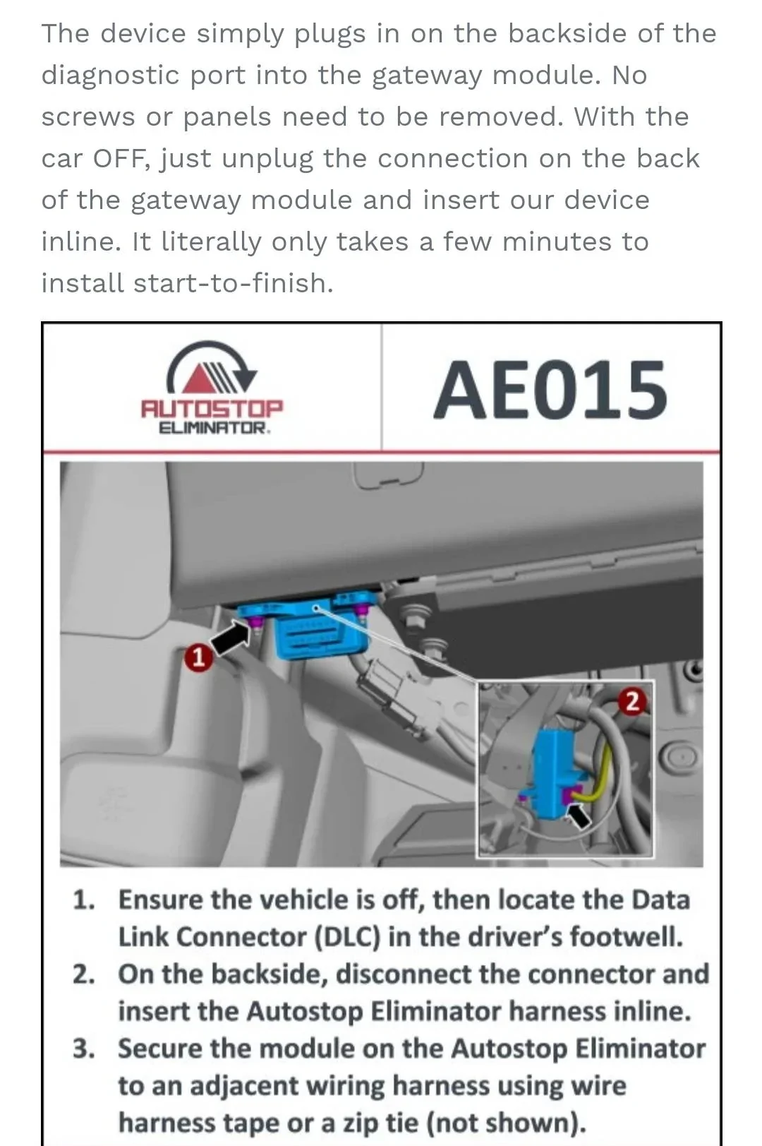

1. Auto/Stop Eliminator install instructions

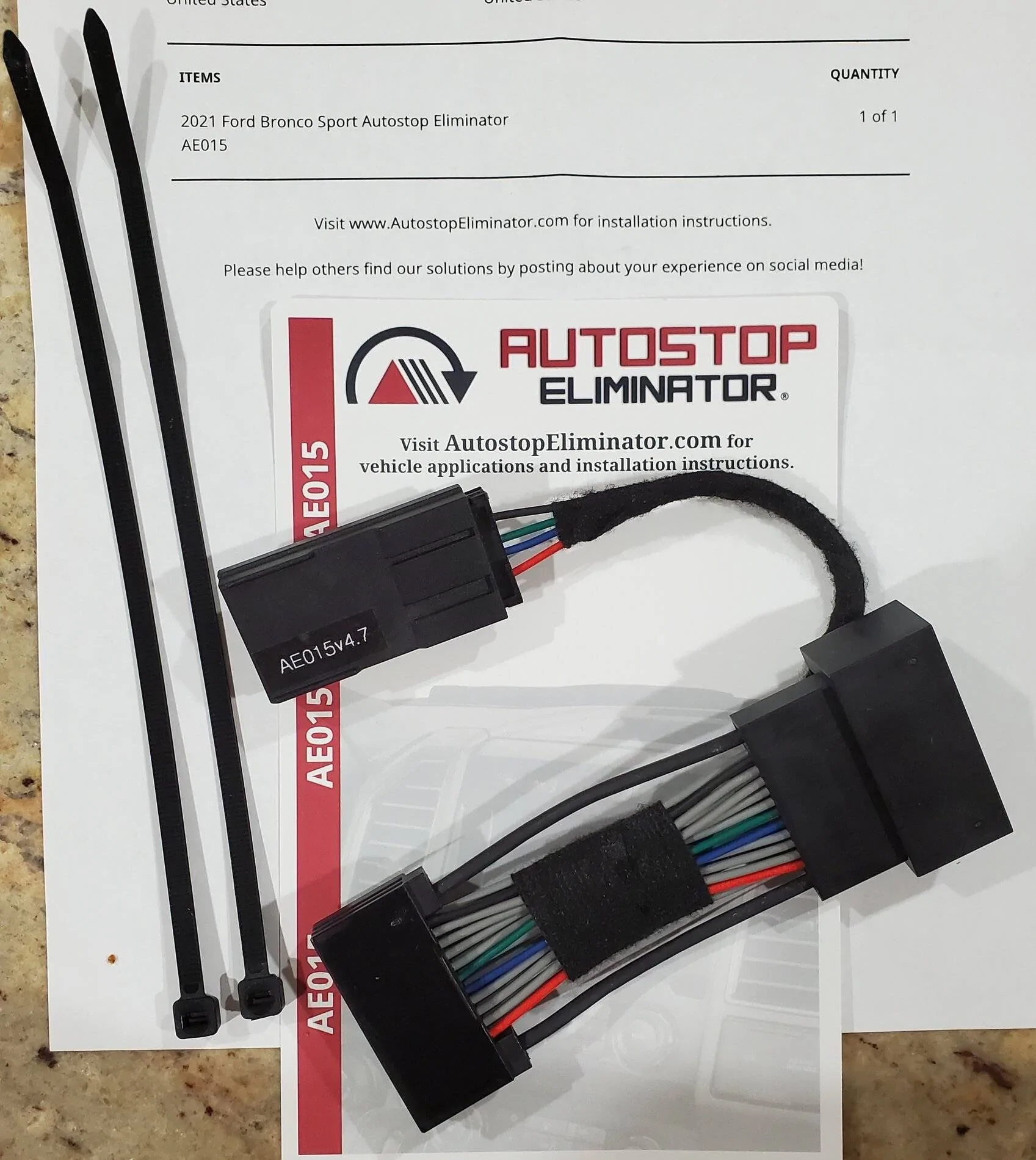

2. 2021 Bronco Sport Kit

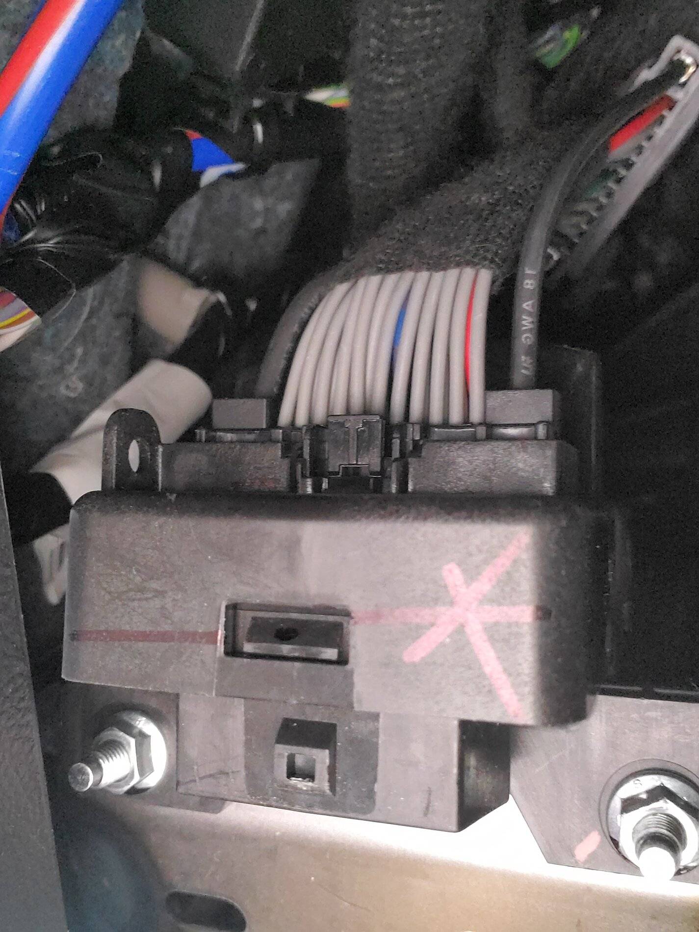

3. Driver's side lower left of steering column for the data port location.
4. Connection of how data plug is attached looking up at. Simply push up on clip to release and pull plug out toward the front of vehicle.

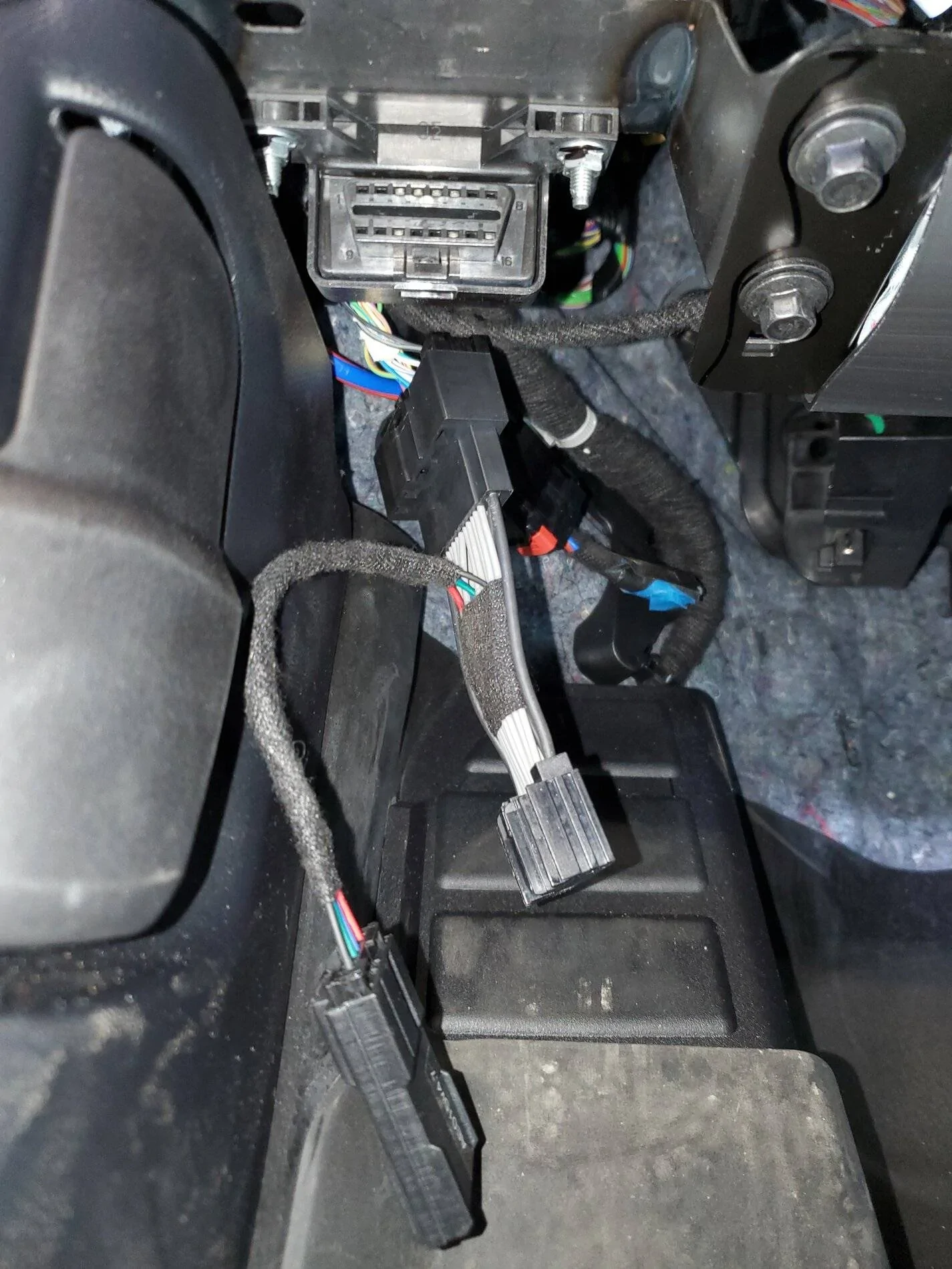

5. Data cable unplugged from data port and ready to install Auto Stop Eliminator.
6. Connect to data cable and be sure when connecting back to data port the securing clip is facing downwards as seen in picture 4. Once connections are made secure as needed with ty-wraps.

I tried to live with the A.S.S. system, but in the end decided, why should I just live with it? So, my husband and I installed the Eliminator tonight. I will say that we had a harder time than the OP unplugging the data plug. Couldn't get the right angle to hold the tab in and pull at the same time. So, we ended up needing to remove the two nuts that are highlighted in pink on the instructions to lower the data port and get a better grip to remove the plug. After a few choice words by my hubby for roping him in to this project on a Monday night ??, we got it done and... voila! A.S.S defaults to off, yay! I really hope there isn't a need to remove it before getting service in the future, because I would rather not do that pretzel bend under the dash again.

Sorry to hear you had a hard time with this. I will say one thing that did help me was a stubby straight screwdriver pushing up on the tab when I was pulling the plug out. I'm not sure if it helped or I got lucky but mine pulled right out. Thankfully.
