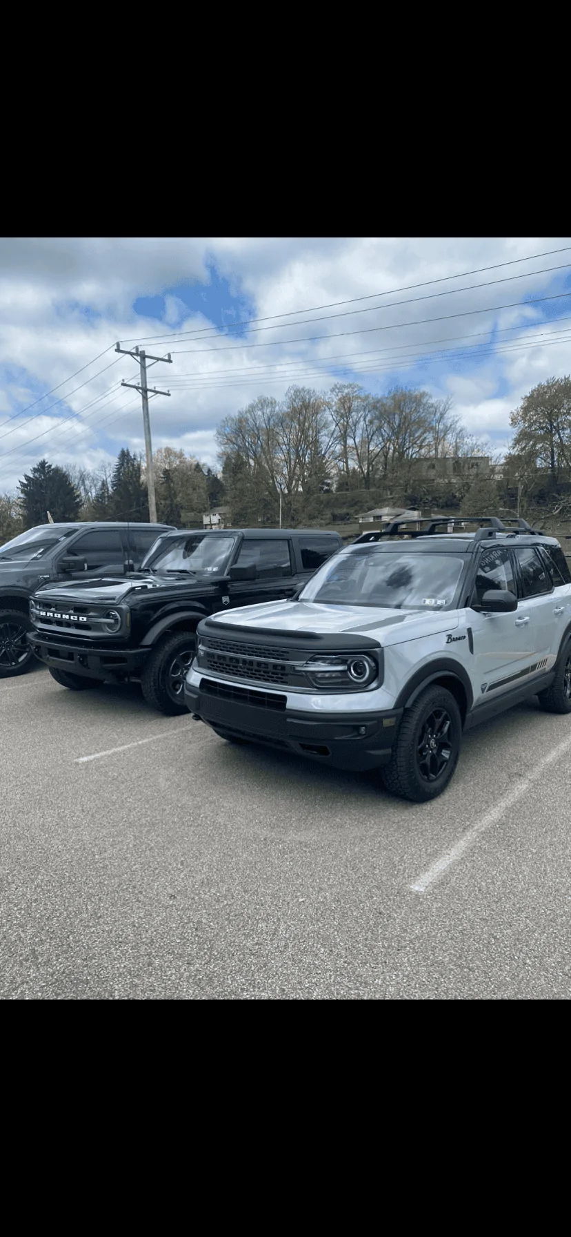

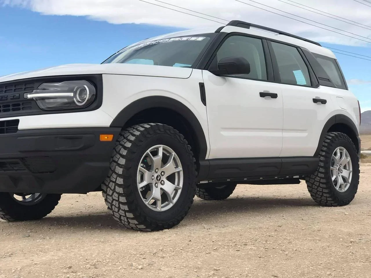

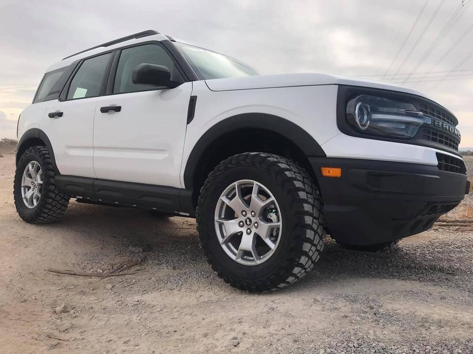

Yeah, I ended up going 245/70 and they rubbed a bit on the pinch weld at a certain angle. Grinded down the pinch weld a bit, no biggie.
Ok good. I want to right away put on 245/70s the week I get mine but it’s too cold out now to do the pinch. I’ll just be careful for a couple weeks until the weather breaks I just love this look!
Ford Bronco Sport Area 51 Badlands with BFG KO2 245/65/17 tires on stock wheels 3FC24C4C-1ABC-44F2-9A5D-DCFF9EACCFE9
Ford Bronco Sport Area 51 Badlands with BFG KO2 245/65/17 tires on stock wheels F907F943-95CC-4A5C-BB6D-9B4F15CC5260

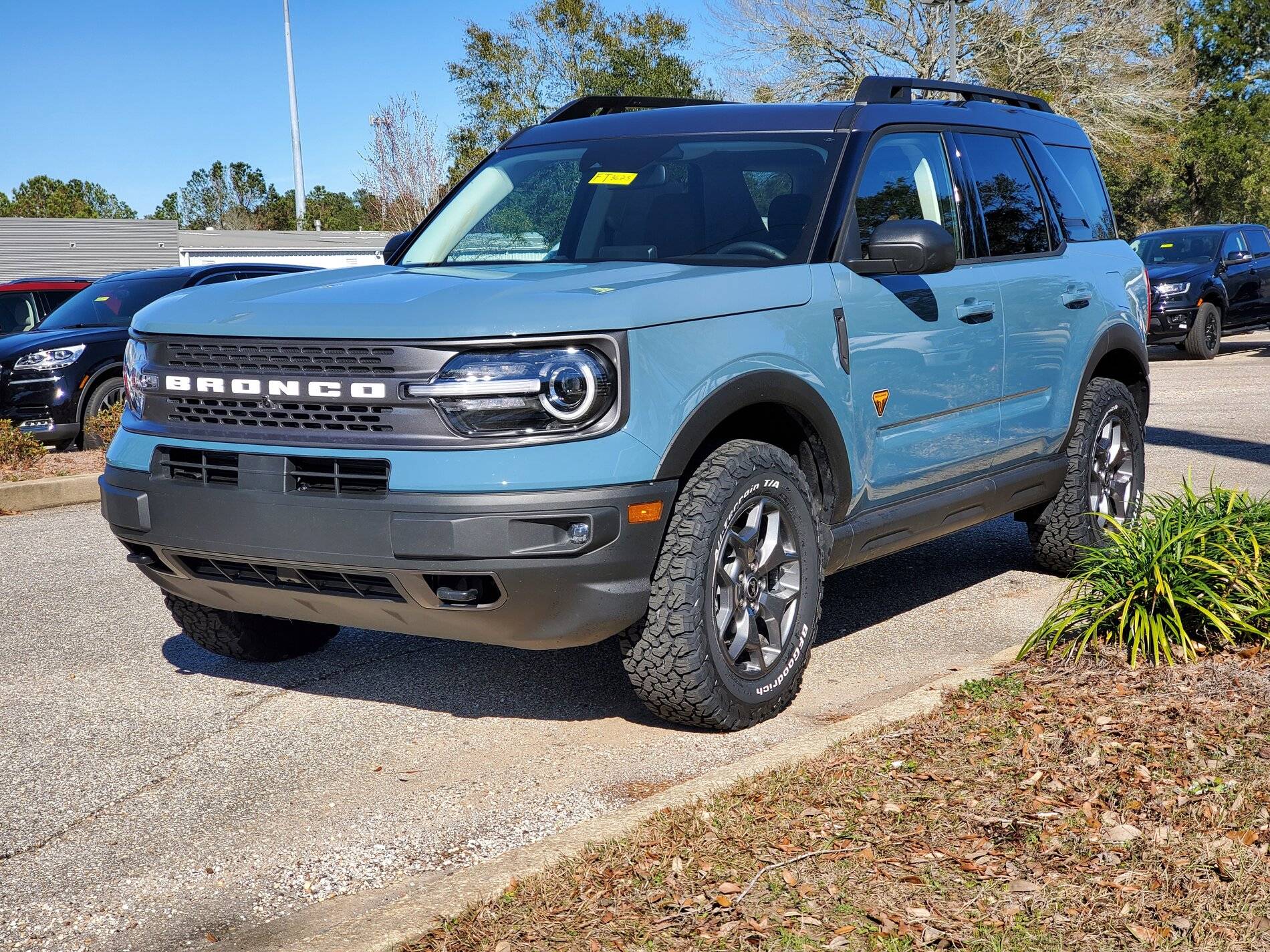

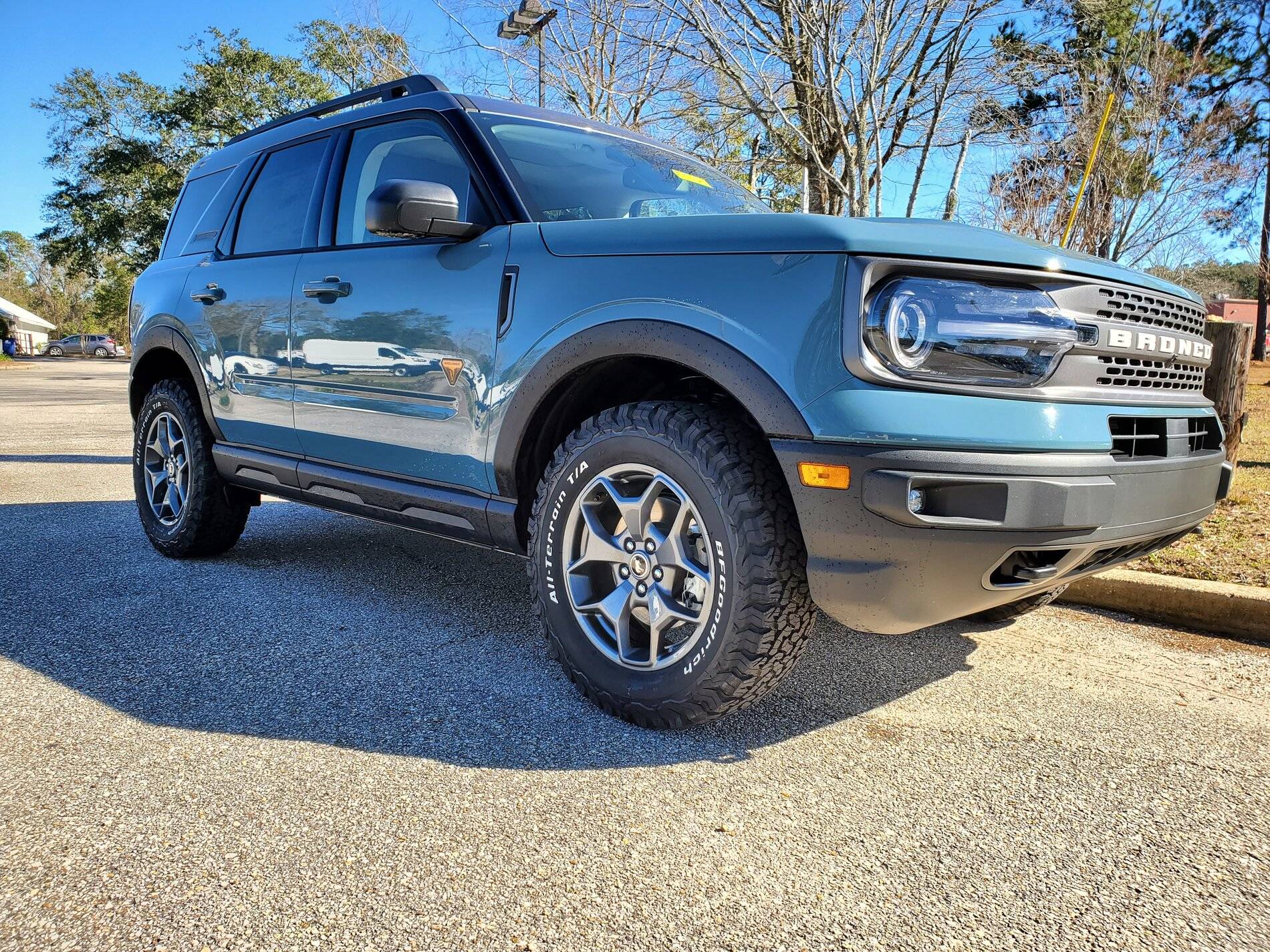

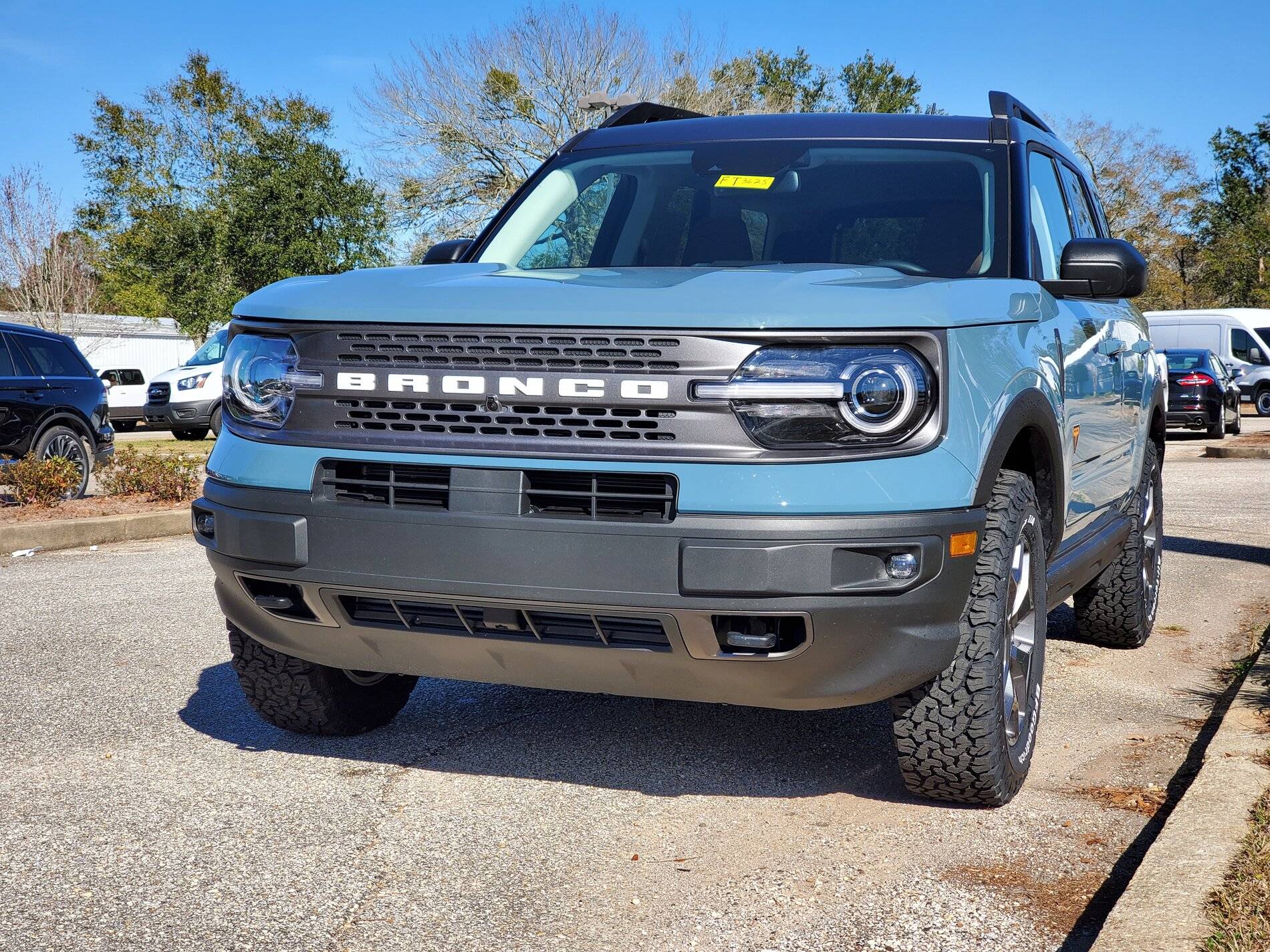

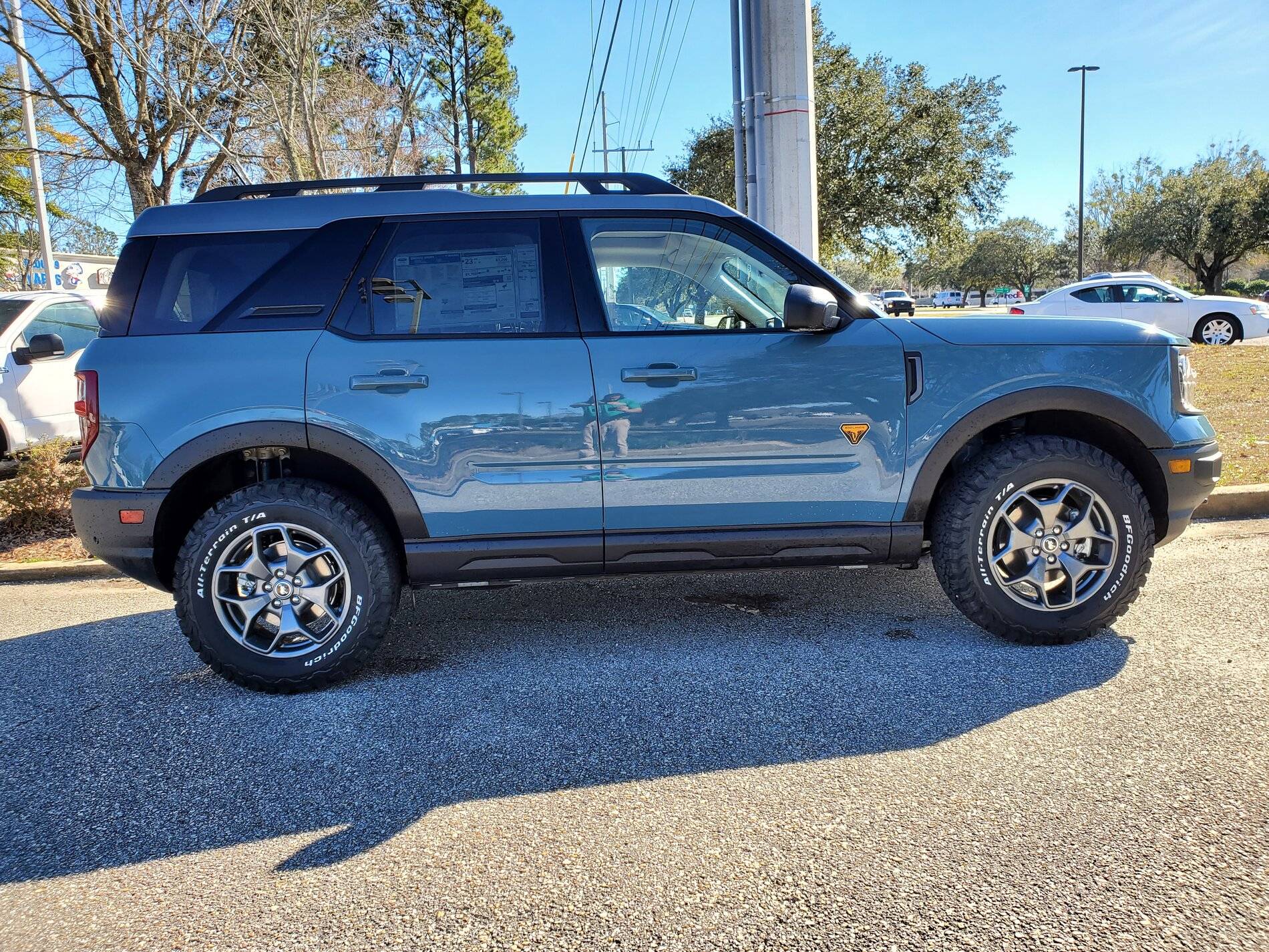

Hey guy just wanted to share some pictures for those who is curious. This is stock Badlands with 17 inch wheels. 245/65/17 KO2 AT tires. No rubbing. Stock suspension.
Ford Bronco Sport Area 51 Badlands with BFG KO2 245/65/17 tires on stock wheels 20210129_134744
Ford Bronco Sport Area 51 Badlands with BFG KO2 245/65/17 tires on stock wheels 20210129_134757
Ford Bronco Sport Area 51 Badlands with BFG KO2 245/65/17 tires on stock wheels 20210129_134823
Ford Bronco Sport Area 51 Badlands with BFG KO2 245/65/17 tires on stock wheels 20210129_134901
I just bought my 2021 a few weeks ago. Was looking for tires because I feel the stock are just too small. I love the ones you got. Are you still happy with them.

Just picked up my 22 Badlands this weekend. Good to know this is a simple option when the time comes.
