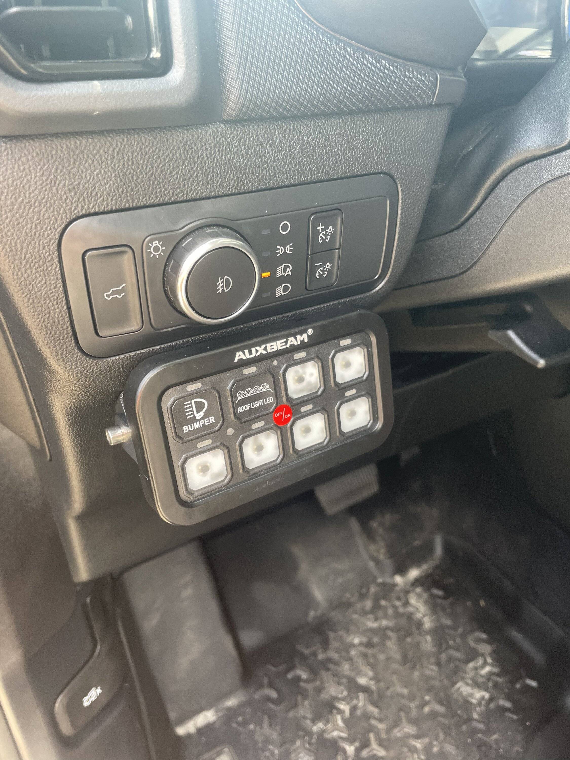

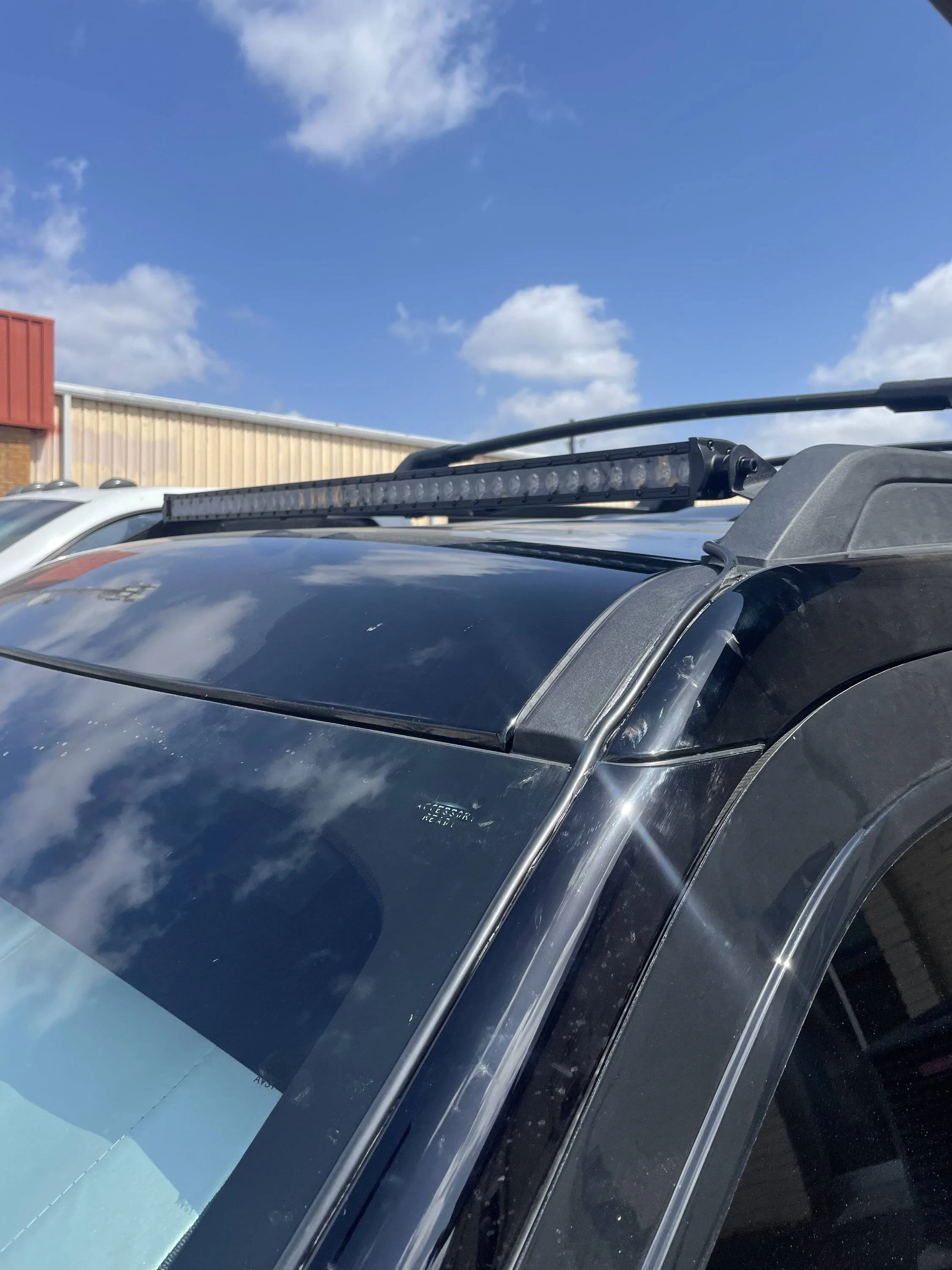

Ford Bronco Sport Anyone install 40" lightbar? 6234D072-9638-4401-BC85-BDC76EEACD1E
Ford Bronco Sport Anyone install 40" lightbar? 77D20088-8B6F-4CFE-882F-0DB2D4C2017D
RC 40 inch light bar run down the windshield and auxbeam switch panel.
