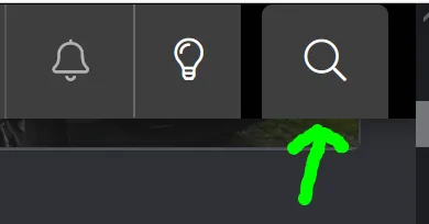

Hit the search button
type in Catch Can
you won't be disappointed
plenty of discussions

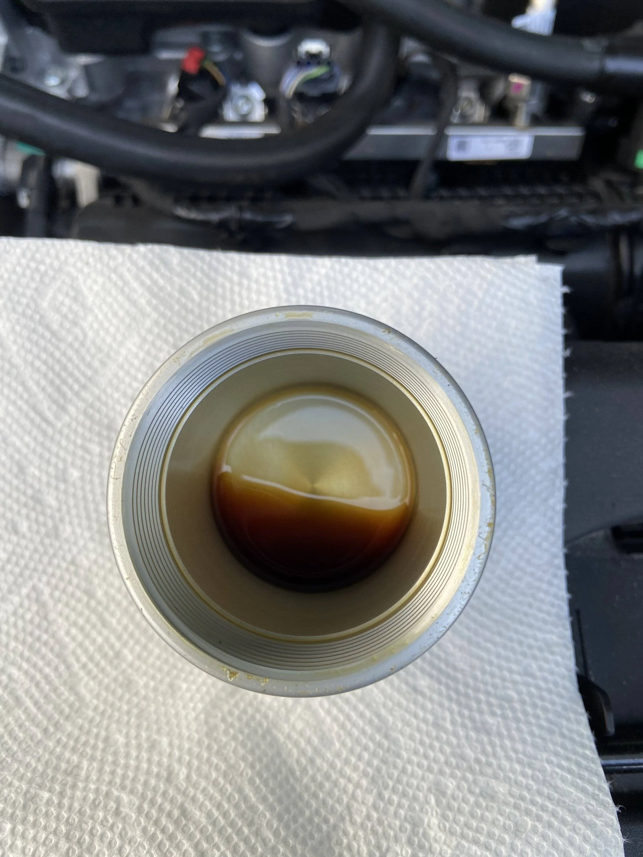

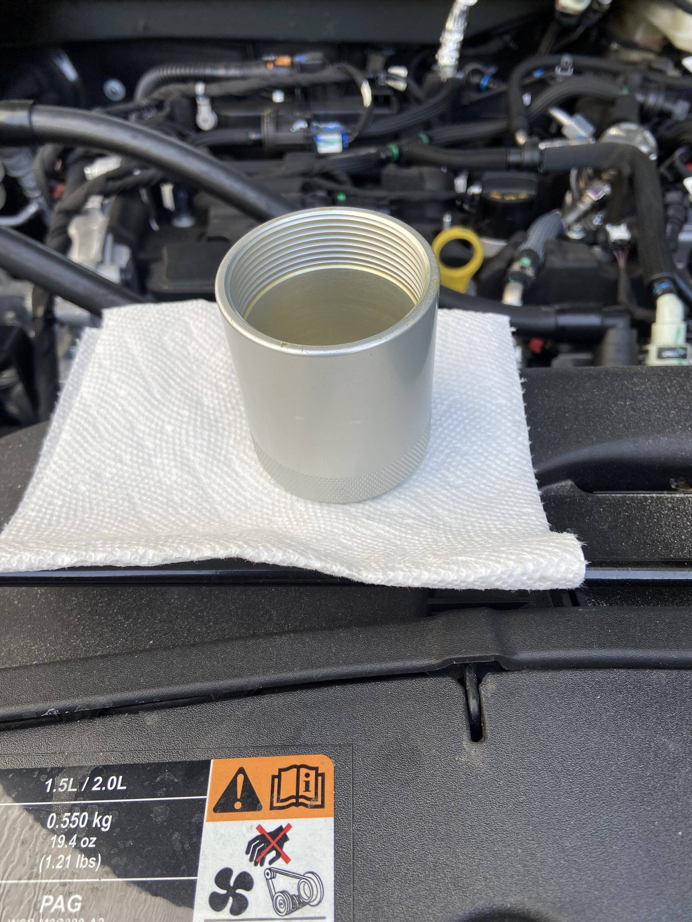

I've been running the JLS (I think) catch can for a year now, I emptied it out a couple times since then and what I get is some thing that resembles coffee with lots of creamer. Does the catch can prevent this from going into the intake, I don't know, but I like to think so.

Coffee and creamer, very small harmless amounts or we’d all have them.
Moisture is burned up in the crank case and vented back for a cleaner exhaust.
Am I right ???
I’ve taken several engines pass 400,000 miles and one to 528,000
Never had one, never had one single internal engine issue other than low compression in the 528,000 mile engine,,, ya think !
But I’m gonna get one anyway.
Go figure.
Marketing gets me now and then.
NOT !

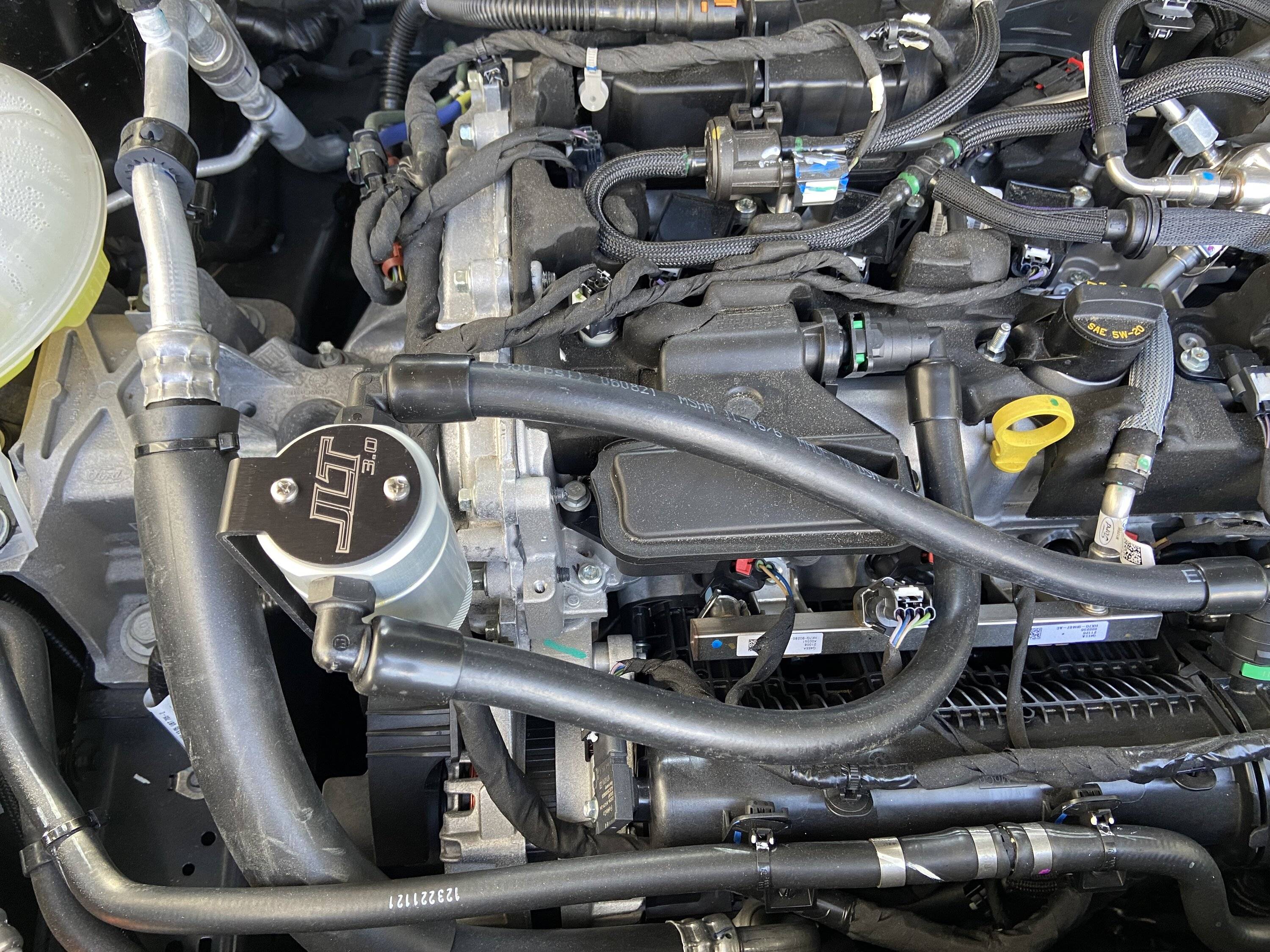

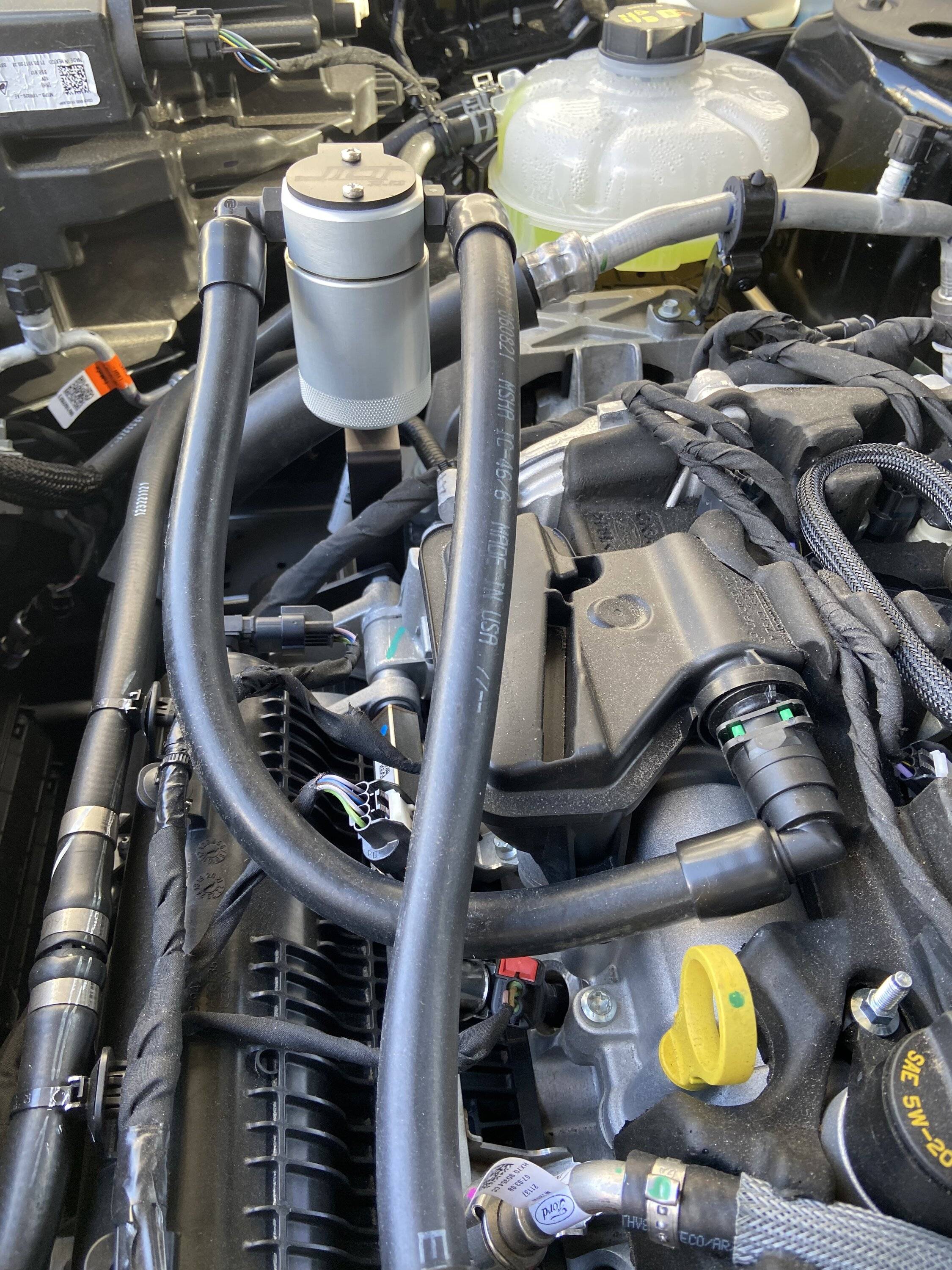

The only thing I don't like about the JLT is the phillips screws that hold the cap on to the bracket, I'll probably replace them with stainless socket heads. Other than that it's a nice product.

There's always the debate if they are needed or really help because of direct injection, etc.. The Sports have oil seperators already on them, they just can't be emptied so is one really needed? Most likely not. I have one on my V8 Mustang and always used them on turbos so I put a JLT on the Sport. It does catch a decent amount of oil so for me piece of mind is why I use one. UPR also makes one now.
