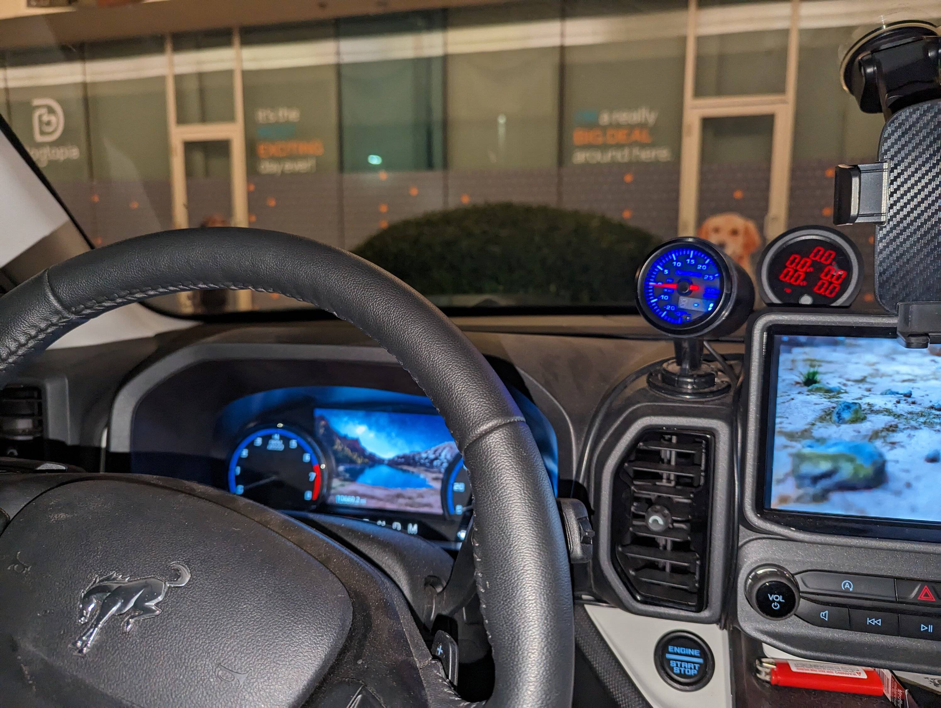

I forgot to post. I have the air pressure gauge installed for the air suspension. It has five sensors so you can have one for the tank and one for each air spring. I couldn't find a good spot to mount it where I can easily see it but it would be kind of out of the way so I just put it right next to my boost gauge. It kind of works though.

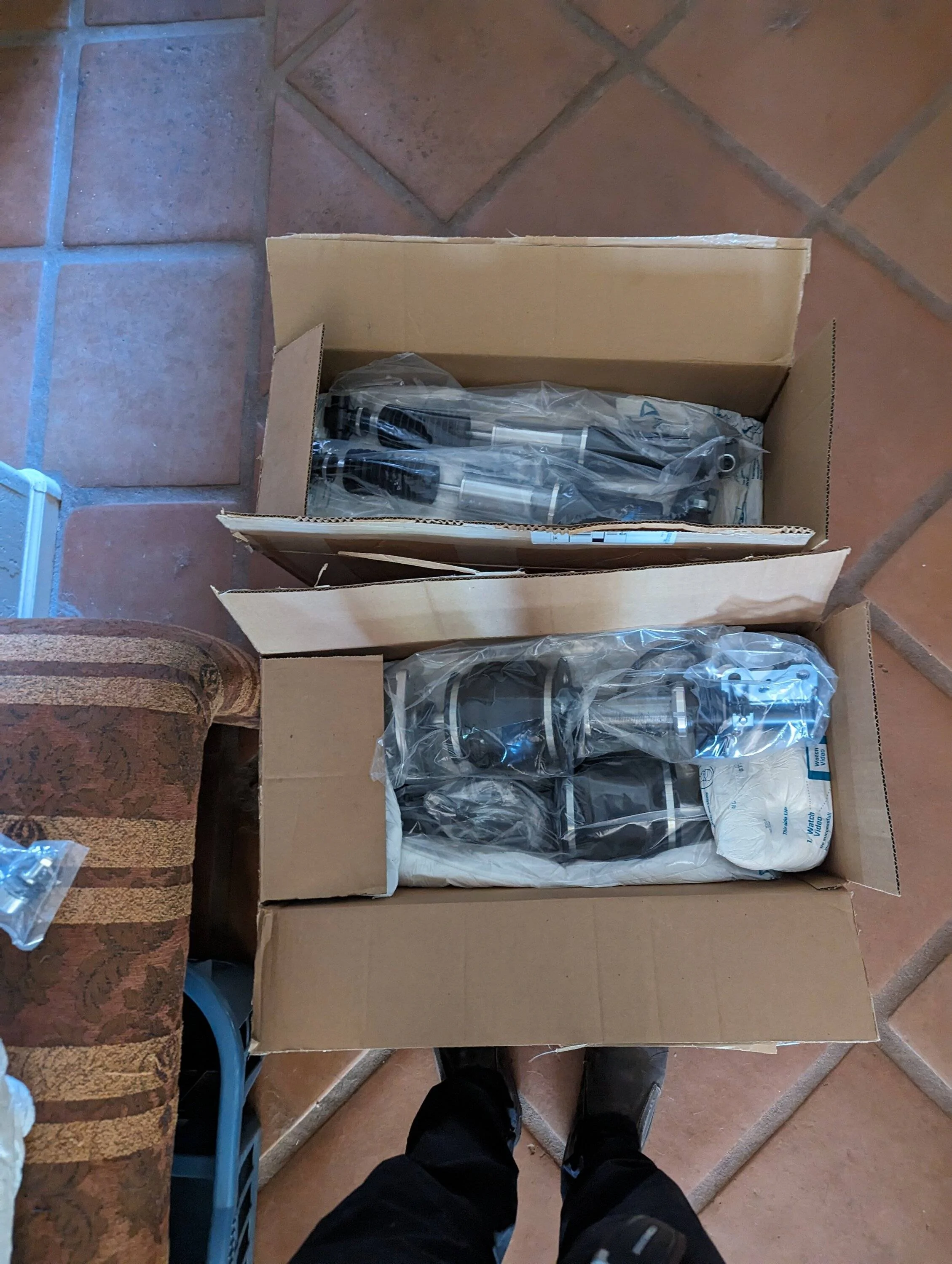

So here's an actual picture of the springs, but it's the same as what they had on the website. I didn't have time last night to do anything yet. I was too tired but I'm going to try and get started on it tonight after work. Hopefully have everything done and figured out through the weekend. They did pack it really good too. I was really happy about that because I would have been really pissed if they've gotten messed up because of bad packing and some careless UPS guy

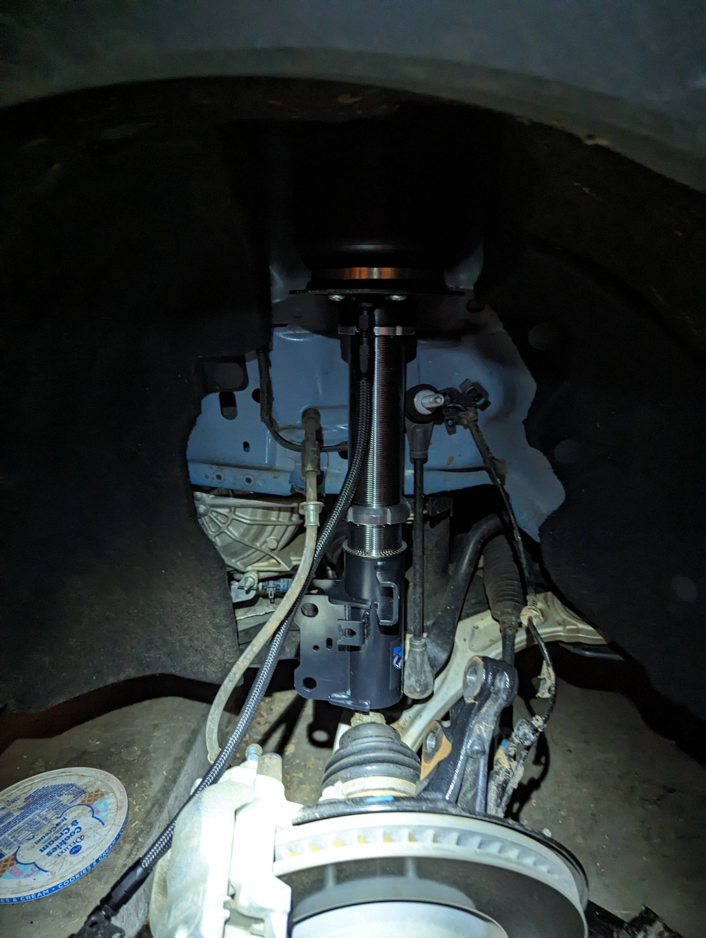

I ran into an issue with the rear air spring mounts. The hole in the air spring mounting bracket is a little small, about half a millimeter, to slide over the lower coil spring rubber locator, so we're just waiting on their reply on what we're going to do. Also, I need to replace the sway bar end links on the front which uses an 18 mm socket which is not in most standard socket kits and of course a t40 torx. So again if you're going to be working on Fords nowadays just buy a goddamn torx kit cuz you're going to need all kinds of weird ass torx sizes. Anyways the bolt holding the sway bar end link to the strut wasn't too bad to get off, but the bolt holding it to the actual sway bar is in a Terrible spot and I might end up just having to cut it off but I'm trying to avoid that.
Also, I could not get the fittings to seal in the tank with just regular thread tape so I had to go to the goop. I'm using permatex high temp thread ceiling and that seems to be doing the job. But again, if anyone does this don't buy that vixen amazon tank that I bought (which really sucks cuz it's the perfect size and has a lot of different fittings you can use on it) and I would suggest getting a good aluminum one from like AccuAir or universal airnor any good brand they're usually only a couple hundred bucks and you don't have to worry about rust. Eventually I will definitely be replacing this tank and then down the line. I'll probably get an automatic controller instead of a manual switch like I have now.
But here's a picture with the front air strut on the driver side front. It went right in. I just used the old strut to get the same length and I'm going to start from there once I get everything on here and working.
Ford Bronco Sport Air suspension PXL_20231016_060814863

No it's going in at stock height not gonna slam it down to the ground. It'll drop but only a few inches, same for going up. And actually it's not done they machined a hole about a half millimeter too small. So I'm waiting to hear how they're going to fix it because you really need a mill or a lathe or something to do it right? I can't just dremel it out or would have already just done it myself. But I will definitely put up some pics and videos when it's done.

Could you not just dremel the hole just a little bigger .5 mm is not much could even be the powdercoating is a little thick. Could you post a pic of the offending part.
