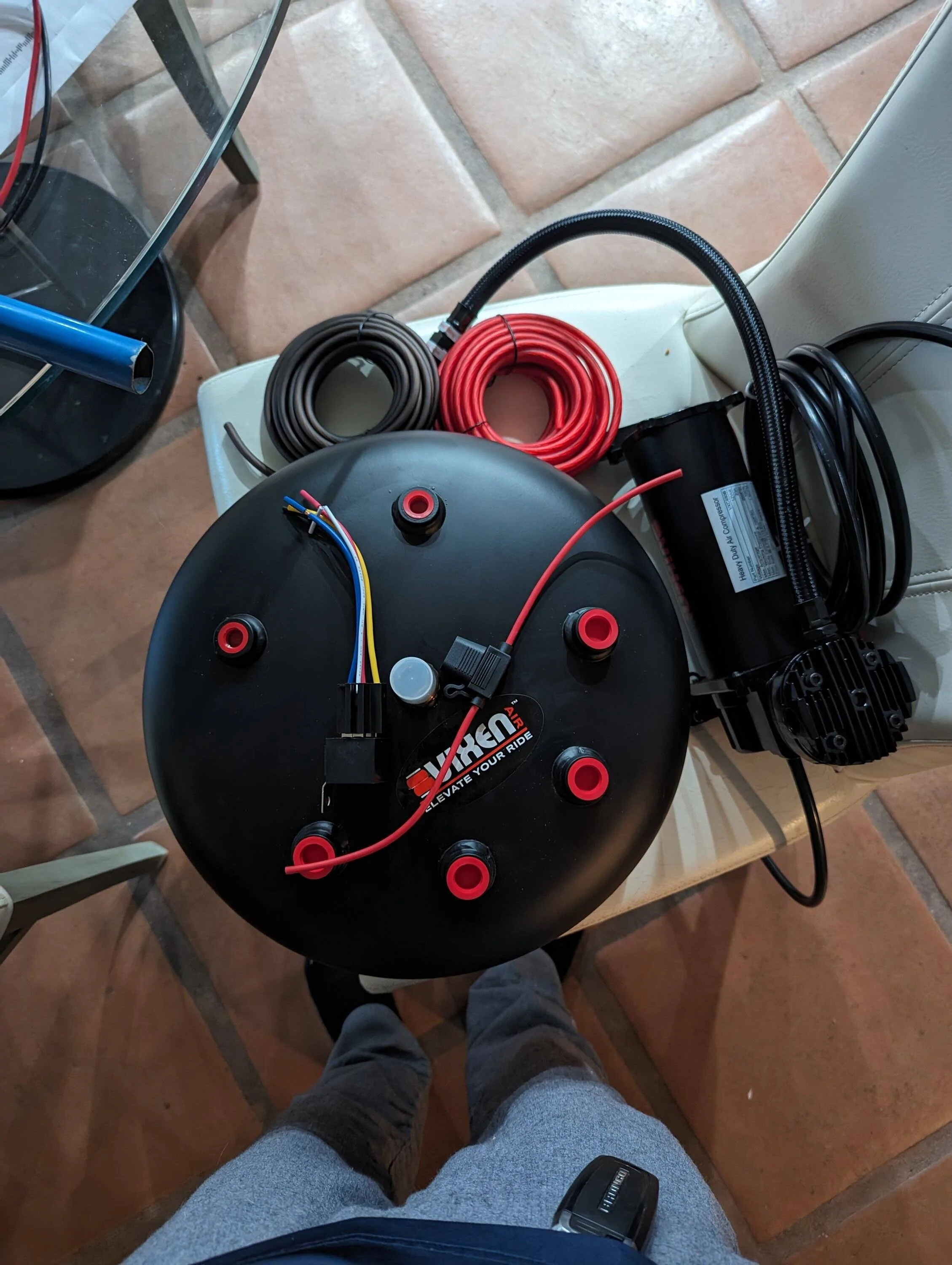

I've decided to finally add an air hose so that I can inflate my tires with it and run air tools.
I just had to order a 1/2 inch to 1/4 inch adapter because the only holes I have left in my tank not used are half inch ones. And they only sell them in packs of two but that was only like $8 and then I ordered a six foot airline to go from the tank back around the air compressor and stuff and then have it sticking out of the floor so I don't have to drill anymore holes which was about $15.
Then I can just connect my recoil air hose to it but when I'm done it'll just leave a foot or two of cord hanging that I can tuck away and I can disconnect my longer recoil air hose. I'll put a pick when I'm done.

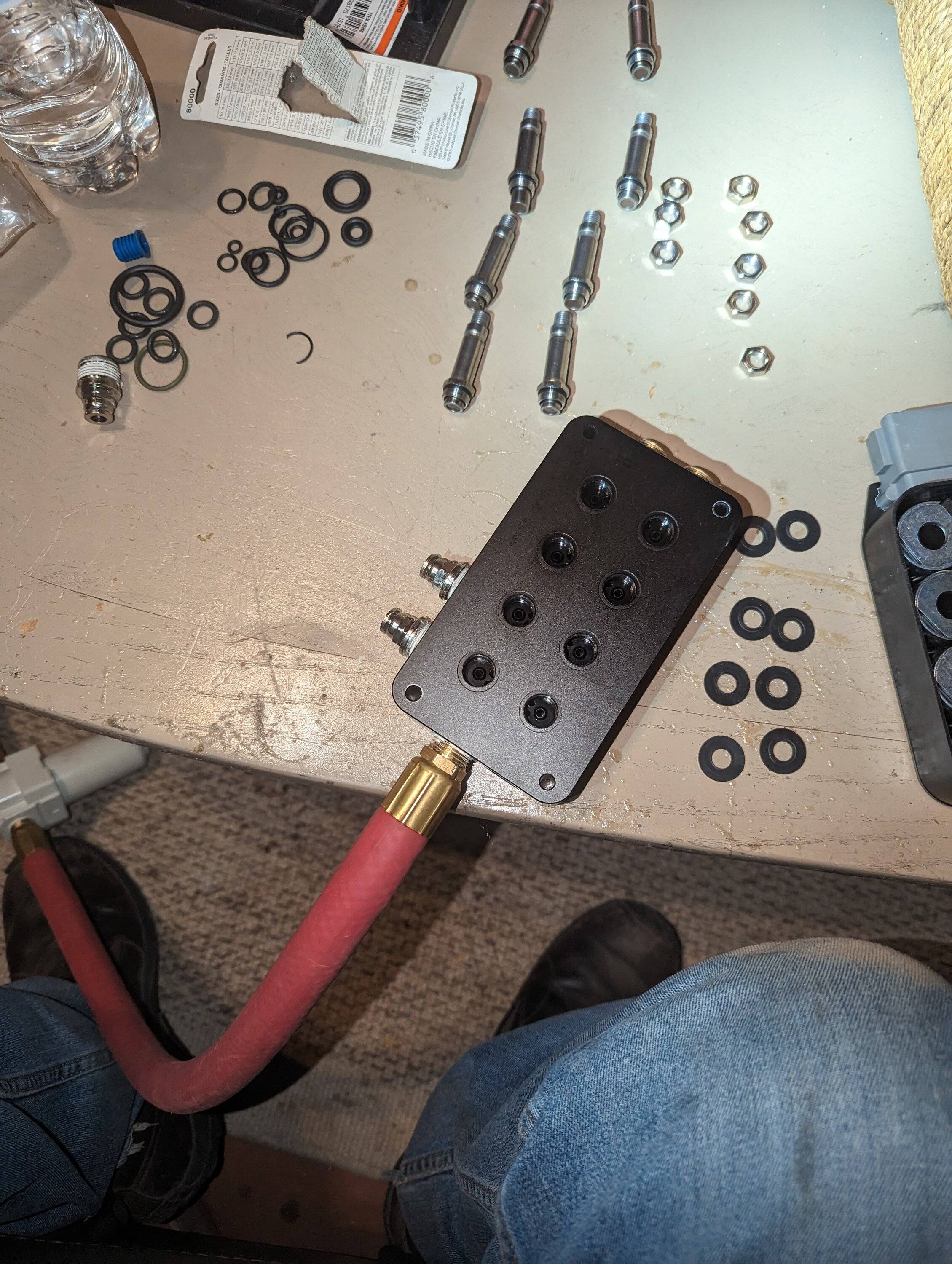

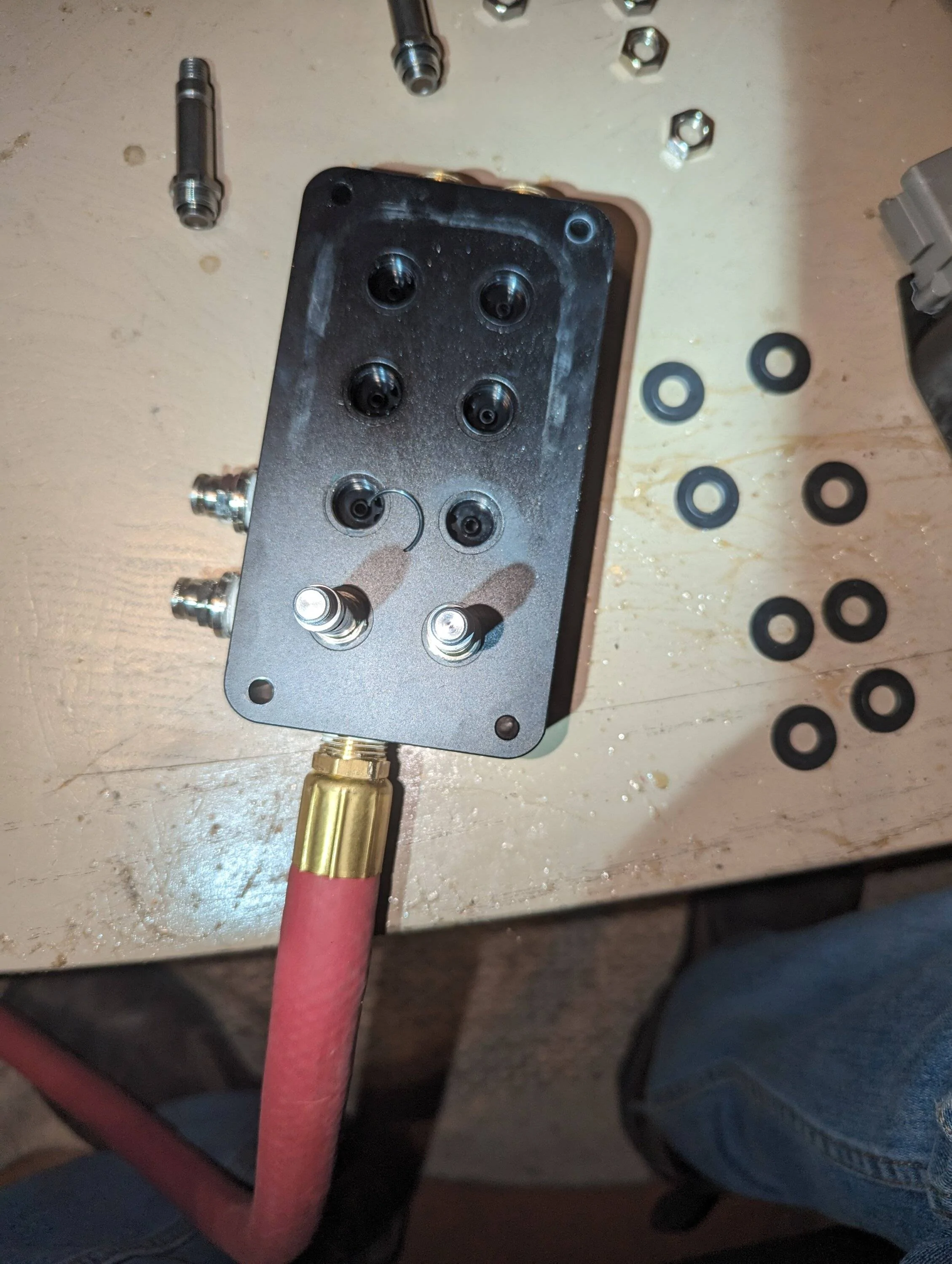

So I finally got down to trying to figure out that slow leak and it turns out one of my valves had a broken o-ring so I'm hoping that's the issue. But I also found some crud in there. I took the whole valve body apart in case someone wants to see what's inside these things.
I'm going to try and cleaned out the best I can. Look for any other issues. You can tell that it's not drilled with as much precision as a brand name would be but hopefully when I put it back together there won't be any leaks and it'll save me 450 bucks

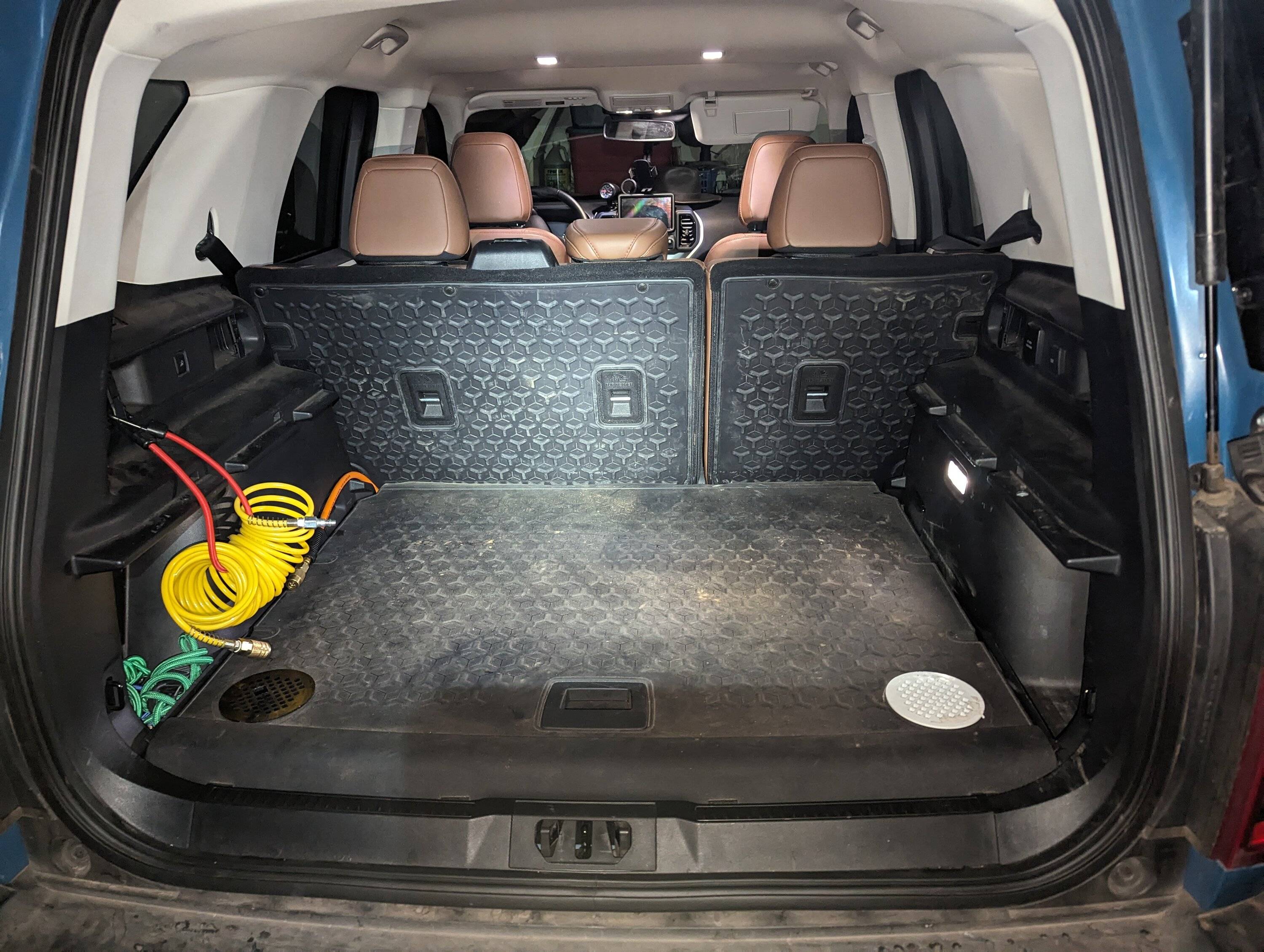

I had some family stuff going on so I didn't get to finish. This is soon as I wanted but I took one of my plugs out of my air tank and hooked up an air hose to it. So I can now run air tools off of my air compressor set up for my air suspension as well.
