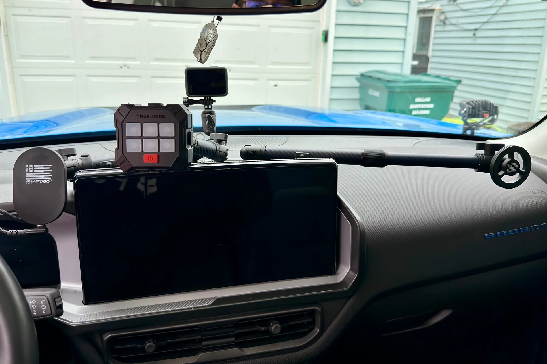

I added to my dash mount today, and now have a mount for my wireless trigger
Ford Bronco Sport Adding second battery to power exterior lighting IMG_5501
I still have to decide on what additional lights I’m looking at adding, but my plan is to make the connections for those as accessible as the OEM connections, albeit, a little less hidden in the wheel wells. 🤣
