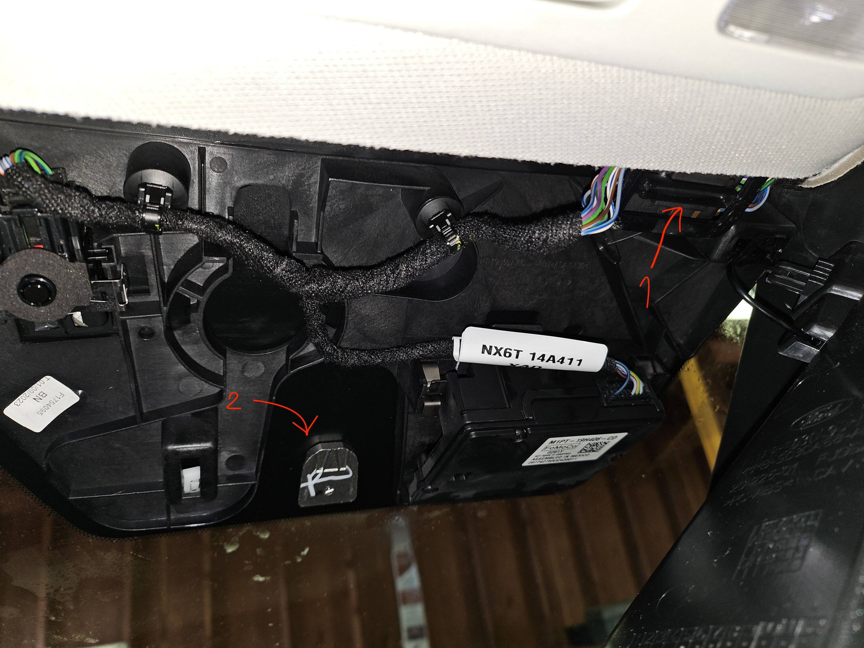

For what it's worth I'll share my experience on this. My Badlands didn't have an auto-dimming mirror but has Copilot 360+. So I loosened the torx screw holding the mirror in place and removed the plastic cover/panel (I used a plastic spudger). The wiring harness Dark mentions connects to a main harness right there (1 in the photo), also shown in Kachadurian's 3rd photo. No need to remove anything else. I ordered LX6Z-14A411-BD because it was in stock (and cheaper) - it works great (not sure what the differences are). It basically has three additional wires and the extra connector for an auto-dimming mirror (switched 12V, ground, and something else - I read somewhere it was reverse but I couldn't confirm). No need to drop the headliner. The mirror mount is labeled in the photo (2) for perspective. I didn't take pictures of the new harness.
