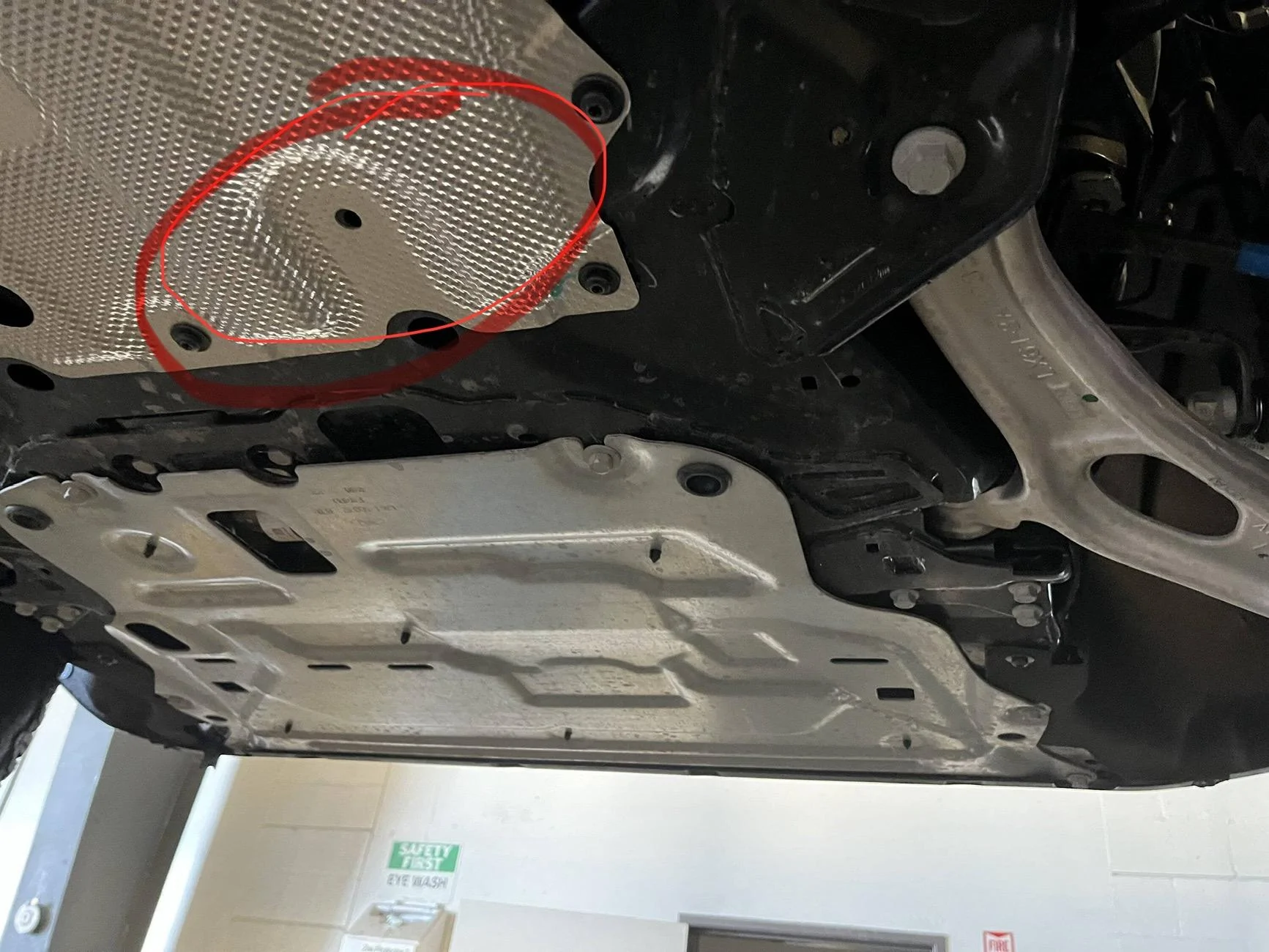

Can someone please tell me or show a pic of where this is so I can check if it is clogged? It is running down to the floor mats and not a drop coming outside to the ground d. I’ve read other posts about this but no info on where the drain actually comes out at. And how to get to it if not evident.

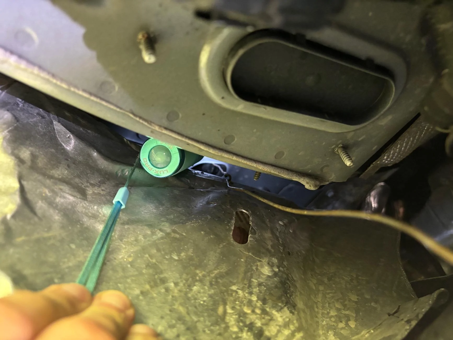

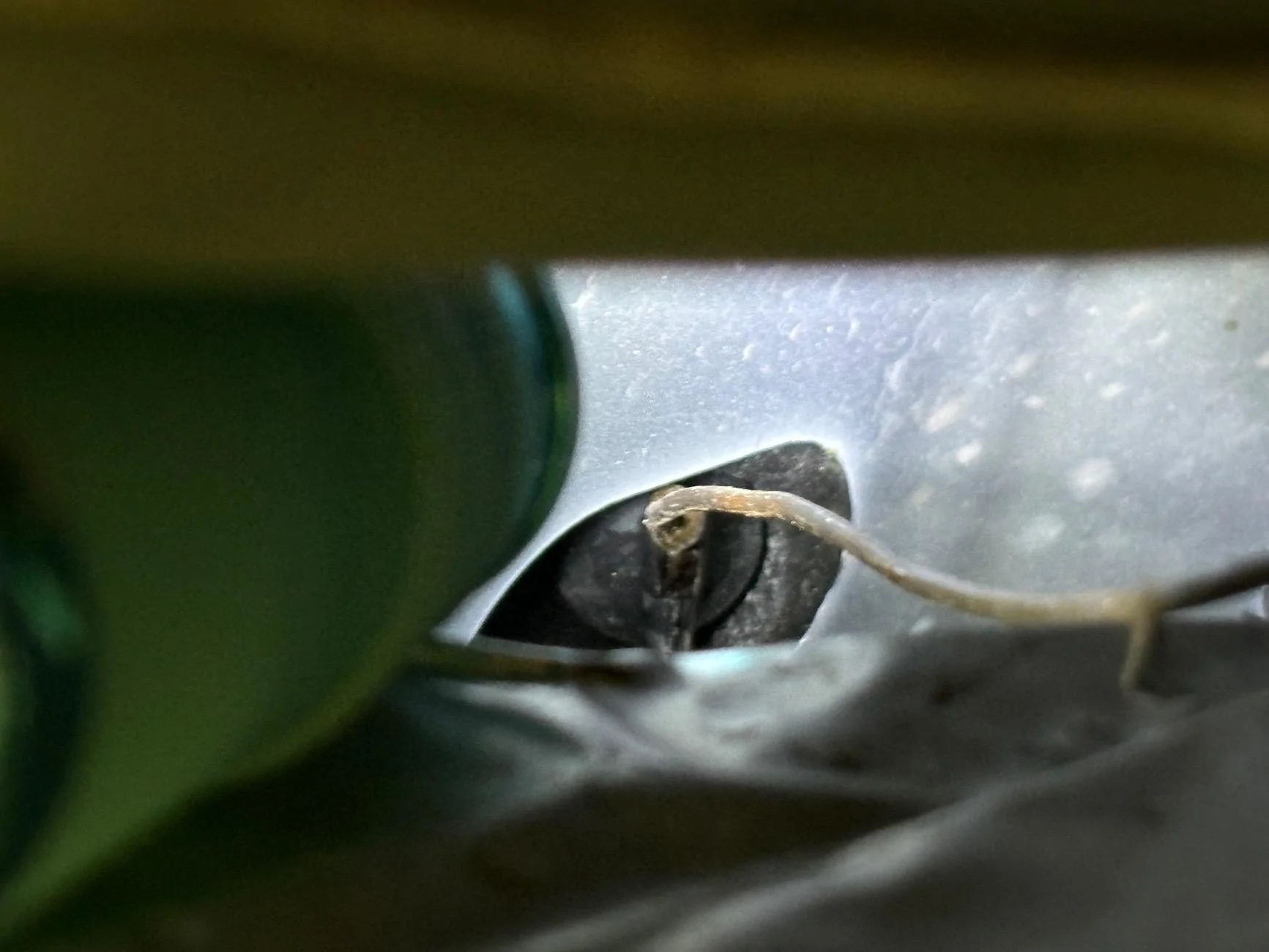

FOUND the AC condensate drain opening. And poked a coat hanger in there to free the clog that was causing dripping condensate into my floor boards.

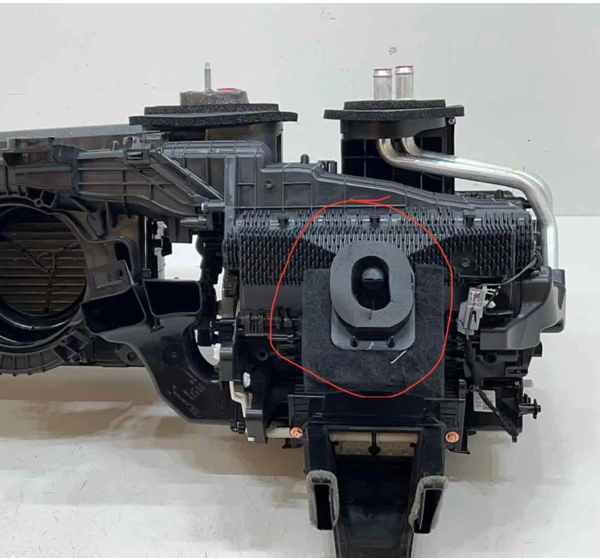

It’s not a line but small pinched tube off the core.

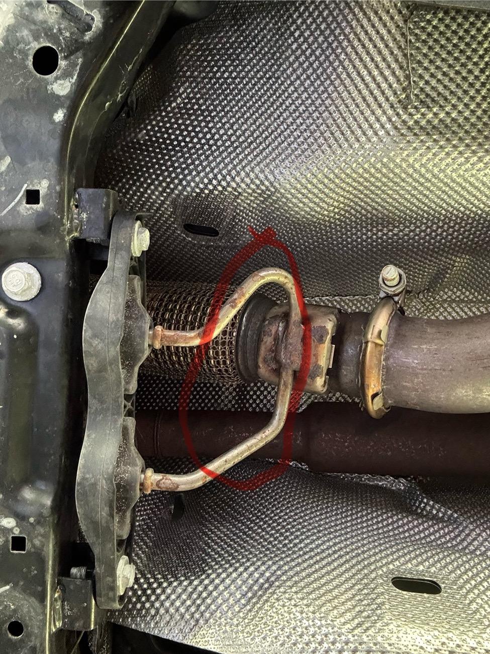

That drains down onto the heat shield above the beginning of the muffler. Under the vehicle take the circled cover plate off. The opening is behind the shield where the u shaped muffler bracket is. Undo a few nuts that are holding the heat shield in place on the right axle side. Pull it down as best you can and you should see the opening at the top of the hump the muffler runs down. I shoved a flashlight in there to hold it back. Poked it with hanger and water all came out. Weird design but not too too much of a pain to fix. Didn’t seem like it was anything clogged in there more so the pinched off tube sealed itself up.
