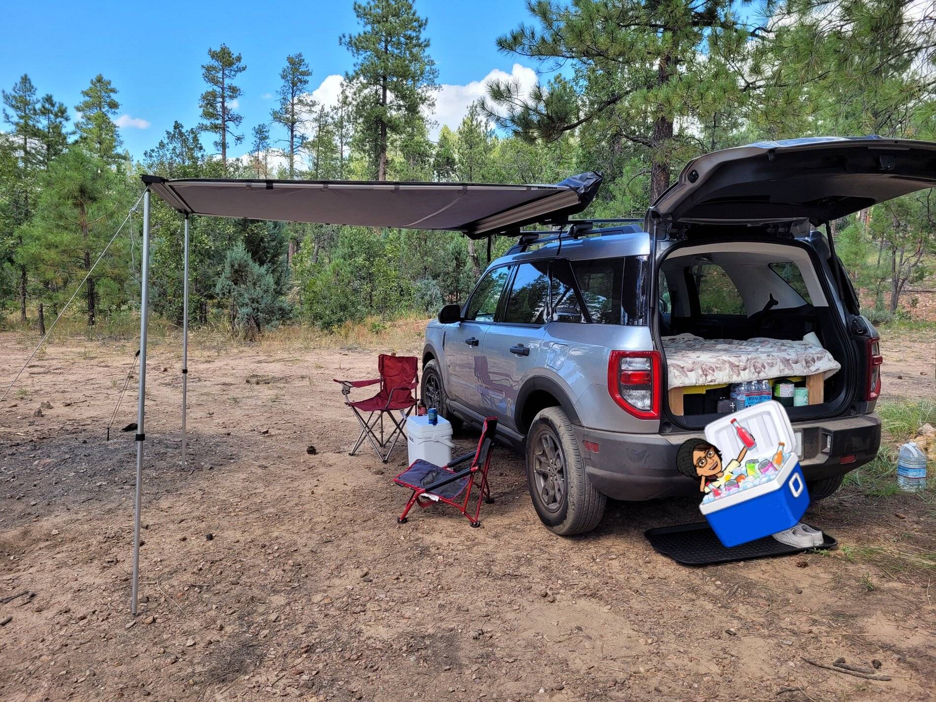

Nice! What’s your gear for the awning and rails?

The awning is the Yakima Slimshady 6.5' and the rails are Yakima Jetstream on Timberline towers.

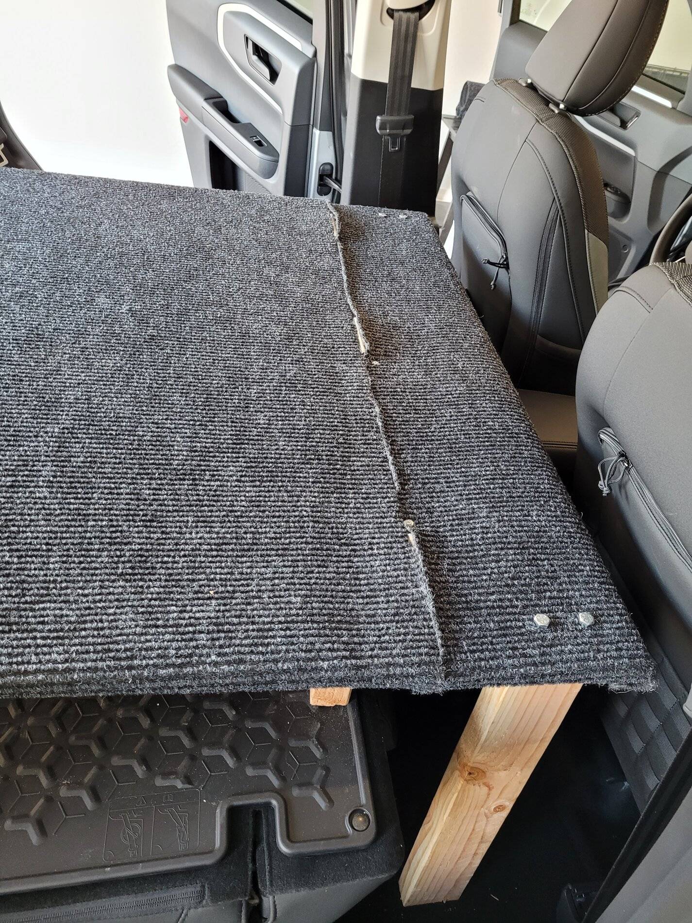

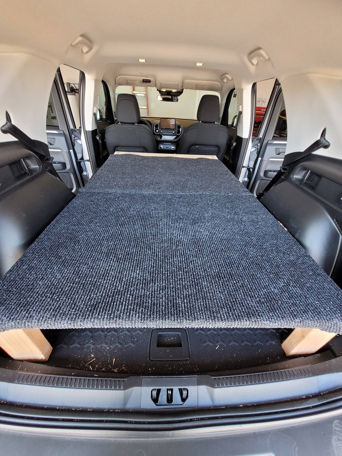

Here's some images of the platform. I used a sheet of plywood, 2x4s, outdoor carpet, wood screws, and a hinge for the head section. With the head section up the bed can be laid down with the seats in a normal driving position. With the head section (8 inches) down the seats must be pushed forward. Both sections can be stored in the back to utilize the 2nd row seating.

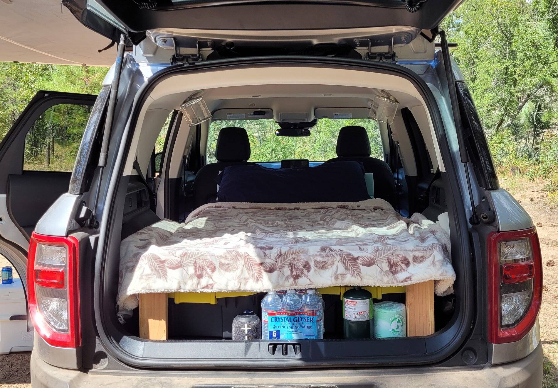

For the interior we used a 2" twin mattress topper I got for $30 at Walmart. I also got two storage bins that fit nicely under the platform. These stored pretty much everything but our cooler and clothing. A couple blankets and our pillows. Both of us had a restful sleep and our dog did well sleeping at our feet (it was her first time camping). I had concerns about being able to open and shut the hatch from the inside. Both are not an issue, although to open the hatch I had to utilize the double press key fob button. Having some space on either side of the bed was nice for storing things you want nearby when sleeping (water, light, toilet paper, etc).

So in the last picture the upper/forward section is folded back on the rear?
