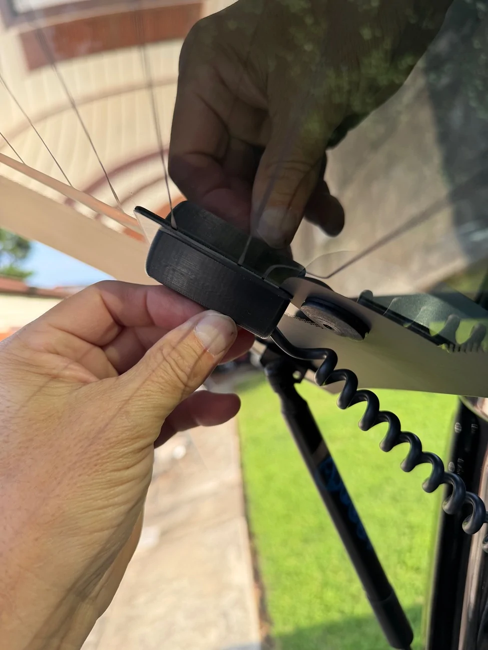

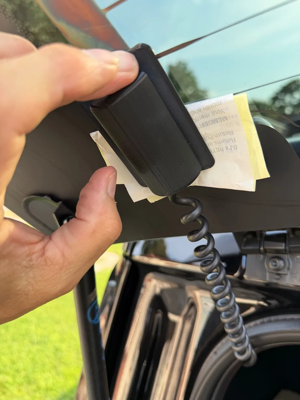

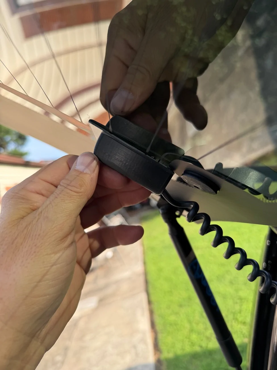

I found this rear defroster wire protector on Amazon and used it as inspiration to create a 3D-printable version:
https://www.amazon.com/Jimen-Compatible-2021-2023-Windshield-Protector/dp/B0C6XPHBP5
The model prints in two pieces, requires no supports, and attaches with automotive double-sided tape. I printed mine in PETG for better heat resistance.
If you'd like to print a set, you can download it for free here:
https://www.printables.com/model/1776220-ford-bronco-bronco-sport-rear-window-defroster-wir
Feedback and suggestions are always welcome!
