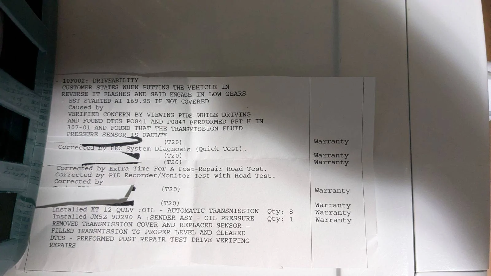

yea so i bet yours is the same issue as mine here ill post my ticket and you send it to your dealer mine had 46k same issue mine was transmission pressure sensor its internal in the trans i just got mine back friday and traded it in today back to a 24 wilderness crosstrek has 8 miles on it insurance is 20 bucks cheaper and month went from 8.5 to 3.9 interest and payment went down. cant complain here i had to go bronco since i couldnt find one a year ago but im good to go ill attach what my dealer found so you can show them. may take a few hours my phone is dead atm

f150 has there own problem check out my service report take a picture and show ur dealer maybe this help let meh know if you dont mind if this helps you i think ur dealer might not have
good techs. i blank out my techs name but heres a copy of mine i had same issue as yours
