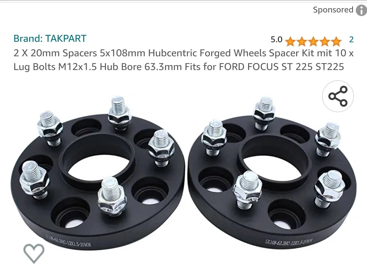

May seem like a dumb question, but will these spacers fit my 2023 brocnco sport big bend? I dont want my stock tires sticking out obnoxiously, but a little to give it a bit more aggressive look. I will be installing the 1.5" lift and bigger tires come winter here in canada.

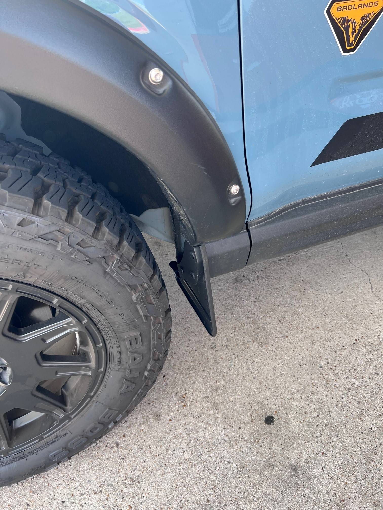

5x108 should fit as far as I know. Damn thanks for posting these been looking for under an inch spacer. I have a negative 30 offset with 8in wheel. If your running the stock wheel it should work fine. My wheel now gives me about 0.9in (22.6mm) of offset and I have no issues with rubbing my 245/65/17 KO2s stock height on big bend.

Not knocking your use of these, but just remember any time you do something that changes the scrub radius you affect your vehicle's designed drive parameters. When you push the wheels out past their designed spacing you create a positive scrub radius that will affect wear and create more unstable braking, particularly in a front-wheel drive vehicle. The steering will feel heavier too.
