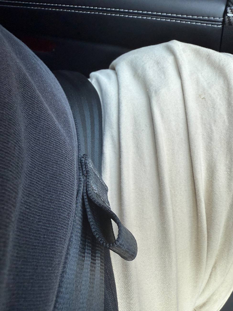

1. Can anyone tell me what this loop is designed for, or its use?
2. How can you kill the belt chimes, I know in my other Ford products you could do a seat belt lock and un-lock trick like five times in a row?

The loop on the seatbelt is for energy absorbtion.

The loop is not for energy absorption. The loop is to keep the male portion of the seat belt buckle from sliding down to the floor.
Thank you for this information odd thing is I traded in one of the three 2025 to BS I own and upgraded to a 2025 BLSq and it has no loop in this one but my 2025 Outer Banks and traded in Big Ben did.
