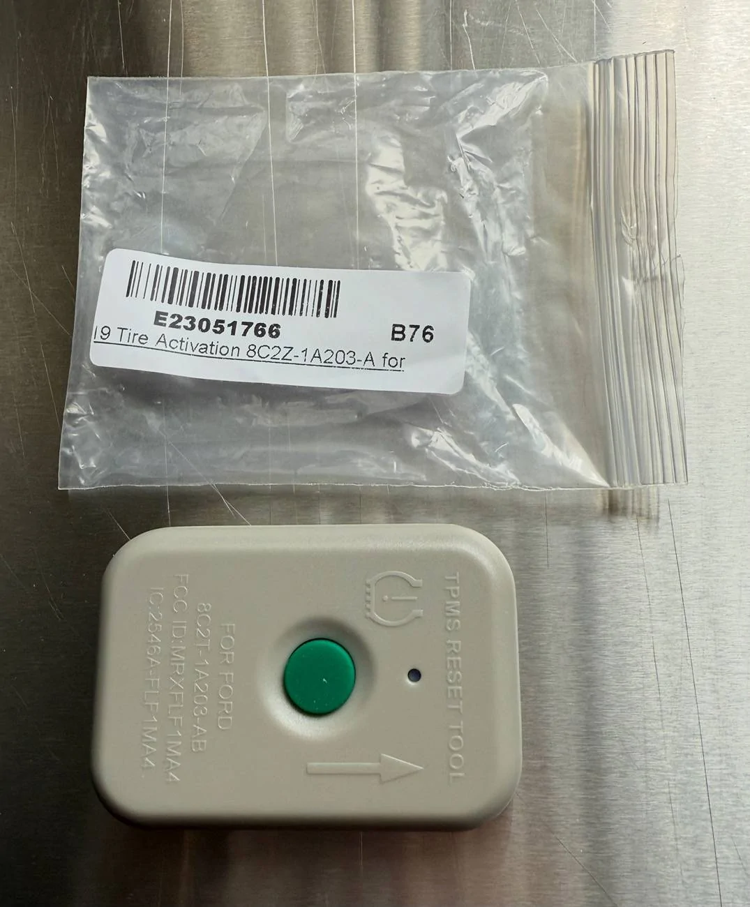

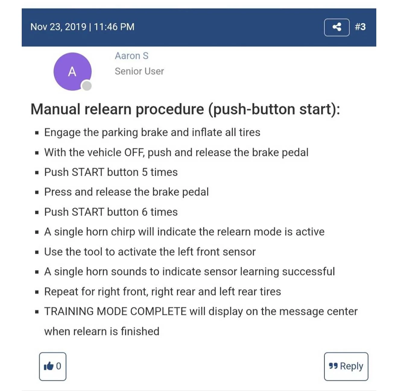

I bought a Ford TPMS tool and did the reset/relearn thing myself because Discount Tire didn’t do it when I bought the new wheels and tires from them. A forum member sent me the procedures and the tool was like $20. See below.
Ford Bronco Sport 2025 Bronco Sport Badlands tpms IMG_7218
Ford Bronco Sport 2025 Bronco Sport Badlands tpms IMG_7246

Yeah I'd definitely go with the $20 Ford TPMS tool route like rorlow mentioned - way cheaper than paying the dealer to do it every time you swap wheels.

Totally agree! I wonder if the tool works with both 315mhz and 433mhz TPMS ?

Hi, sorry to bring up this old thread. OP, did you end up going through the instructions above to setup the new TPMS on your new wheels?
Yes, followed instructions using the tool, took less than 5 minutes. Highly recommend the Ford TPMS tool, $20 bucks worth having in the tool box :thumbsup:
