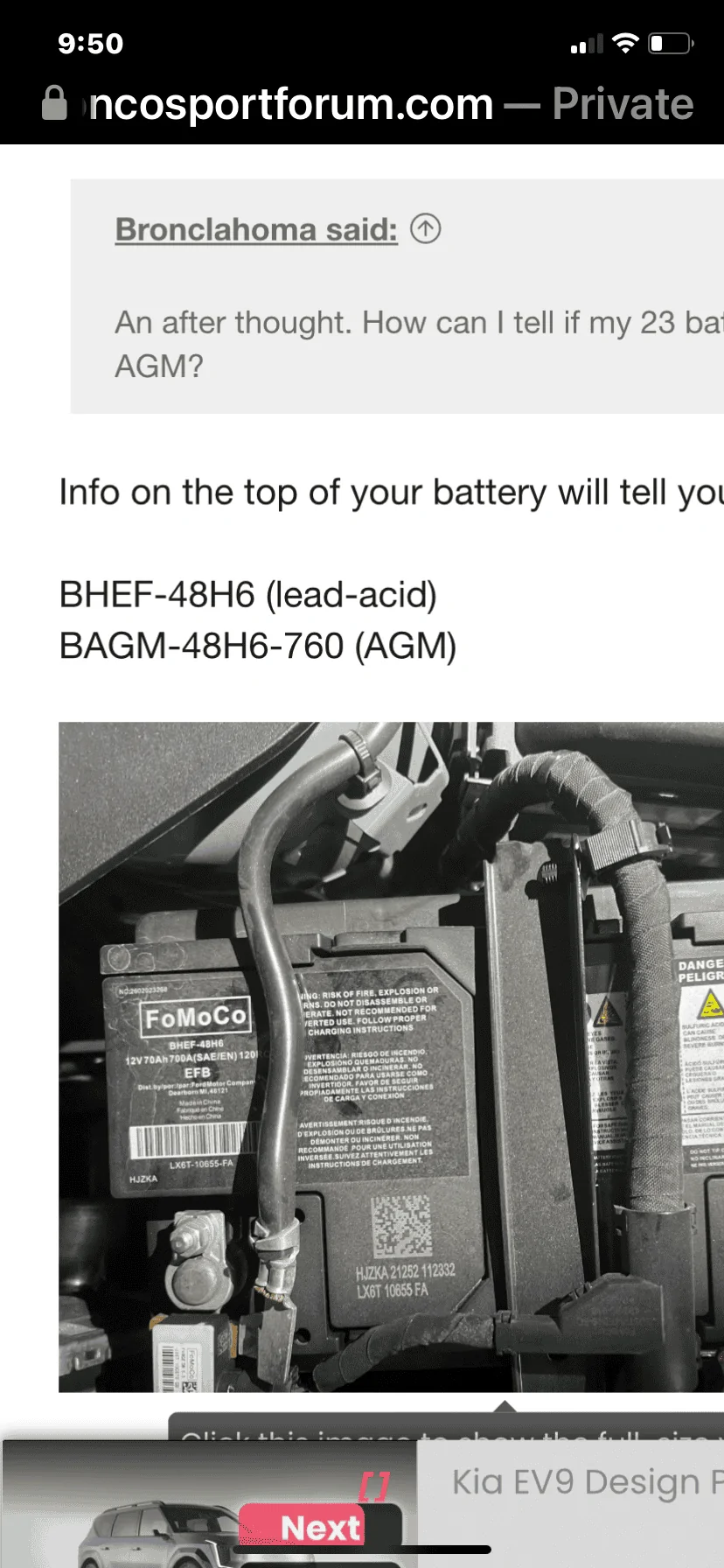

This question is based on zero knowledge of the subject. Could the transmission be moved out of Park with jumper cables or my portable battery charger attached?
1,325
1,288
Battery needs to have juice .
