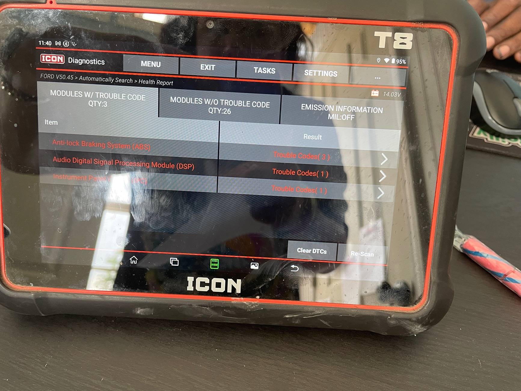

Can anyone tell me exactly what sensors need to be replaced? I do not wanna have to bring my car to the dealership however, the mechanic said he cannot tell what sensors exactly they are. Maybe I’m silly for asking this. I’m clueless when it comes to this stuff lol

If it's still under warranty, take it in for a check up!
What problems are you having or are you just trying out a new tool?

Unfortunately, you will need to trouble shoot to find the 'short'/problem. Start by turning the drive and goat switches (do you use them a lot? Too much? could a switch have gone bad? Or maybe never using the goat mode switch? Maybe just cycling them will help.), alternately, is there a bad connection/s that may have gotten water in them. I have solved some electrical issues just by taking the quick disconnects apart and then back together. And then, sadly, the PCM may have gone bad, shorted? UGH! Good luck in your journey and let us know how it went!

Fortunately or unfortunately depending how you look at it, the best way to have the issue diagnosed is to take your Sport to a dealer, they have the software that can talk to whatever modules are involved with the codes you see, to find out whats causing the problem, otherwise you're just guessing.
In the mean time, does your battery currently have a low state of charge?
Have you or anyone spilled any liquid around the drive mode selector switches?
Have you tried resetting the code to see if it comes back.
There have been a few here that have had the mode switch go bad and had to replace it.
Someone even had an issue when a hair scrunchy worked its way under the shifter dial.
