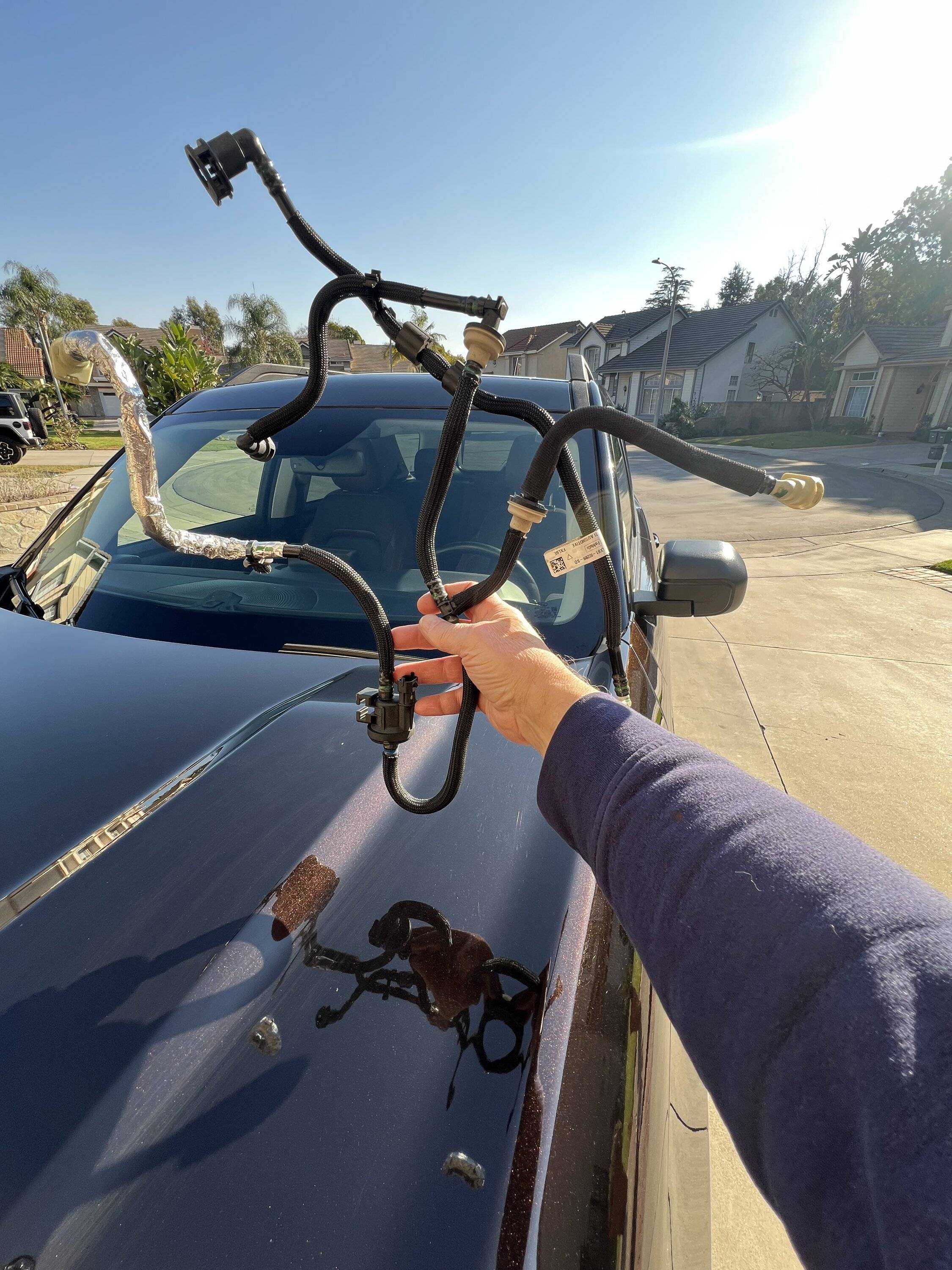

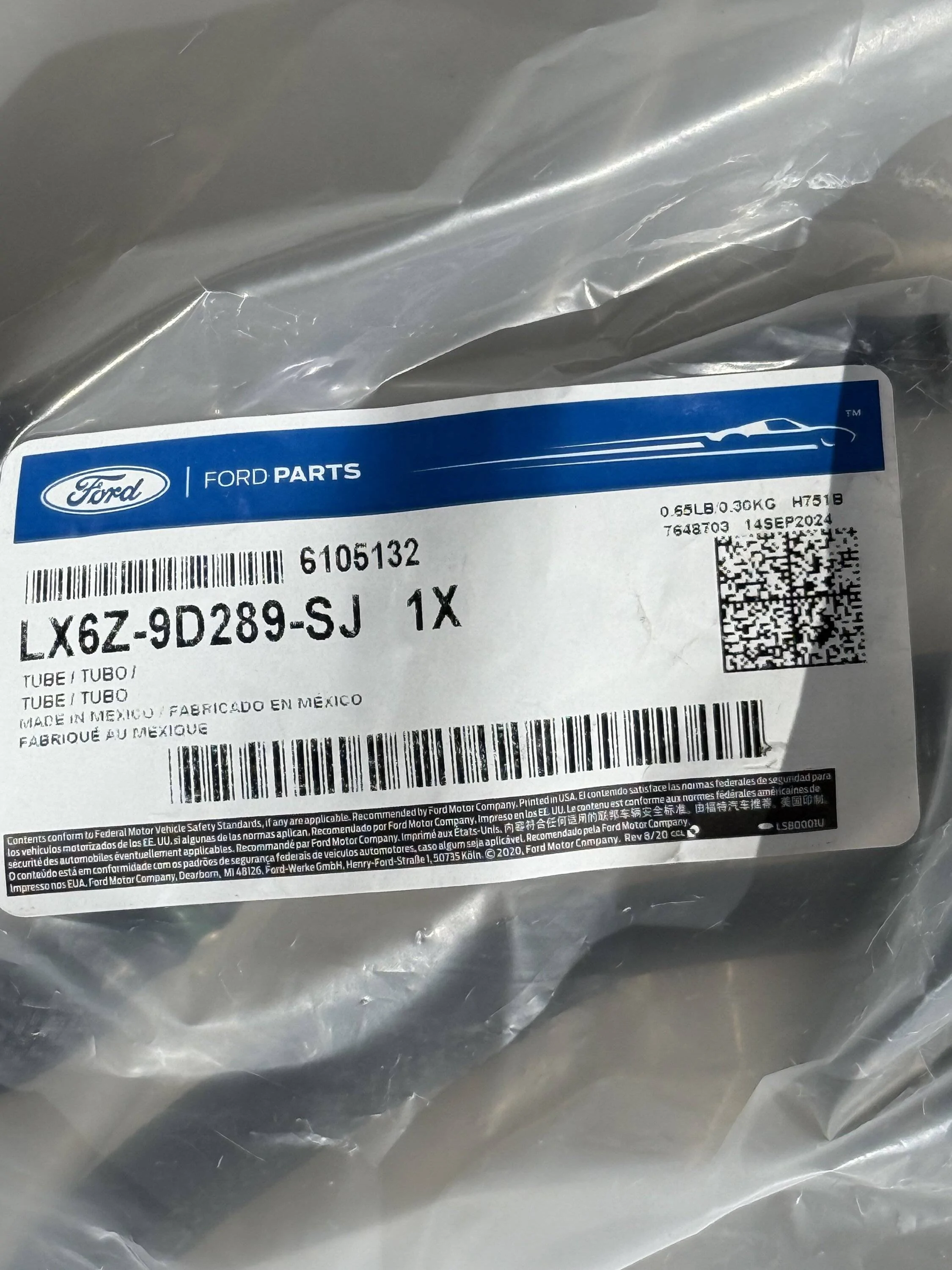

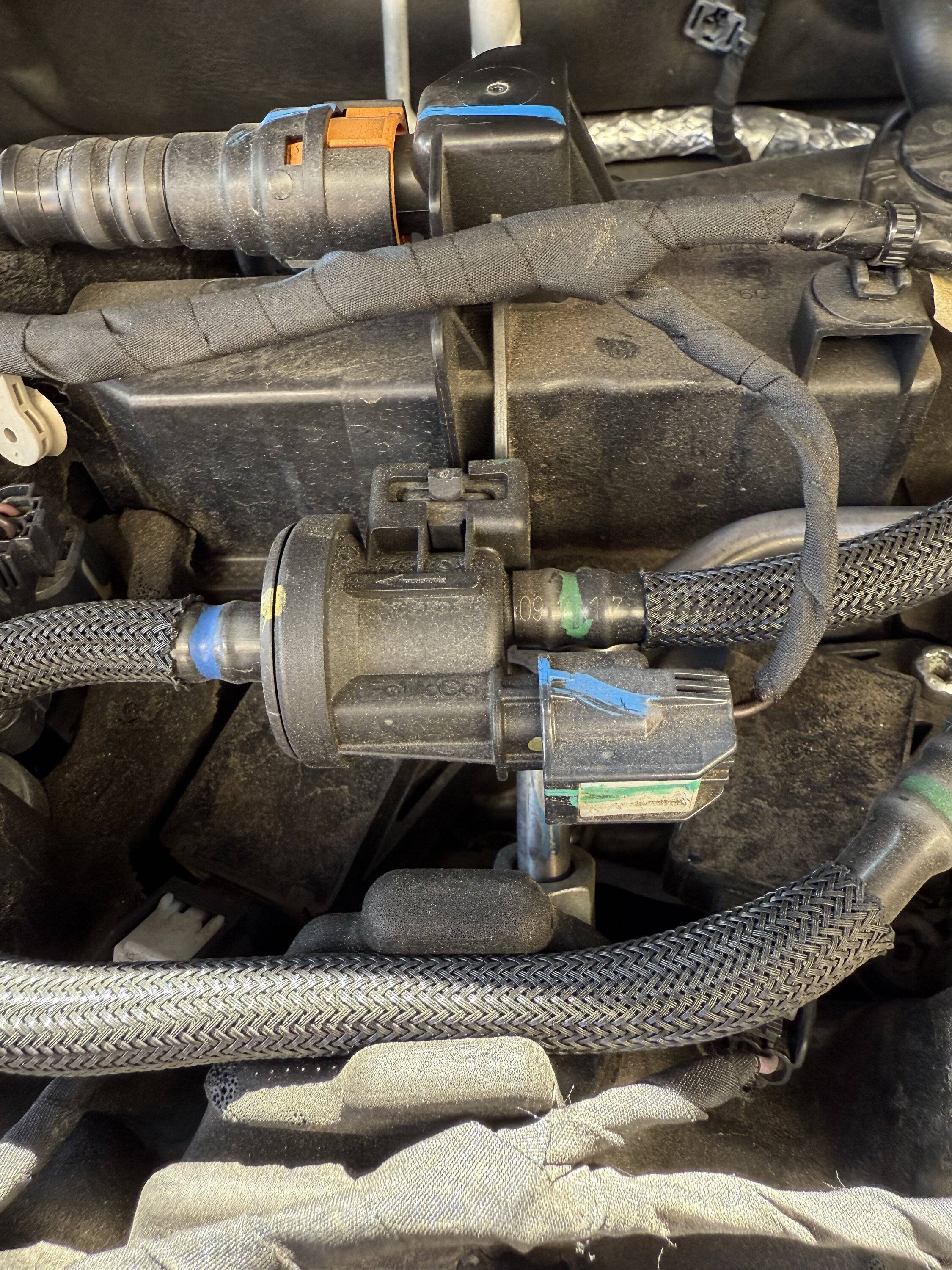

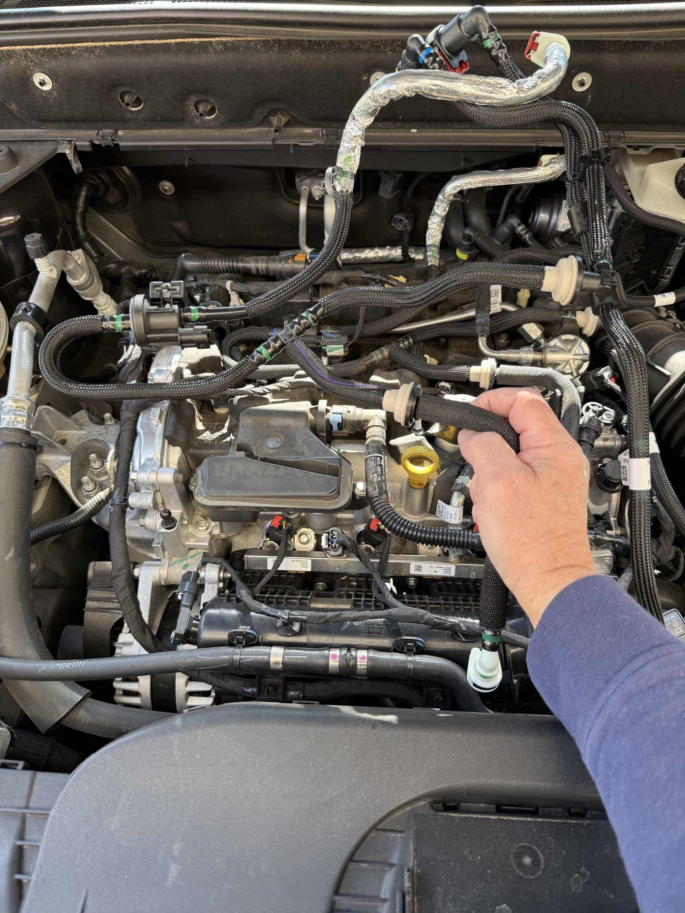

I have been encountering a MIL (Check Engine Light) with a P0496 code. I had the dealer replace the EVAP purge valve assembly 2-1/2 years ago. Along with the MIL, after filling the fuel tank it has been very hard to start.
I ordered a new EVAP purge valve assembly and replaced it this weekend. If you have been wondering what all the tubing on the top of the engine is for, it is the EVAP purge valve assembly.
This was an easy 15 minute replacement.
