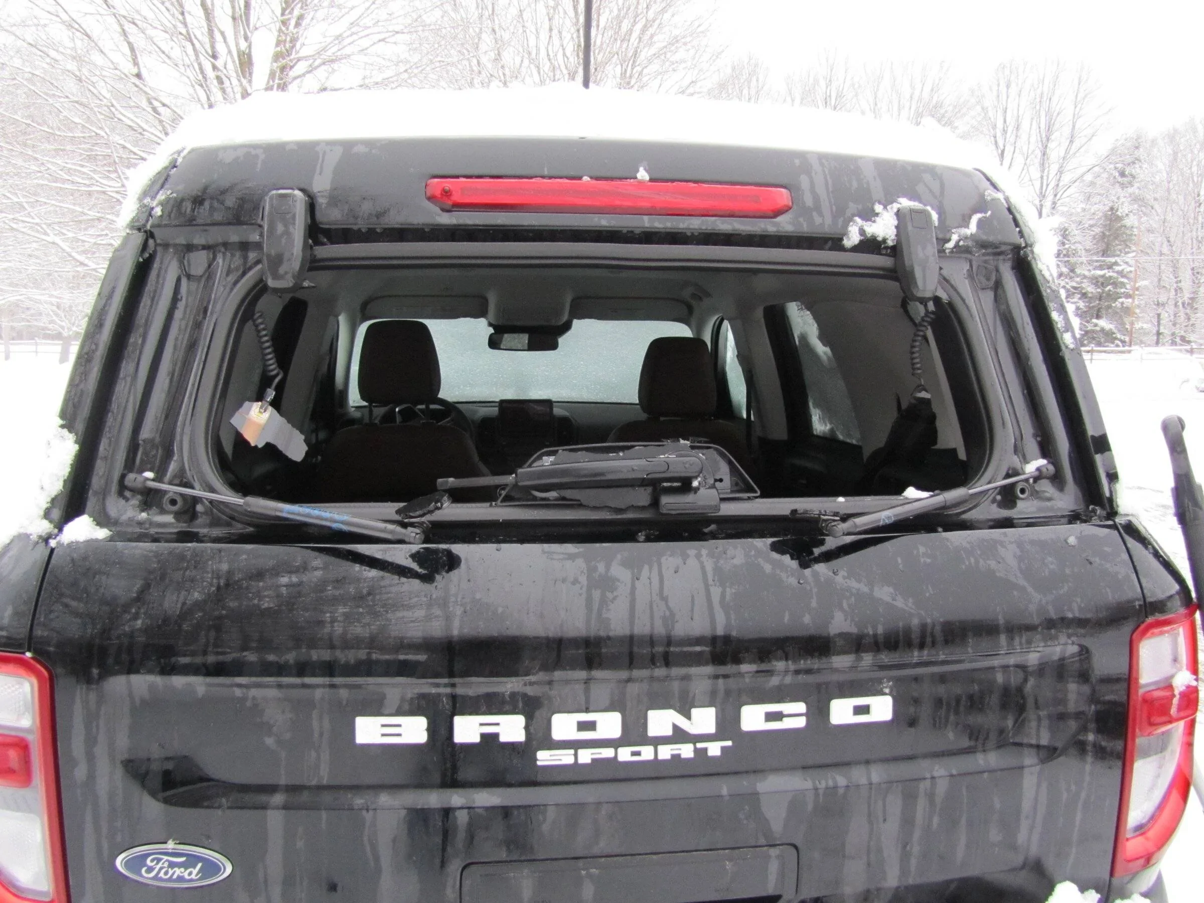

Last week we had a snow, I used the remote start on my Outerbanks and then started out to clean it off. The back window completely blew out of the bronco, and it made one heck of a mess. The dealer now has it. Insurance company said they have heard it happen before, the rear defroster overheats and the cold makes it shatter. Of course the part is not readily available.;;

That is physics at work. Cold glass and high heat. Boom
When heated glass expands If this heating is on one side and too rapid to allow it to soak through to the cold side, the hot size grows and the cold side does not. This causes stress in the glass causing it to try to bend and if excessive will cause the glass to crack.
There are problems the other direction also…..One time I had one of those cooking glass bowls that were “shatterproof” until I took a hot one and put cold water on it causing again a physics type reaction to take place in the other direction. The glass exploded in my hand.
Front windshield also can experience an issue due to defrosters… get expanding cracks etc due to the cold/heat issue.
There is always a chance there was a small unseen defect in the glass that caused the catastrophic end to your rear glass when physics took over.

I don't know...I'd tend to believe if heat was the culprit, it was the cabin air temp, not the defroster? I have seen disaster happen to the windshield with a high front defroster setting. Granted, you don't have hot air blowing on the back glass, but maybe if you're setting the heater high enough it might affect the back glass? I just don't think the electric defroster gets that hot -- and while in contact with the glass, wouldn't it heat quicker and more evenly?

There have been complaints regarding panoramic roof glass "exploding" while people are driving, without big temperature swings or obvious impacts. Ford is one of many manufacturers mentioned, so heat/cold explanation above would make sense if there were a defect.
