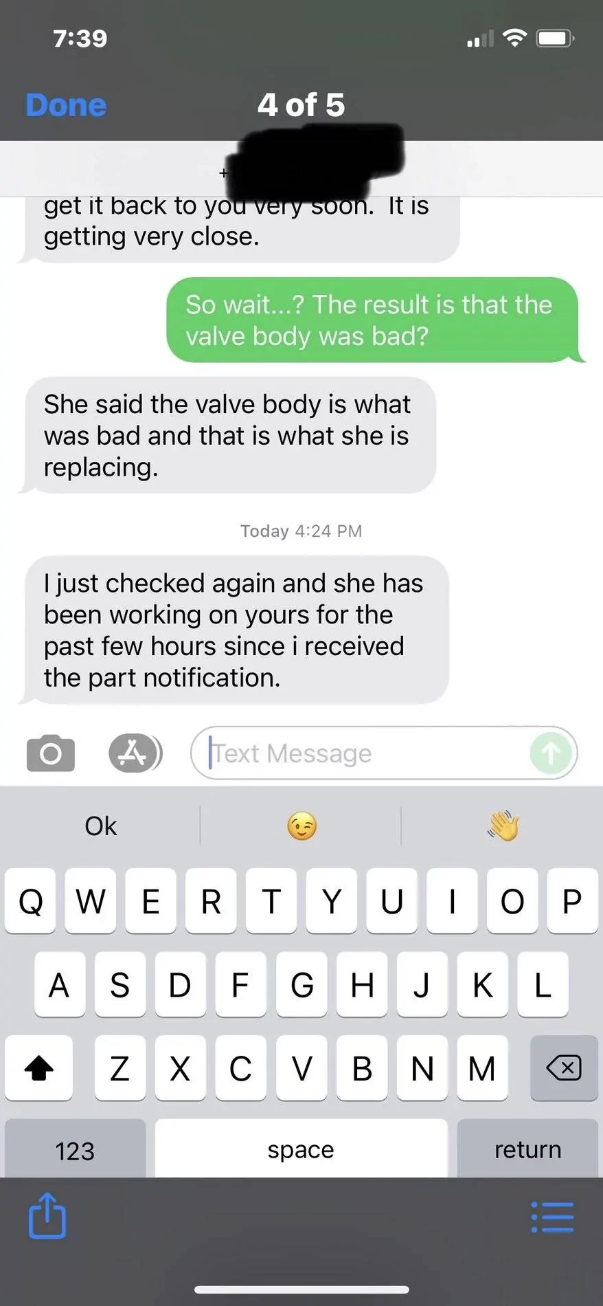

Thank you!! She got this response at the end of the day. I am hopeful we can get it back by the end of the week.
I’m not sure if it is better that the valve body was bad and not the transmission, or visa versa. I am also very interested to see what they can tell us, as far as a cause.
From the little searching I have done so far, I have read valve body’s are a common component that fails.
What also concerns me is, whether the transmission was damaged as well, and are they just throwing a bandaid on it for us to have future issues..??

They said it was the valve body. I think he told her they want to drive it a little to make sure it is good to go. She will probably talk to him today. Ironically, I will be there Friday morning to drop off a work vehicle. Hopefully we get it back before the.
