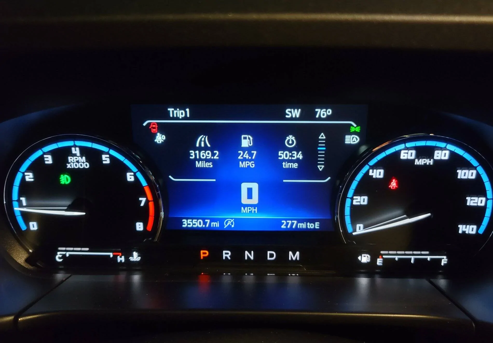

The speedo on my bronco is in the lower right of the screen. I would prefer it centered like the one in the picture. I can't figure out how to do it and the salesman doesn't know either. A little help would be greatly appreciated. Thank you.

What version of the Bronco Sport do you have? There are two different center screens, depending on the trim level. Outer Banks and Badlands have 6.5 inch screen in the instrument cluster. The Base and Big Bend have a 4.2 inch screen.

Badlands 6.5 inch screen.

On your wheel, to the right is OK and directional arrows. Hit
MENU
SELECT SCREENS (depress OK)
scroll up and down and you should have
CALM SCREEN
Calm screen should center your speedometer.
NOW PLAYING also does with the radio selection above it.

Once you have I believe up to five or seven options selected, go back to the main screen. The next time you start up your vehicle you just use the OK toggle up or down to change screens. It will toggle through the options you selected. The one in your photo is for Trip settings

It goes over to the lower right when the cruise and speed system is active. When you turn of cruise (x button) the speed readout goes back to the middle.
