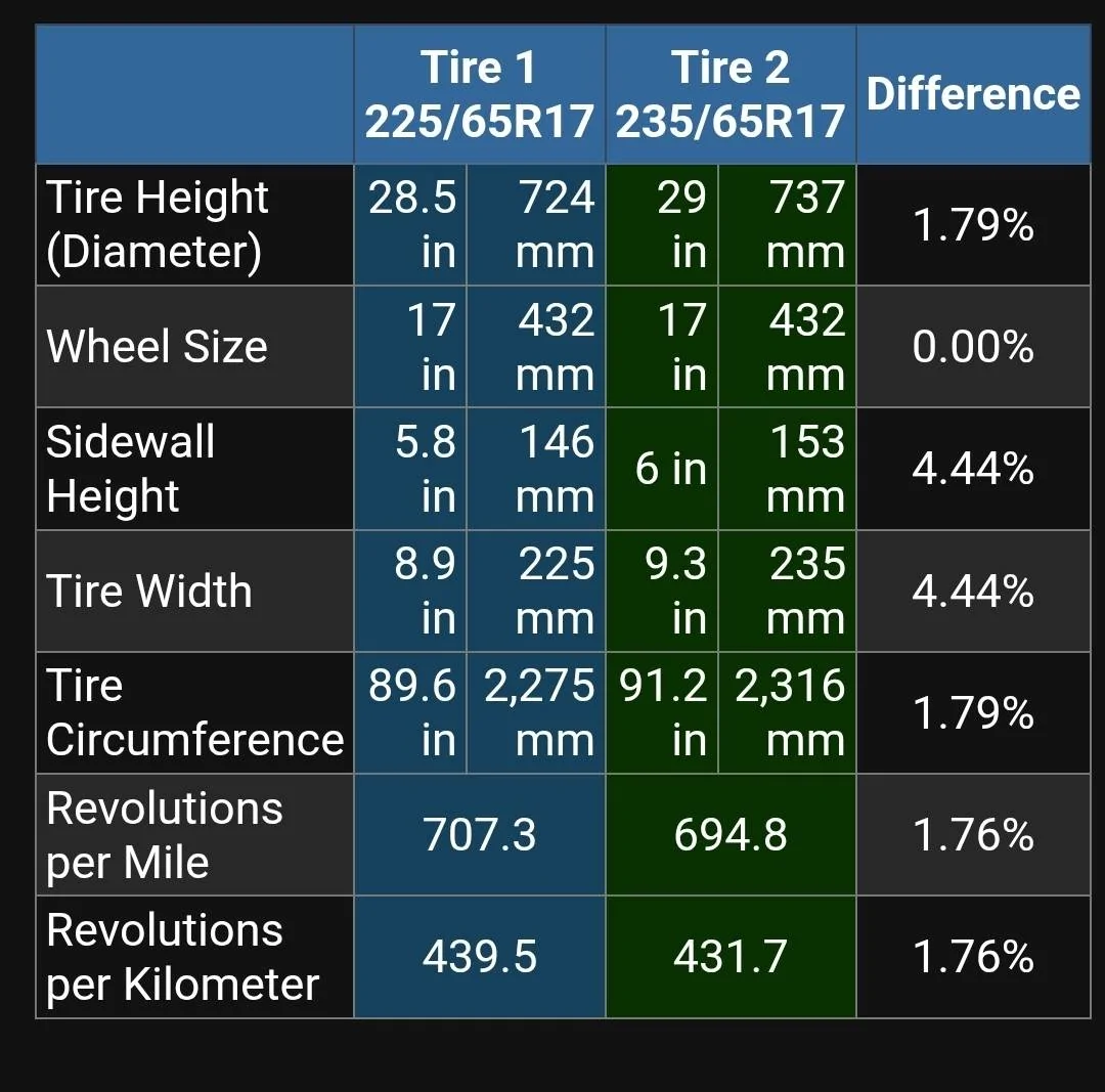

Ford Bronco Sport Bronco Sport Badlands AWD Explained Screenshot_20250520_163043_Brav
Not sure if 1.79% goes into the system tolerance or it is enough to make the AWD system freak-out
CancunBadlands
CancunBadlands
Feb 25, 2024
190
249
Cancun, MX
I believe it does, +-3% is the rule
TY pal
